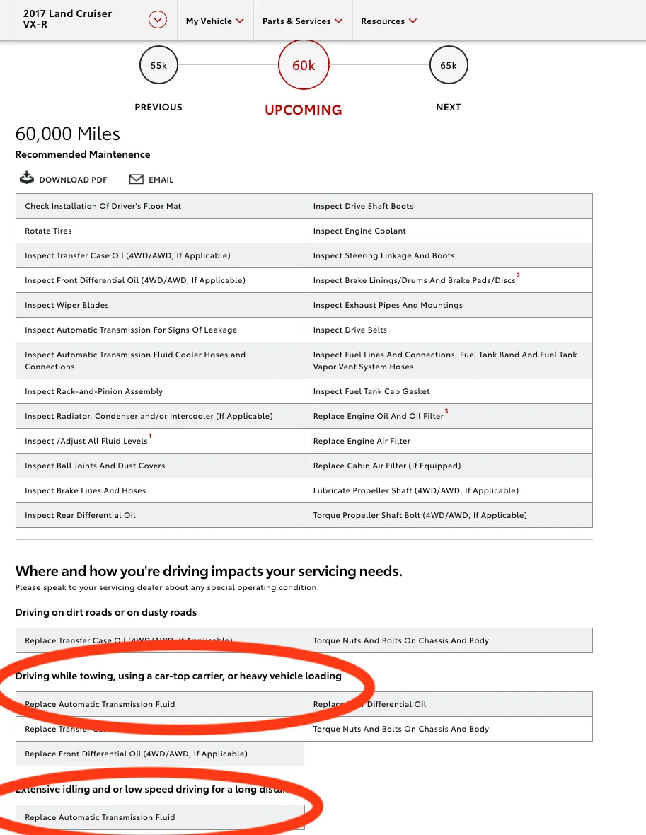

this got me curious ... Toyota calls for ATF Replacement in some cases @ 60k and there after every 60k from what I can find. Heavy Vehicle loading would encompass a lot of the trucks here.
I did mine just as part of what I consider prudent maintenance on the truck.. I also do the diffs and transfer case every 50k. The diffs I'll probably switch over to yearly since I am nearing 100k miles.
Correct. Replacement in that case though means draining and re-filling the pan, which is about 1/4 the total fluid
