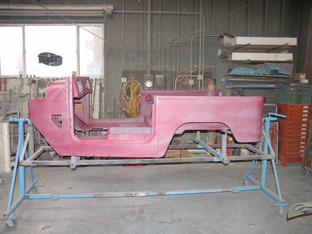

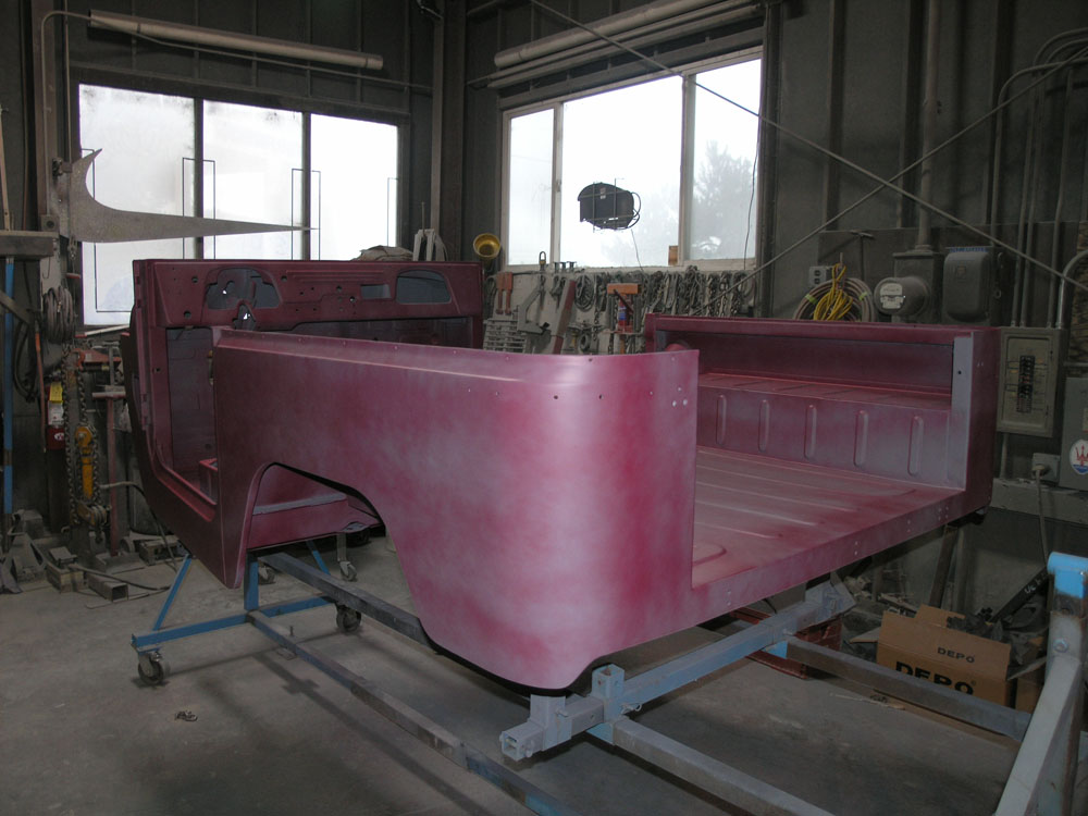

Destin...did they give you a hard time about the side needing to be pulled in? Do you know if they just yanked it over hard, or if they tried to heat a few areas up to try and help ease it over? Did you take a measuring tape to see if the sides are even from the door openings to the back corner? ...this shouldn't be too important I don't think, but it would be interesting to note none the less.
Destin, just by pointing out the problem out to the body shop they fixed it, I think they will do a top notch job. In my rebuild of my FJ25 on this list, check out John Pardi _Pardion post #52, I do not know how to cut and paste the photo. You will see the tailgate spacer/jig that Peter was talking about that I use when replacing rear sill and welding the tub back togerther square. This is just to clarify what the previous 2 repairs could have done to keep the tub square. P/s the left latch tailgate handle is bent. Later, John
Destin, I would seriously test fit everything...doors, bows, seats...etc. Sounds like a pain, but again, one afternoon of good work on your part can save you a few weeks of added aggravation...my 0.02 :cheers:

Don't just measure the doors...dry fit all parts...like both the drivers and passenger's doors, cause as you can see with the back end...it looked great till you put the tail gate on.

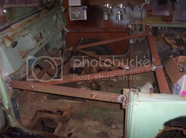

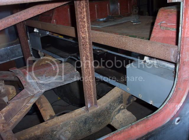

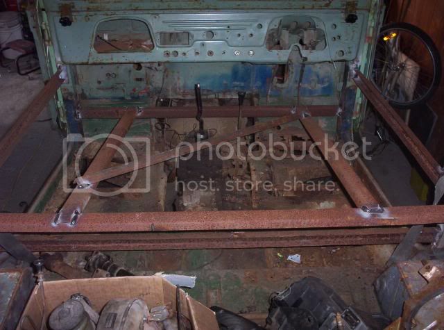

...I just looked in my files for some pics I had saved on just how much "rigging" is needed to ensure a square tub. Not just left to right, but front to back, and quite a few "X"'s tacked in for good measure...freaken thing will look like a spiderweb! Does anyone have any such photos? I think they are on my old computer :frown:
Heres some pics of the bracing i put into my tub before i started cutting it up. still needed a few tweaks along the way to get panels fitting correctly.
I used this bracing to run other braces off when i was doing different sections just so nothing moved. eg

Na...should be all good. We are not, or at least I am not trying to scare you, but I have personally see how "out of shape" a tub can get if parts are welded on with out enough bracing, or mocking up...was too late once painted, hence the reason to fit the doors on just to make sure...better find out now if anything needs a little help.
