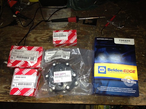

BeBe runs pretty well as she stands right now but the dieseling issue has never gone away. Now that I was able to fix the Carb Fan the hot start issue is gone but this week I ordered a full tune-up kit from Georg @ Valley Hybrid.
The kit I got from him has the following:
- OEM Spark Plugs
- OEM Fuel Filter
- OEM Distributor Cap
- OEM Rotor
On his recommendation I picked up the NAPA Premium Spark Plug Wires this afternoon as he said that the OEM wires were super expensive ($80) and not needed.

So just walked in the door and this is waiting for me this weekend... Getting a bit tense...:crybaby::bang::wrench::wrench:
Untitled by renofizz, on Flickr

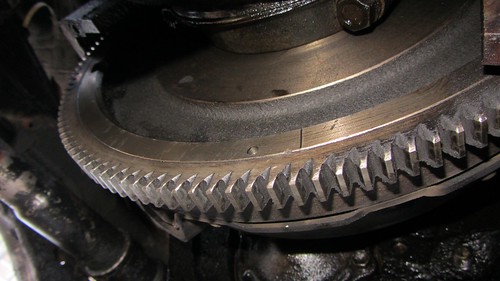

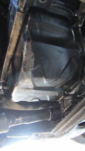

Ok so for those that are unsure this is the inspection cover... I originally thought that this was part of the transmission and thus if I removed the bolts (you can see one is busted in the top right corner) that I would empty the tranny fluid. The bolts are 12mm and like Kline said, there are 7, two of which are actually facing the front of the engine the rest on the underside of the pan.
Once they are all off (I had to use an extension just to get some room on two bolts) this is what you will see
Mine was pretty dirty inside but no real excessive oil, so looks like my rear main is ok.

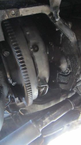

Now if you put the truck in neutral you can grab the flywheel and spin until you find the TDC mark and BB (or mine was missing the BB).

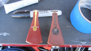

Here is what it will look like. Do yourself a favor and grab some yellow, white, bright colored paint and paint both. If nothing else use some white out and mark them, just mark them and you will be amazed at seeing them later when you attempt to use the timing light.
And here she is... that mark is actually pretty big (I only had a que tip to paint the marks) but looking at it she is retarded to about 2 or 3* at idle.. When I jump her up to about 1k rpm I can barely see the BB in the window which means she is retarded to about 4*. I did this more to just see if my handy work had, well, worked and it did!! Now I am back out to take care of the rest.

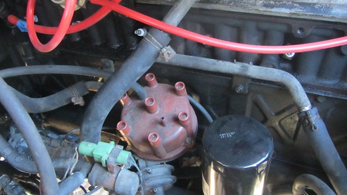

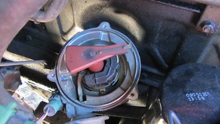

Ok got a new batch of pictures downloading but here is the question... My wires do not say which goes to which? I am assuming that they are all meant for the same thing so I should just be putting the #1 port on the cap to the number #1 cylinder yes?
Also, the cap only went on one way, so what I dont understand is what do you turn to advance/retard the timing?

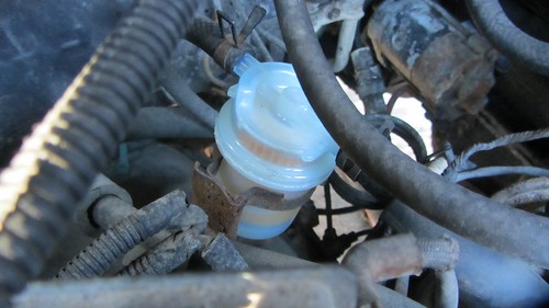

So here is the new fuel filter.
WORD OF ADVICE - be sure to vent your tank prior to pulling the lines off the old one! All you have to do is open the gas cap then go change the filter! LOL

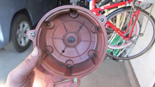

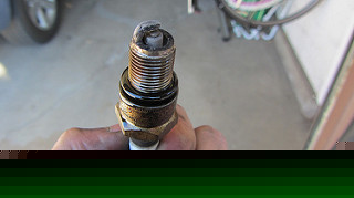

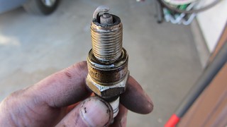

Sad old cap and plugs

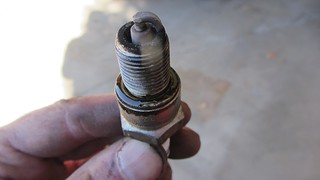

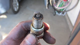

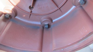

So the number one cylinder plug was fine
But here is #2?

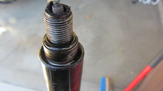

Here is #3
Here is #4
Here is #5
Here is #6 (pretty clean compared to 2-5)
So with the oil on there do I have Blow By going on?
The plugs look good to me, dry and consistent. The oil on the base of the plug could have come from a leaky valve cover gasket?
Plugs look pretty much text-book good.

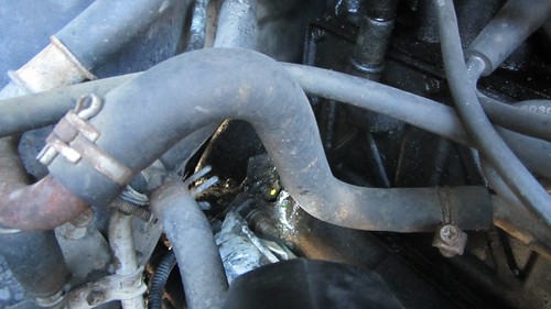

I know Toyota hoses are good, but you might consider swapping out the heater hoses, eventually...
To advance / retard the timing, you need to loosen the bolt into the slot at the base of the dizzy - 'front' side, and then use a flat blade screwdriver to get the dizzy moving, after it's loose you should be able to adjust it by hand while running... be careful around the fan / belts, can be a three hand circus if you are aiming the timing light as well as reading the tachometer and swiveling the dizzy.
HTH
