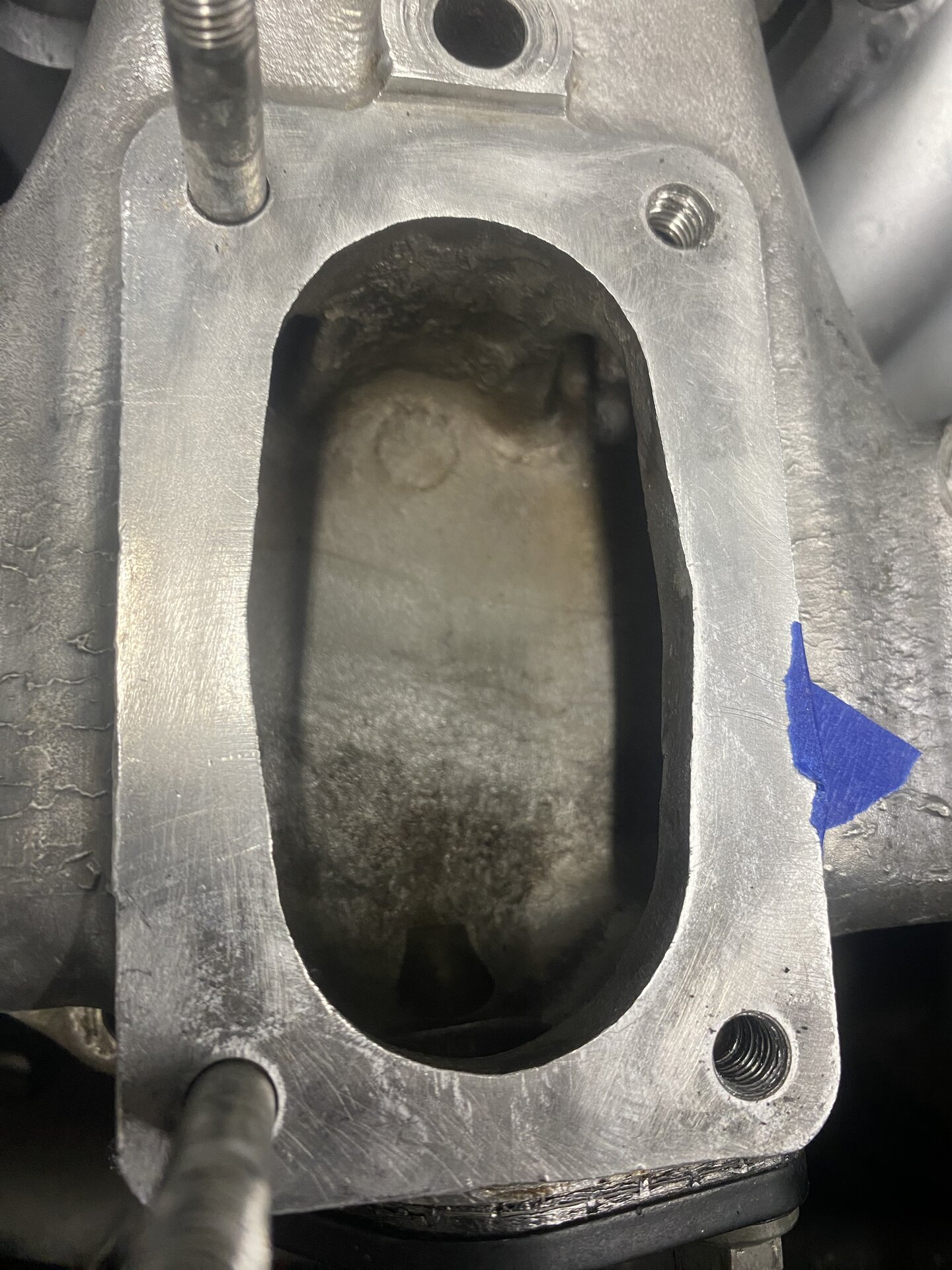

I'm having issues with rough idling, and vacuum leak problems, all related to an aftermarket chinese carb im using. Wish i had rebuilt my Aisin instead but im desmogged and a buddy had this one. can't determine if my 11 hg vacuum reading is becasue of improper tuning or a vacuum leak.
I want to be able to drive it as I no longer have shop space to work on it after this week. I'm hoping a guage can tell me if im harming the vehicle even driving it a 10 mins to work everyday improperly tuned. I have two threads going on the issues Im having, if you care to weigh in.

you probably dont need an afr gauge, sounds like you need a better (or working) carb.
once the carb is working, afr and egt will be a moot point,

Exactly. That egt won’t help with the tuning you are needing. Save money and just buy a new carb.
City racer has one for $325 I’ve heard good things about that Japan made one. . Using a crappy Chinese carb is going to have you chasing your tail.
