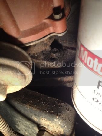

Ok so there are three bolts/screws that hold down the cap, are you talking the one most forward of the engine (i.e. faces the radiator)?
Got everything plugged in and ready to go. She fired right up and at idle, looking with the timing light, she sits the exact same which was to be expected.
Greg I can't find a pic but I'll go outside and take one if you need it. The bolt isn't on the dizzy cap, it is down the distributor, towards the front of the truck close to the engine block. 12mm bolt IIRC, once you loosen it a bit you can rotate the dizzy with one hand while you hold the timing light with the other, just as micruz60 said.

Ah ok... I did see something down there and was wondering if that was what I was looking for.

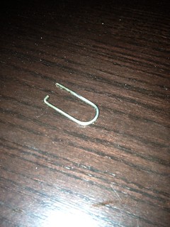

Oh and almost forgot... found this in the bottom of the flywheel inspection pan... Anyone have a clue what it is?
Untitled by renofizz, on Flickr
That's a clip for the throwout bearing. Don't know much about them. But I will in a week or so :)
That's one of the two clips that hold the throwout bearing carrier to the clutch fork.
If it's the bottom one, easy to put back on. If it's the top one, PIA.

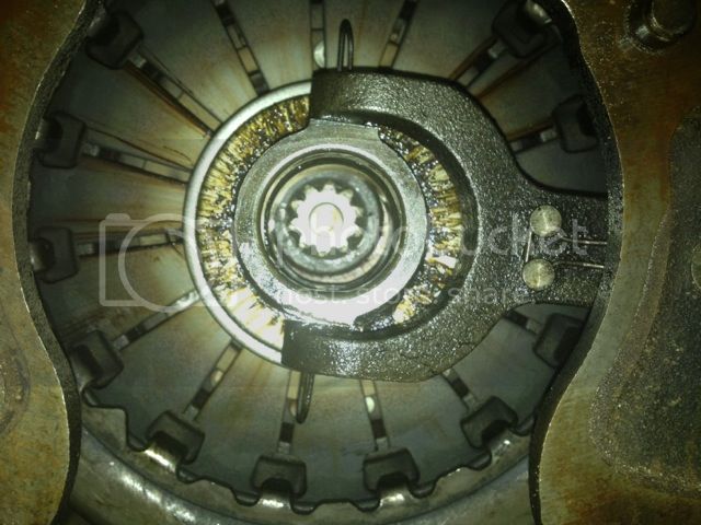

I got some pictures that may help you gregnash
My clutch fork and throwout bearing
Distributor hold down bolt, that thing covered in funk
I have my transmission off right now. These pictures I've taken have helped in a few threads already haha
(throwout bearing is covered with gear oil (heck everything is inside the bellhousing) which is why the transmission is out :) )
Thanks for the pic Kline, that is exactly what SRF was describing and what I figured was there after I saw it this afternoon.
For the throwout bearing, yeah dropping the tranny for me ain't going to happen. What in your picture is the throw out bearing so I can see tomorrow if I can get my man hands in there and push the bugger back in place.
No problem. Yeah it will be tight if it is the top clip that fell off, but you should be able to get it.
The "U" shaped clip would be one of these. Hopefully the one on the bottom.
Well got the tach out, the timing light and found the bolt with Kline's pictures help. I was even able to get my mixture screw to turn out a couple more turns that were sorely needed. She is now dead on at 7* and idles nicely at abou 750rpm. Man she does drive differently that is for sure.
