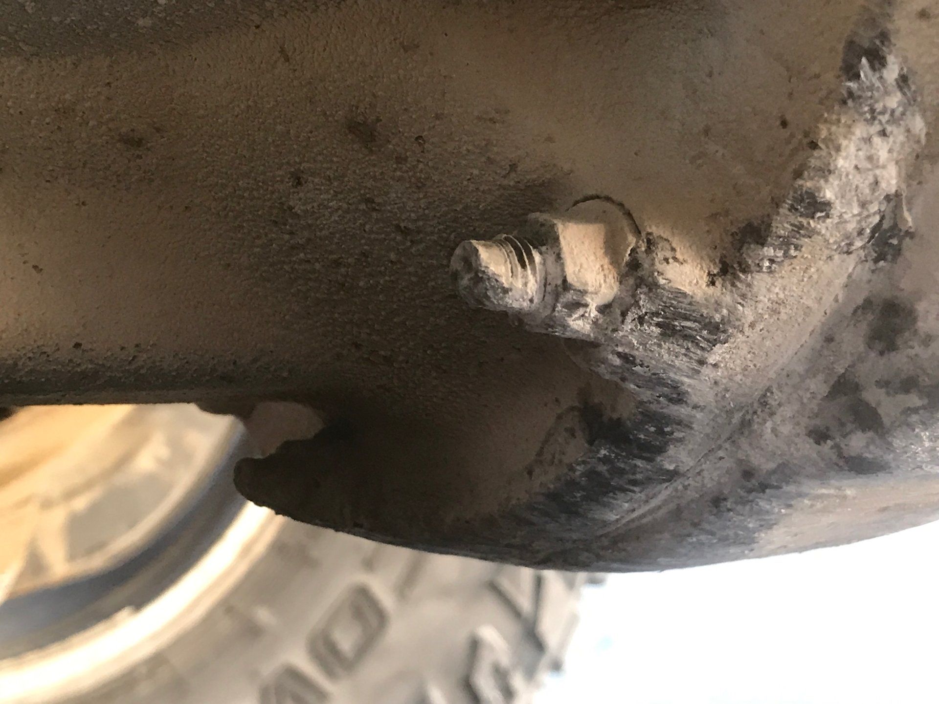

How is it that grinding on them isn’t recommended for tie rod clearance, because it would compromise the structural integrity of the design, but dragging them across rocks is “looking good”?
I ask because with heavy use, it’s only a matter of time before the welds on the bottom have been compromised, no?

Your sarcasm aside, it was a serious question. Rocks remove material; this didn’t just magically happen, so what makes you think your radius arms will stand up better?

The weld seam runs deeper than would be assumed until seeing this photo courtesy of DVS. This shows that quite a bit of the entire 1” thick arm would need to be ground away on rocks before integrity is compromised.
I have no major concerns about strength and/or wearing these out on rocks but I am concerned about tie rod clearance and have said so since I first installed delta arms.
I believe these arms will work great for the vast majority of 80 owners but for those of us who do run rocks, who don’t really want a three link and who have taken steps to get maximum travel from the 80 series front suspension, an arm that is still narrow enough to allow for greater bushing deflection before the arm binds and much greater tie rod clearance would be appreciated.

Unfortunately, we can't design, build, and sell something that helps 3% of the 80 market and keep it cost effective for the 97% of the market that is actually purchasing our products. If somebody is wheeling hard enough to wear their stuff out, they should be paying attention to wear of a lot more than just the radius arms, and replacing things as needed. Aside from that, we stand behind our products and do everything we can to make sure our customers are happy with their purchase (just ask them). If somebody actually wears out their arms, there is a good chance we will be replacing them at a significantly reduced cost. We would also take the info learned into account and possibly change the design.
