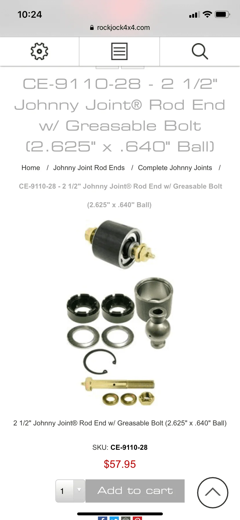

What about Johnny Joints like this?
My issue is my friends budget built XJ just outflexed me on a ATI ramp last weekend so I need to get the most amount of flex I can without going linked. Im running 4” lift with caster plates on my HDJ81

Is your only goal here to out flex your buddies Jeep? If it were me, I would invite my buddy to go on a nice long remote trip over rough terrain, and then see who is complaining by the end of the 2nd or 3rd day of hard driving...my guess is you will take home the win there.

I am running a slinky suspension paired with delta arms and the articulation of that setup is really nice. I do beleive the delta arms allow for more movement before binding than the stock arms due to the narrower profile. Checkout @Box Rocket threads or his instagram for a ton of pics of how these trucks can flex when setup right.

Long story short is we looked into it and decided against it. We can do custom setups, but those start out at least double the cost.
Pretty confident the arms themselves and the bushings are NOT the limiting factor, more the radius arms style suspension itself that creates the flex issues. You just can’t make 4 fixed points of contact in close proximity to one another move that much. Using a forklift on the front tire and holding rear tire down, have flexed the ever loving he’ll out of a rig and basically taken bushings to zero thickness of rubber on the axle side. Chassis side looks totally fine in that situation.

I have used Trail Tailor rear control arms with Johnny Joints. They are very nice arms and the joints eliminate any binding that may occur when flexed. From my experience rear flex is limited by just a few things if you keep the stock link locations. Poly bushings just won't flex like OEM rubber or something like a Johnny Joint. If you have poly bushings in the rear, ditch em. I am now using Blackhawk rear control arms that use OEM Rubber bushings and they flex equally as well as the TT arms with Johnny Joints did, and the ride is a bit smoother with the rubber bushings. Shock length can limit rear flex too. Tires contacting the body along with bumpstop setup is the other limiter. Trimming fenders to eliminate tires rubbing and setting bumpstops to use the maximum compression and extension of what the shocks will allow should be the target. Proper length shocks will help maximize the potential. Of course all of this only applies if you are keeping the radius arm and stock rear link setup. If you want to go full custom linked suspension, then the principles still apply but the execution changes.
