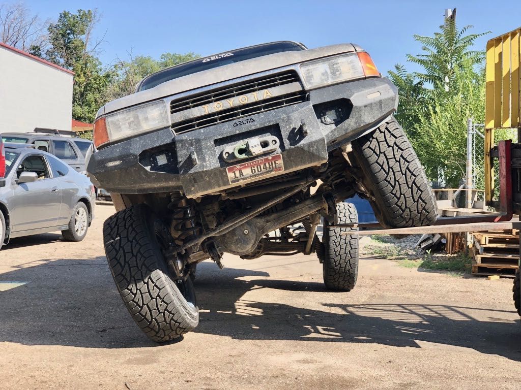

Have 1 set of 4” and 1 set of 6” in the shop now for testing/flexing. Will be reporting back late next week or so.

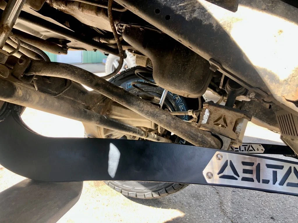

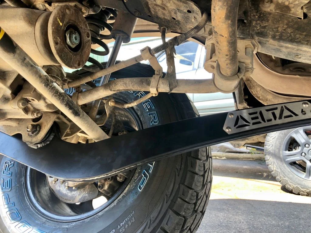

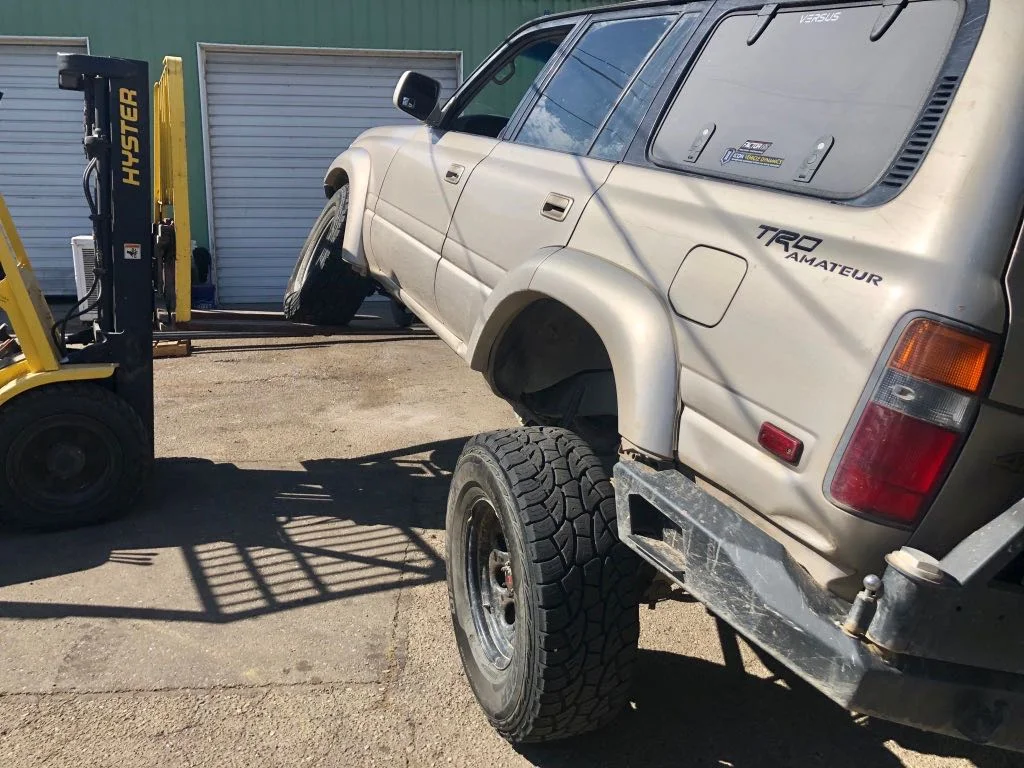

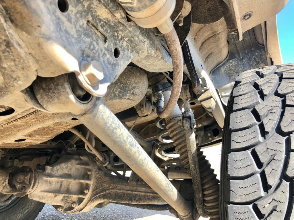

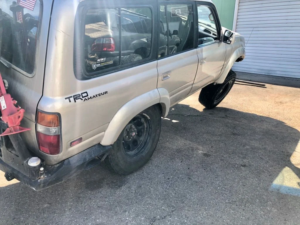

Aaaaand here we have it. 6" HC arms have been caster checked and tested for fit during flex (via forklift to the point of driver rear tire off the ground). More than enough room between tie rod and arms. See pics below.
As you can see, the passenger side is the closer of the two, but still has PLENTY of room. 4th pic shows the rear could be flexed a little more, but not a whole lot (will post a pic of how stuffed rear passenger tire is in next post). Any way about it, rear swaybar is forcing front to flex a bit more than it would if rear could flex more.

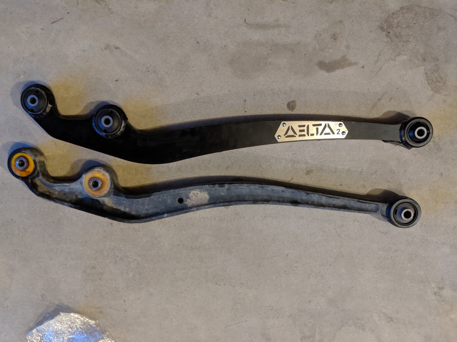

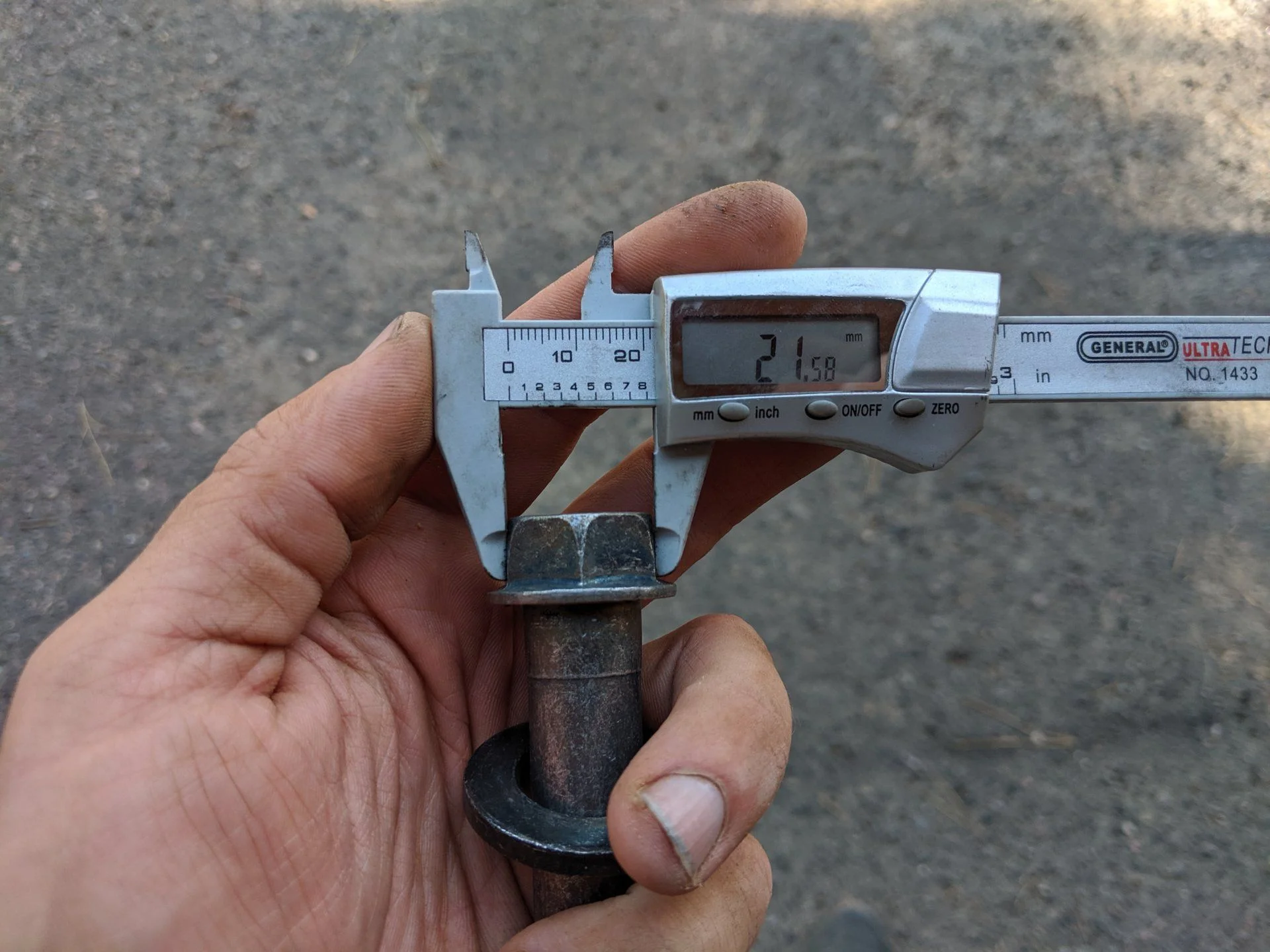

I installed these a few days ago. I got the 2" arms for my OME 2.5" heavy lift. I already had OME caster correction bushings but my caster was still almost zero. I installed these with Toyota bushings, and it did make an improvement. Not a night and day improvement like some people have said (probably with larger lifts) but it does feel better in the corners and tracks straighter. I haven't gotten the caster checked yet.
For the install, I did need to use a ratchet strap (between the frame and the axle) and floor jack (below the control arm) to line up the holes. It was actually pretty easy using both of those.
Also, unless I am crazy, the chassis side bolt head is definitely 22mm, not 24. This was the case on the bolt I took out and the Delta supplied replacement. So you don't need a 24mm wrench for this job, just a 24mm socket for the nut. @Delta VS you might want to update your instructions.
Noted, thank you!
