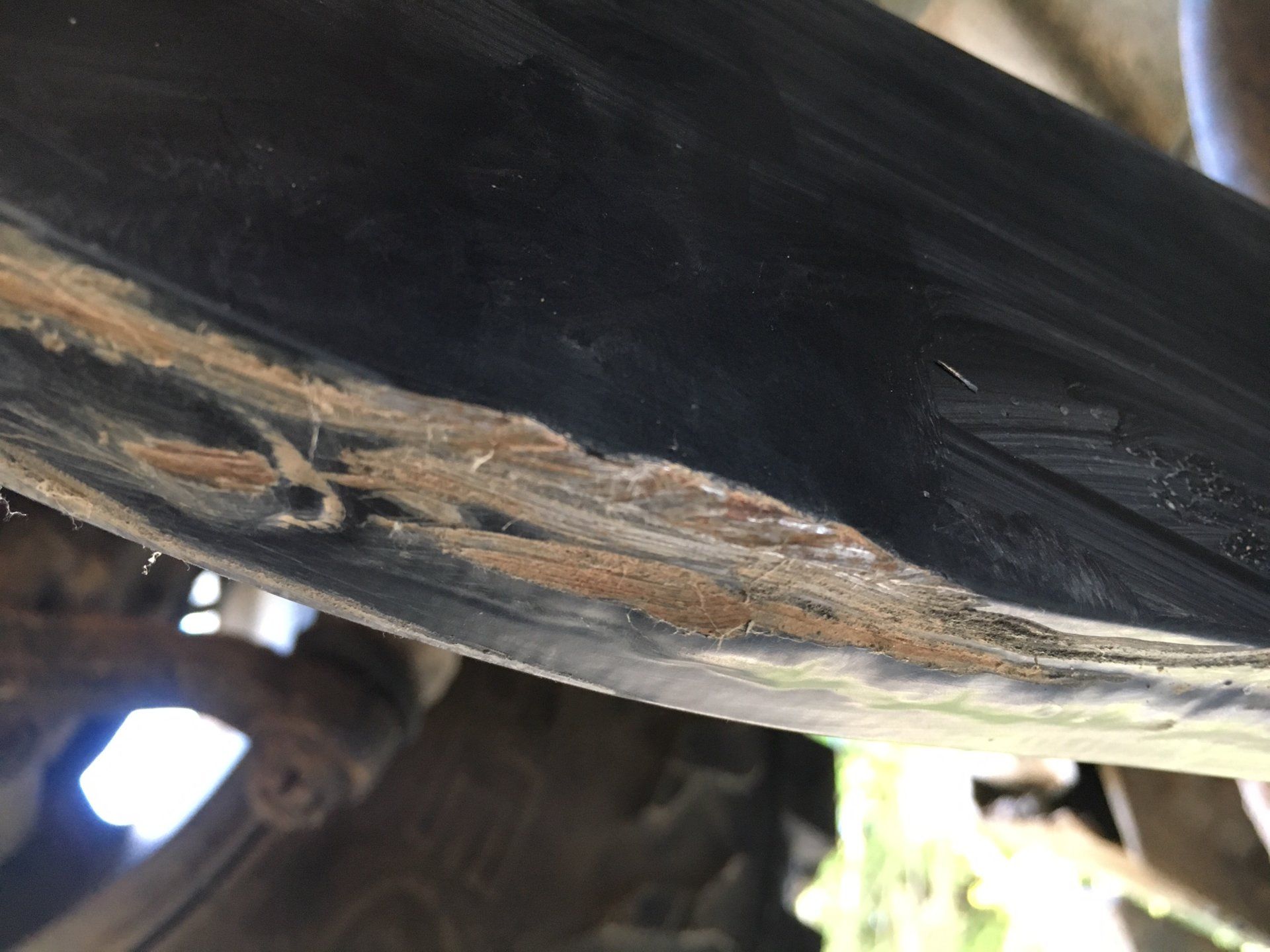

I have bashed these arms around on/in rocks enough now to feel I can give some feedback on how they are holding up for anyone that was wondering. Overall I have no complaints so far. Only real wear is rubbing through the powdercoat which is to be expected and some minor gashes. And yes I make slight contact still on the arms as previously mentioned and the marlin guard as shown.

Looking good! Thanks for the report.

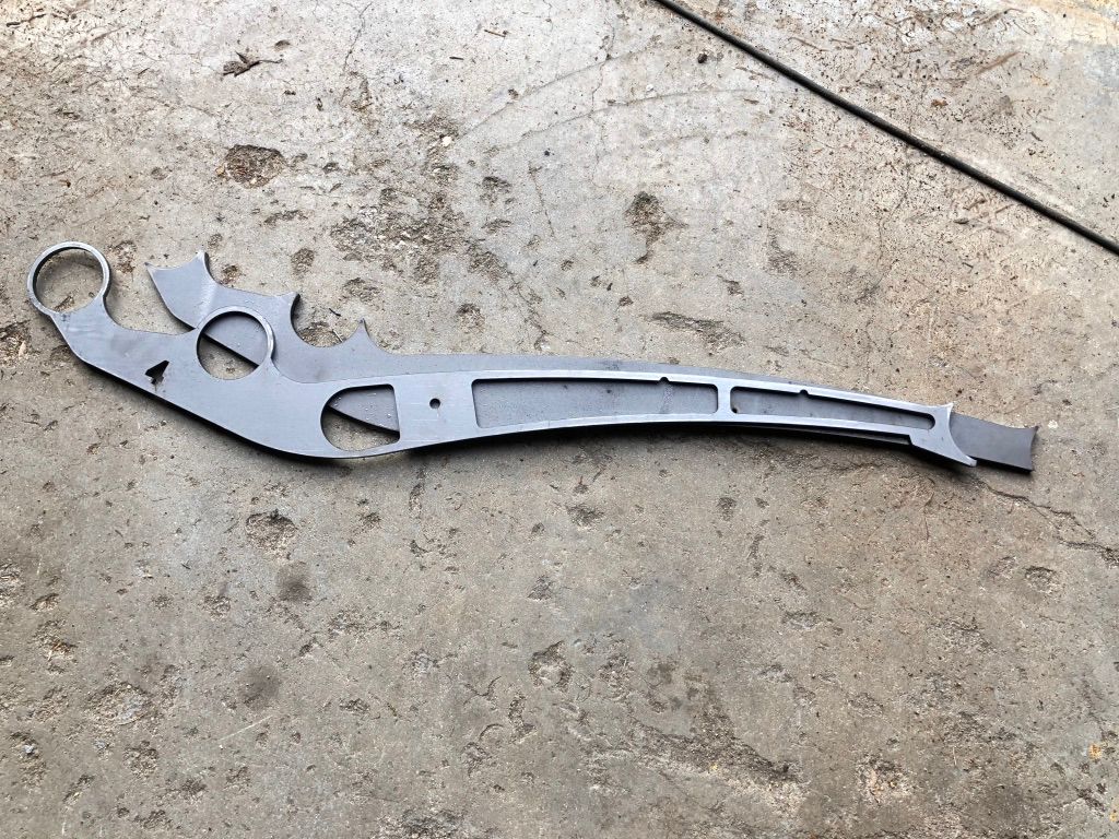

Few things:
1. after much debate, we have decided to ADD a "High Clearance" option to the radius arms. More details on that as they are available.
2. The pic below shows 2 of the 3 pieces (the one on the ground is used on each side) each arm consists of:

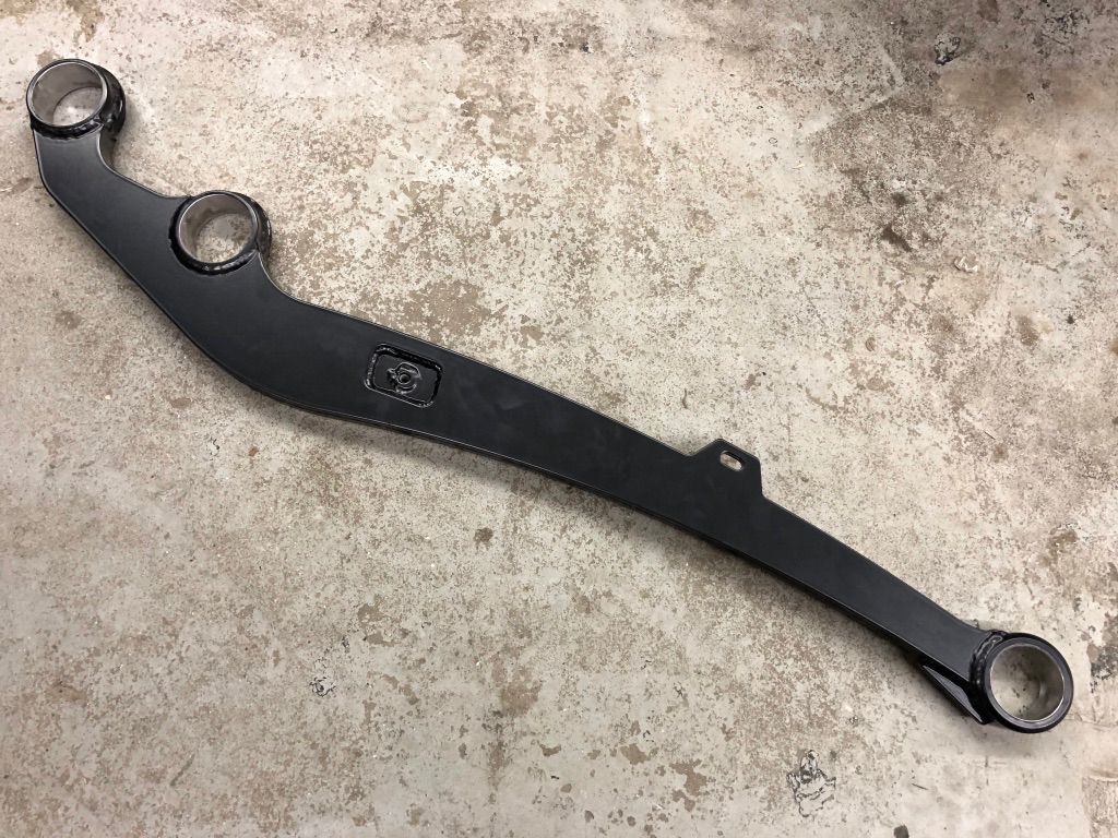

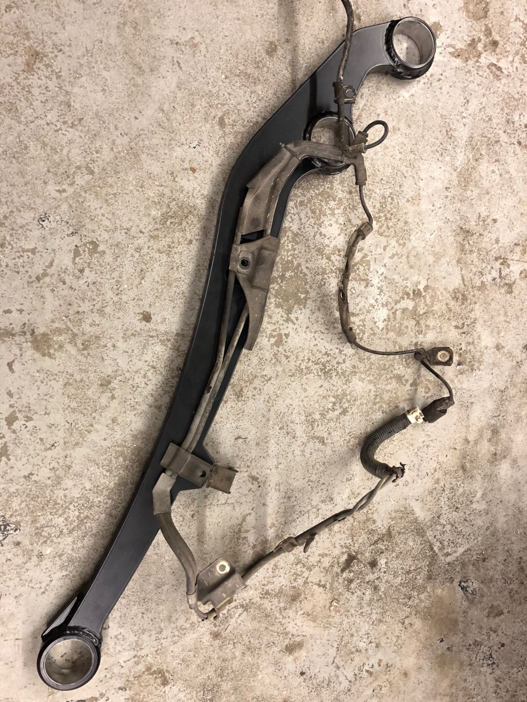

3. Haven't really mentioned it before, but those of you with 93/94 know about it. There is an ABS wiring harness that goes down the left radius arm that needs to bolt to the arm. We have a special version for that (you have to choose year when ordering on the site, that's how we determine), see tab and extra threaded hole below:
How is it that grinding on them isn’t recommended for tie rod clearance, because it would compromise the structural integrity of the design, but dragging them across rocks is “looking good”?
I ask because with heavy use, it’s only a matter of time before the welds on the bottom have been compromised, no?
