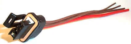

It's a miracle that its charging..... the red wire on the plug, that's been cut, needs to go to the batt. terminal on the back of the alternator along with the voltage supply wire..... the next wire down on the plug, needs key-on voltage only to energize it.... the other 2 are just Gm applications like idiot light and volt- meter.....
the stock lead was hooked up to the back of the alt at the post, along with a mega battery cable ran directly to the + battery post.
now with the adapter plug, i used this information.
http://www.alternatorparts.com/cs130_sbpage2.htm
the only other two wires needed are the "L" terminal connected to the charge indicator bulb, and the "I, or IG" plug, which is the stock number of hookups on the nippondenso unit.
i left the stock plug intact and used blade connectors at the end of the adapter's wires to make sure everything worked ok before i started making permanent mods.
here's a link to the pulley that was needed and a pic of the harness.
http://store.alternatorparts.com/index.asp?PageAction=VIEWPROD&ProdID=505

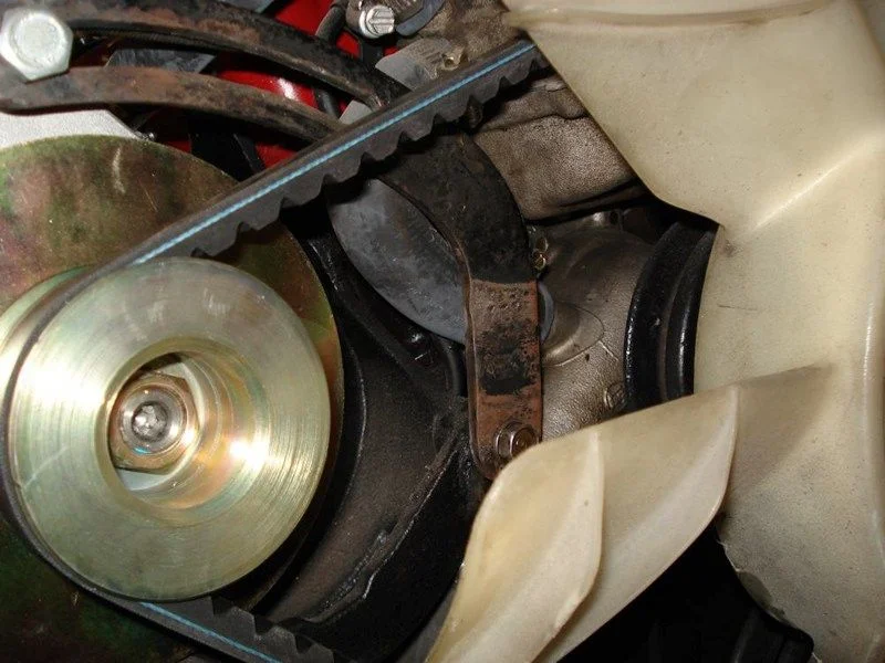

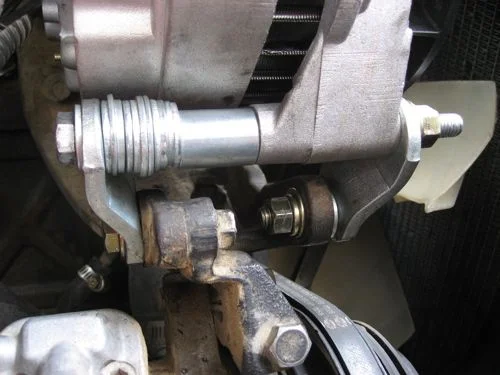

For those of you that are interested..... the cs130 makes for a better and cleaner conversion..... no brackets to fab..... just bolt-on... and uses the Toyota pulley..... you can also see in the pics the correct wiring configuration.....:cool:

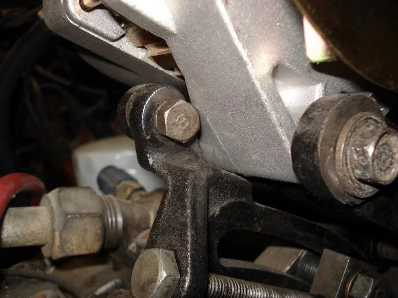

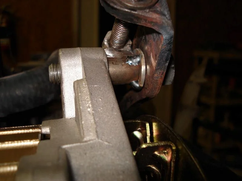

I installed a 120 Amp CS-144 Alternator in the 60. I believe it came out of like a 1990 Cadillac Fleetwood. I used the stock bracket but I flattened the bend out where it mounts to the block. I used the stock tensioner, but I had to make a spacer to fit the tensioner. It is just a piece of tubing with a nut welded to it for the tensioning bolt. I haven't got to wiring it up yet since I'm still in the middle of my build. I also had to slightly grind the A/C tensioner bracket.
