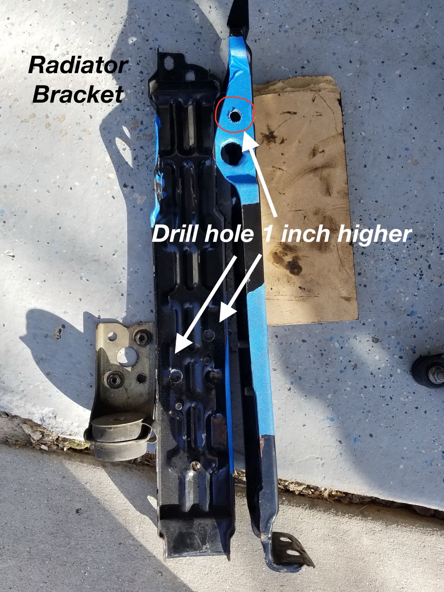

Instead of modifying the lower mount I modified only the side mount and drilling on the front of the body. I modified the radiator side mounts.
Were you able to utilize the upper radiator mount bushing with the smaller sized upper mount hole?
