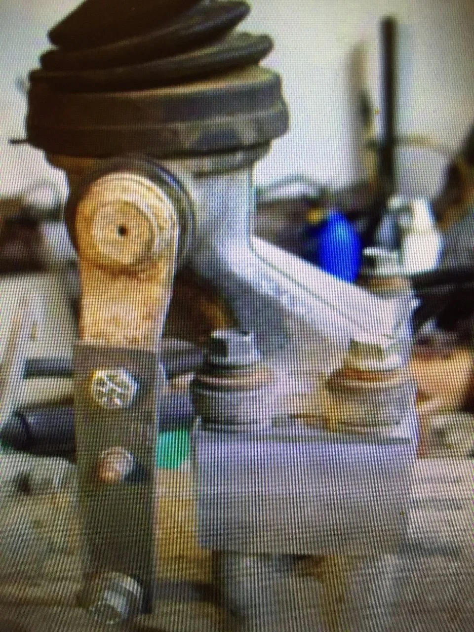

These are the part that I made. Tcase is just 1" square tube welded and drilled. The supports were cut patched and welded in. I used this for 50k ish miles. Decided to remove the 2" lift when I got sliders. If your interested in kit pm me. I've been meaning to sell it but haven't gotten around to getting pictures and posting it

You might be able to make a spacer too, just make sure that you have enough extra linkage to make up the difference. Also, my 80 is a '91 so keep that in mind.
This material is better handled on a lathe.
But if you're careful you can pretty much get it Square on a chop saw and drill the hell didn't the vice
so just to confirm you added spacers on the 4 bolts under the base of the s***er to compensate for the body lift.
Yes, if you have a lathe it's easier to work with this material. You could still do it with a saw and drill.

I have also seen some builds where they leave the mounting with no change, but “Z” the shifter rod by cutting it, and welding a 1”-1.5”-2” spacer between the cut ends.

“Z’ing” the shifter rod, would be after spacers were used to lift the shifter up through the floor. The shifter rod would be “Z’ed” rather than the shifter arm extended.

I was able to weld 2 1" box tube together when I had my 2" lift. I did not have to make any adjustments to the linkage.
