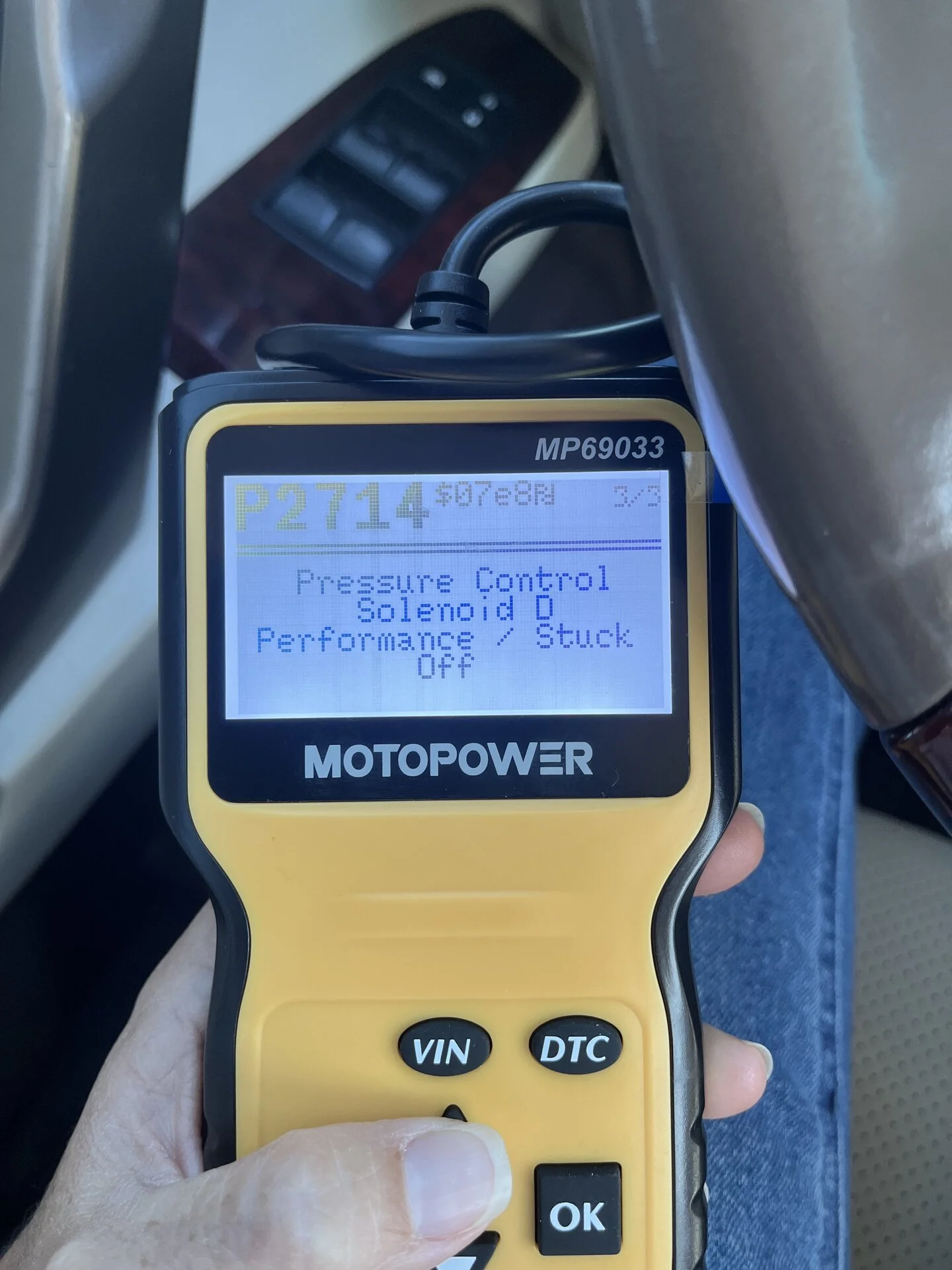

Thankfully nothing as serious as that. But always concerning to see things like this
