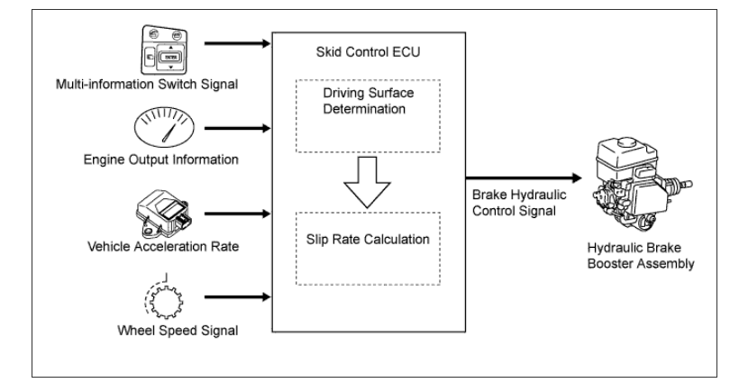

MTS also offers up different ABS "Braking" algorithms while off-road
