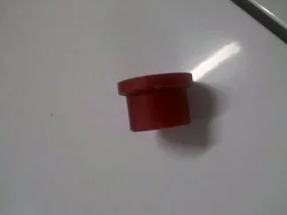

I bought some D-Rings to put on my ARB bumper a while back. The only problem is that ARB doesn't provide a good mount on their bumper for D-Rings. The mount is not wide enough to allow them to hang straight and not rattle so needless to say, when I put them on I wasn't happy with how they looked or how they rattled around.
I was trying to figure out how to best solve the problem without having to weld something on the bumper and thought of using a polyurethane bushing. While I was in Dallas I stopped by 4Wheel Parts and just asked if they had any "extra" bushing laying around their shop that were left-over or extras from the many lifts they install? After telling the guy there what I was doing he went to the back and came out with several and put them in a bag. Major Score... for free!

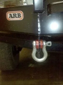

So I used a vise and a hack saw, cut off the narrow end and then had about a 1" bushing left. I cut the bushing in half and installed. They fit perfect now and look great. No more rattling either. Here are some pics... I just love free mods! 1275496570277.jpg

If you attempt to recover from those, keep everyone well clear. And hope that the person doing the pulling doesn't mind holes in his truck when the d-ring goes through it.
Jul 20, 2004
24,774
Chandler, AZ
Those are jack mounts. Though it looks cool with rings there they would be toast
if used for recovery. One flaw with the ARB IMHO.
Agree, total poser look. If you go wheeling, the shackles will drag on the terra firma, possibility hanging up the rig, also beating, scratching the shackles. If the shackles are used on a strap, the burrs on the shackles will cut fibers on the strap, reducing it's life. My shackles are stored in the recovery bag, with the strap.:hillbilly:

Man! I thought that those were for recovery shackels as well! Where do you attacha shackle then?>
On the stock tow hooks that are bolted underneath the frame. That's the reason that arb supplies the metal spacer that goes between one of the frame rails and the arb bumper, to reuse the tow hooks.
