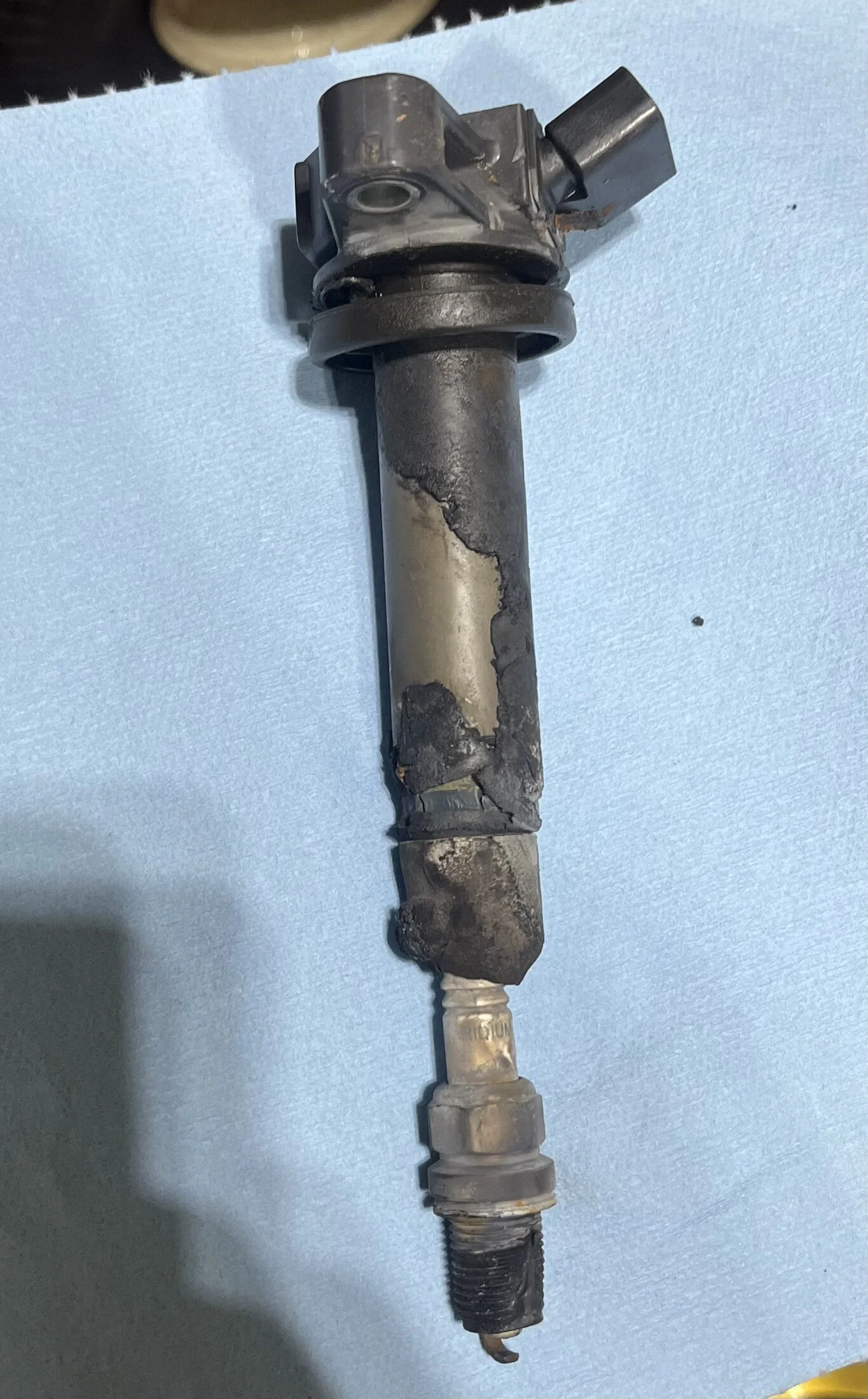

I was changing my spark plugs and the coil in cylinder 4 was stuck. There was an oil stain around it. I figured it was maybe the valve cover gasket. I had to pry the coil loose and this is what came out:
I tried to put the new plug in, but the threads are damaged and it’s unable to seat.
What do I do now? Can I drive it to the mechanic with a loose plug in cylinder 4? Can i rethread the cylinder myself?
I am really bummed. Any advice will be appreciated. Thanks

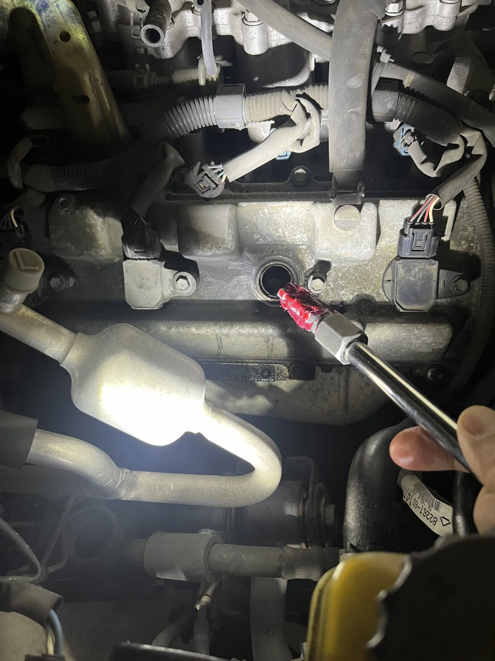

I repaired one of these a couple weeks ago. #8 plug. I used the helicoil kit and did not remove the head. The helicoil kit comes with a tool that bores out the hole and threads it at the same time using a ratchet. No drill needed. I dipped the threading tool in red grease, made one full turn in the hole, removed the tool, cleaned it,dipped again in grease and another full turn. Repeat until the hole is completely done then clean, thread in insert according to instructions and reinstall spark plug and coil. I am sure I did not get any shavings in the cylinder.
If I did happen to get a small shaving in the cylinder it doesn't really worry me too much. Aluminum is a lot softer than the steel cylinder walls and will most likely be sent out with the exhaust.

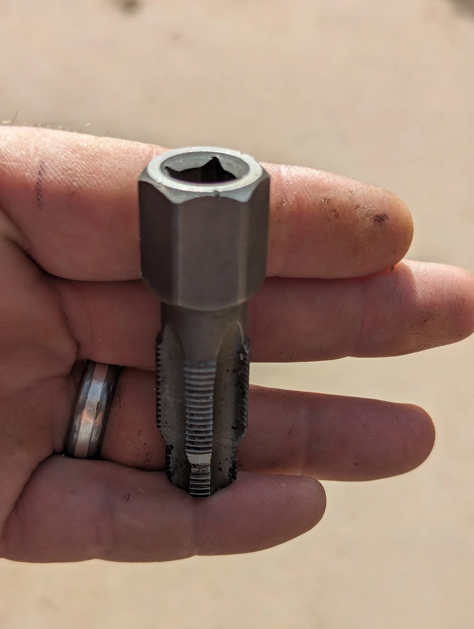

I bought the Helicoil kit at Oreilly's. Make sure the threading tool will accept a 3/8" extension.
We don’t have O’Reilly’s here in Delaware. AutoZone doesn’t carry it, advance Auto has it on back order so I’m waiting for Amazon to deliver in 2 days. I will change the back rotors while I’m waiting👌🏼
Cool. If you can, make sure it has this tool. Some of the kits have the tool that can only be used with a socket and it won't fit down the hole.
Just did this to the one I picked up a few months ago. Went with the time sert kit -- no issues since. There's pics on my thread -- but at least yours is on the pass side! Probably easier access than the driver's side.
Did it with the save a thread kit. No boroscope and no taking out the head like some had suggested. I Didnt even need to remove the valve cover. Its running great now. In hindsight I always used to have this faint shudder every 30 seconds or so while idling. That was probably a sign that the plug/coil was going.
Dont ignore any faint shudders and check the torque on ur plugs atleast once a year is the lesson I learnt.
