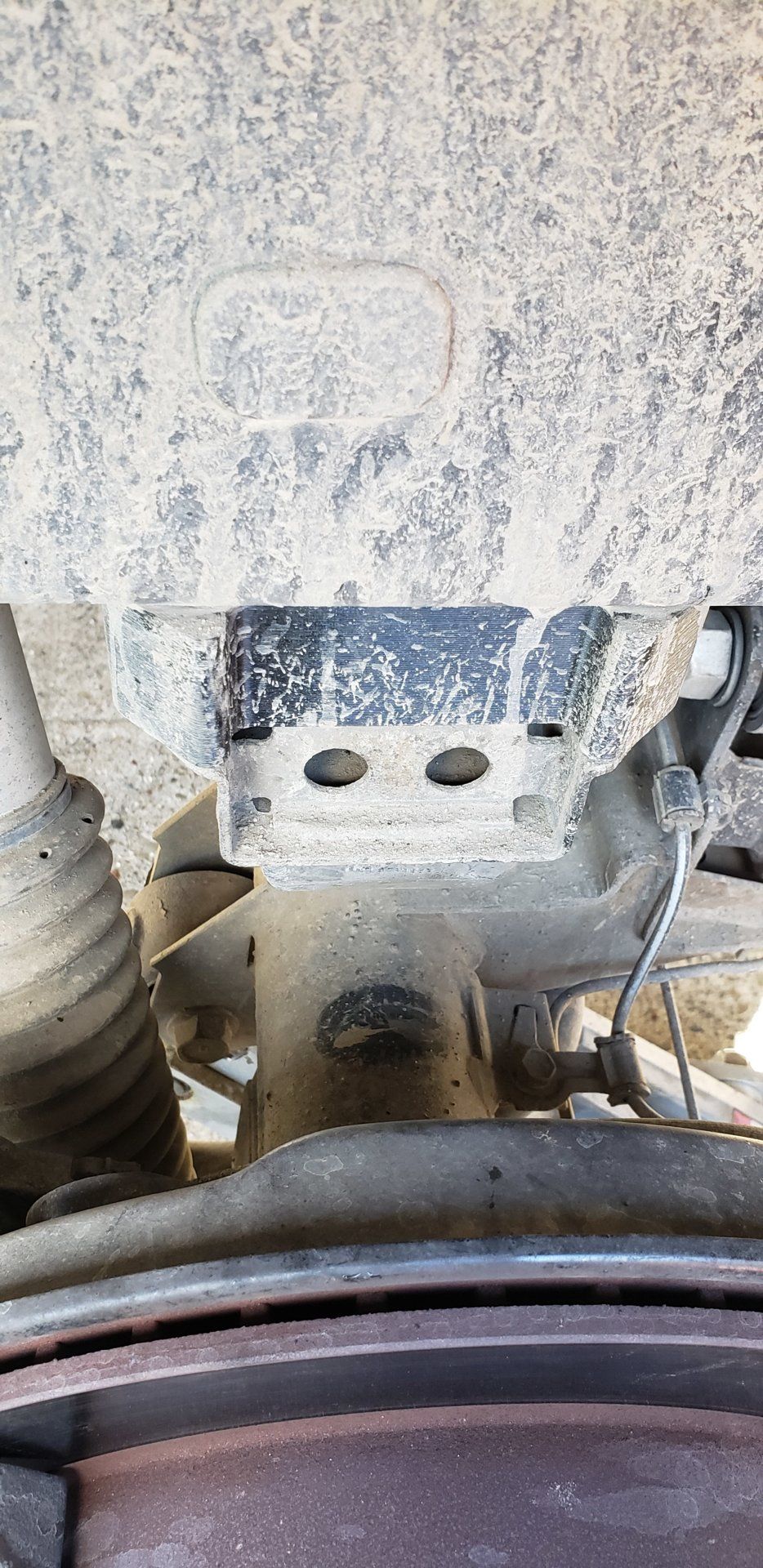

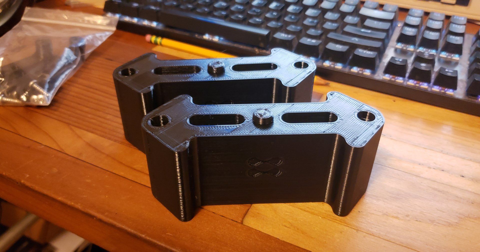

3d printed bump stops for the 80 series land cruiser. Made of petg, come with stainless bolts.
I bounced off of these at Pismo beach during Turf n Surf, then on the Mojave trail. Land cruiser Phil @LandCruiserPhil took them throught death Valley.
Let me know what size you need, 2 in is normal.

thanks for the info @lcwizard , Some run the bump stop for rubbing issues with larger tires.
I was't sure one the bolt pattern, and I have a bump in the center of the bump stop so that they can be stacked. I am not sure the bump will work with the 40 Series bump stop, I may just eliminate it. if it will work with 40-80 series.

They actually don't, it's close but the 80 bump stop bolt spacing is wider. Close enough that the stepper bit can make it work to bolt the 80 bump stop straight to the 40/60 frame but I doubt it would work with a long spacer unless you made the bolt hole a lot bigger.
I have 80 bump stops on the front of my 62, I had to elongate the holes

Makes sense. I build bumpstop relocators for man-a-fre for about 15 years. All the holes were slotted so they seemed fit everything, my 80 lift kits, 40 and 60 shackle reversals
