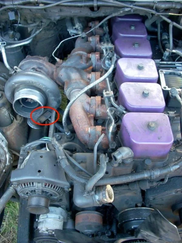

Does anyone have the specs of this Holset turbo .. ? it's the same model size ( I don't think so ) that come in the 4BT . !
damn dude . lucky men !
If it is a HX35 here's some info: http://www.holset.co.uk/files/2_1_1_3-Holset HX35.php There is a turbo thread on 4btswaps and some think this is the perfect turbo for the 4bt, but it never came standard on one.
It could be bigger like a HX40 but I don't know if those ever came without a wastegate.
I don't have either one here, they're both in Portland. How would you tell, the engine in the cruiser is off a 92 and the other is a 94?
The best way would be to look on that tag and get the numbers. It should tell you the model. Mine didn't so I had to google the only number I had to figure it out. I'm just going off of looks and what was available from the factory.
The one off the 94 pictured above is the HX35w. The other is a H1C? serial number c0245324. I'll probably end up using the HX35 as its setup to run an intercooler low and be able to clear the hood better.
