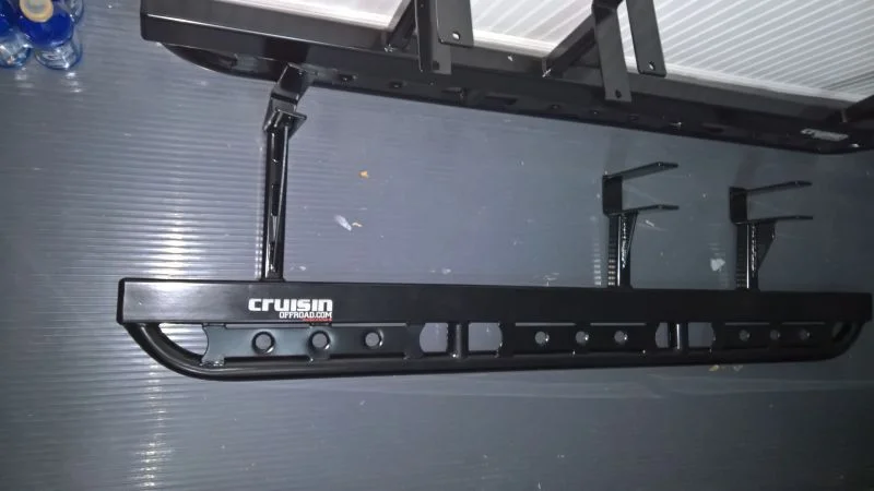

I really like the mounting design of these sliders. But, did you have to drill the frame to mount them? I've looked at my frame and the logical places to mount them has giant holes...seems like if you used those holes there would be a lot of potential slack in the mount.
No drilling but it's a tight fit. The bracket hugs the frame then the bolt clamps down from over the top of the frame.
Ohhhh...wait, from over the top of the frame? I think I'm thoroughly confused now.
Some sliders use a bolt on top and a bolt on bottom, slider on one side, bracket on the other, to create the mount.
These use a welded integral "U" shaped bracket so only the top bolt is needed. Less hangs down under the frame rail. Maybe a pic would help?
full
Ok, yeah, that makes sense. Were the holes they utilize in the frame a lot bigger than the bolt?
No holes in the frame. The bracket length matches the frame height so the bolt basically rests on the top of the frame. The fitment is close enough that for one of the bolts I had to slightly bend it in a vice so it would clear the frame top and still go through the hole on the other side of the bracket. Really all the top bolt does in this application is keep the sliders from falling off.

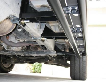

Below is a pic from a Slee webpage. See how they use a "U" bolt to attach the slider at top and bottom.
I liked the aesthetics and the price of the Cruisin OffRoad product, so I went that way. I have no idea which way is stronger/better.

To answer the questions about mounting, the brackets do indeed wrap the frame from below, and the bolts go above the frame rail and pinch the two vertical brackets. Due to the angle of the frame from front to back the sliders are well trapped in place, and stay put very well.
