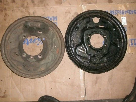

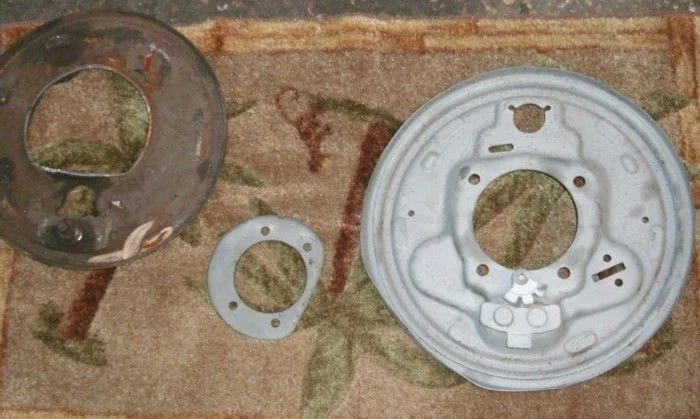

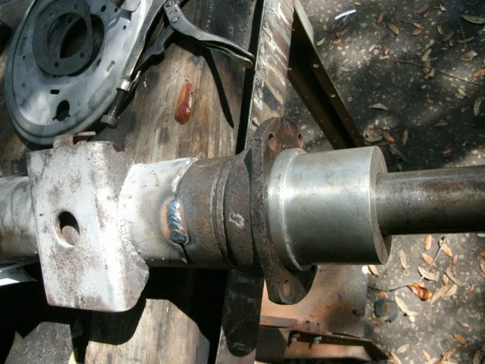

I went out to Pik-N-Pull and found a Ford van with a 9". I cut the axle ends got the backing plates. The rear end in the van ended up having a .250" wall housing. I Paid $22 for everything and left.

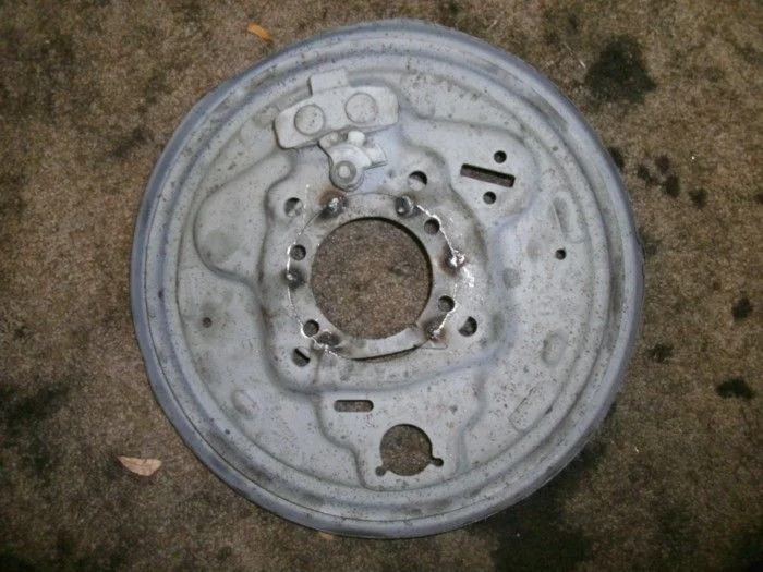

For simplicity and Cheapness Cruiser backing plate and drum brakes will be retained. I cut the center off the Ford backing plate and it will be welded on the Cruiser one.

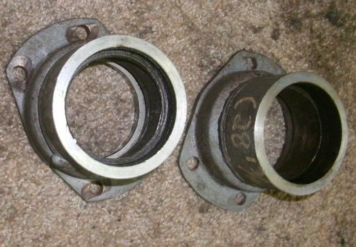

The Ford bearing uses a race instead of having the bearing ride on the axle.
IMO a better design than Toyota and GM as far as wear characteristics anyway.

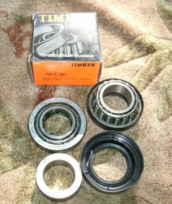

A Timken SET-20 bearing, race, seal and collar set was purchased. It is tapered roller bearing style and is a direct replacement for Ford roller bearings.
Tapered roller bearing should be better suited for lateral loads that we put against our axles when wheeling.

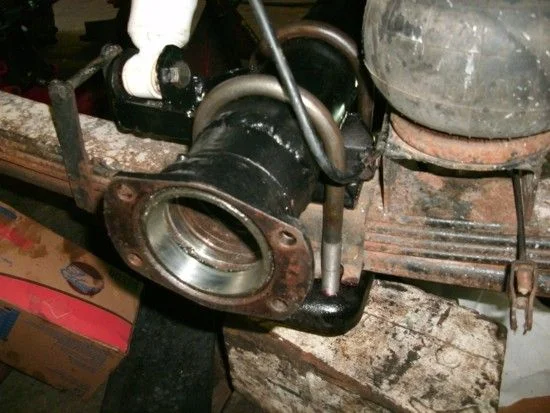

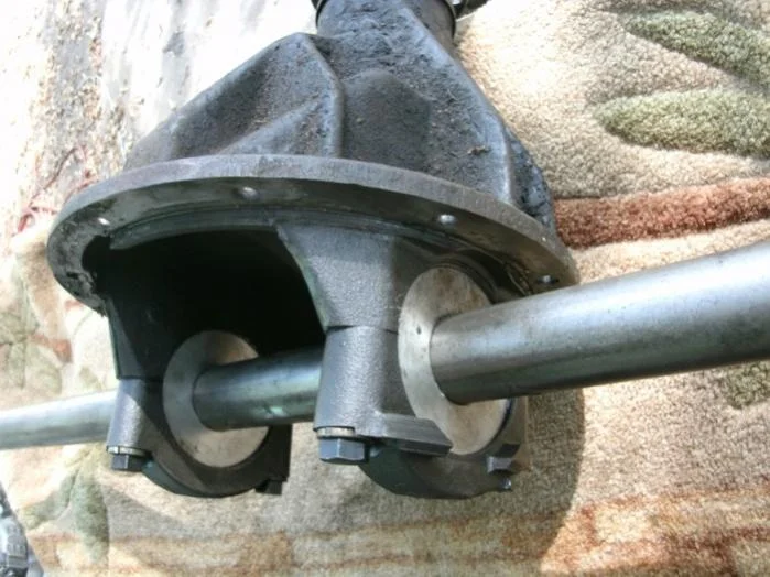

I had a Ford 9" axle centering setup. Come to find out that the Ford outer brg OD is the same as the Cruiser's diff carrier bearings.
So I cut some excess off the outer pieces to use for diff pucks. It saved some $$ having to have new pucks machined for the Cruiser diff.
Alignment shaft in the Cruiser diff
Ford end being tacked on while the centering bar is installed.

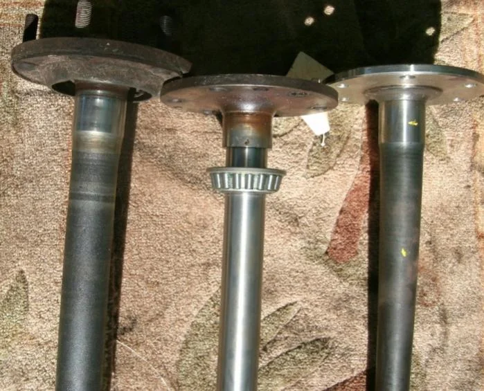

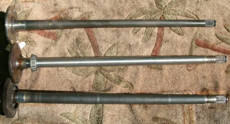

Here's pics of a stock axle, a stock axle machined for a Ford bearing, and a Poly Performance axle.
The Poly axle dia isn't very big. The machined Cruiser axle is actually bigger. So really not much will need to be machined off the Poly axle.
The poly axle seems to be plenty strong even though the shaft OD is quite a bit smaller than stock.
with the press on ford bearings the shaft will be fine @ the bearing end. the crusier shafts and many others need to be treated because the bearing will turn on the axle a slight bit. when they press on they will not spin on the shaft.
the axle i machined for flcruiser i did not touch the splines so they are still treated.
steve i am concerned with the poly axle. it appears that it necks to fast after the stock bearing surface.
It necks very fast. They sure will be easier to turn down than the stock shafts!!
Much less metal to cut.
I did measure and there is enough OD on them far enough out so they can be machined for a bearing and collar.

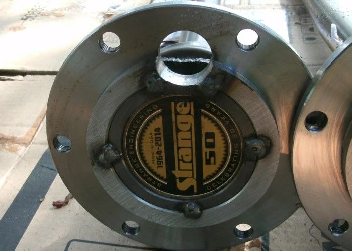

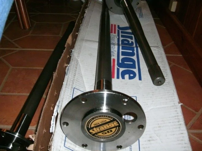

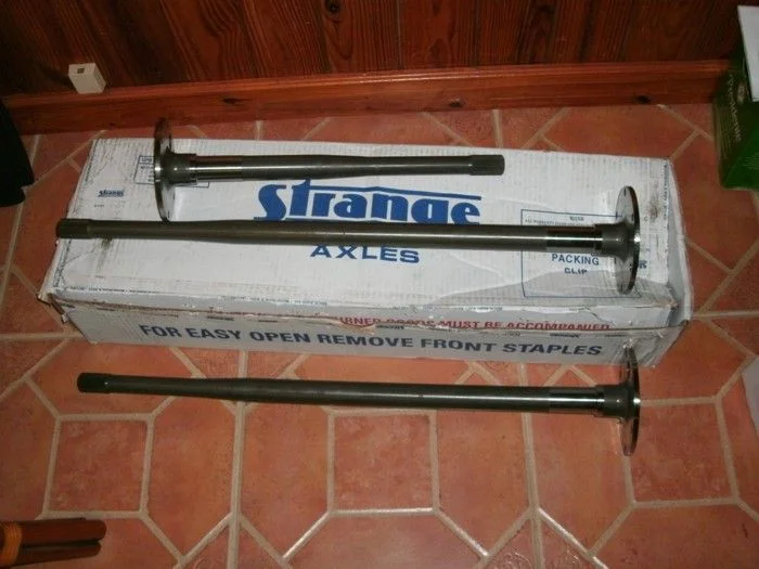

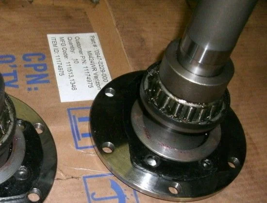

Strange came through
They couldn't make the flange that centers the drum big enough for the Cruiser drums. They were probably limited to the side of their axle blanks. I had some spacers made and tacked them on the axle, then had to notch them out for an access hole.
