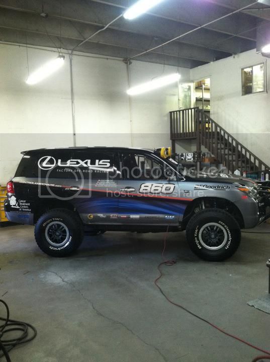

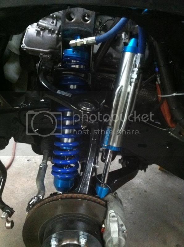

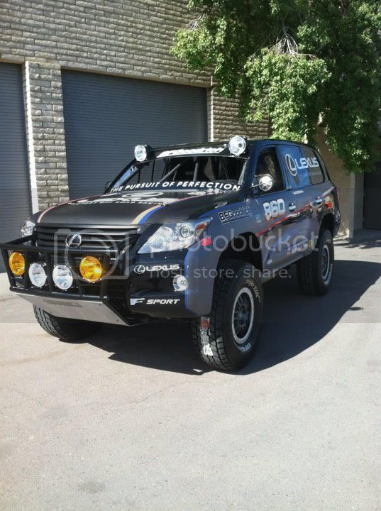

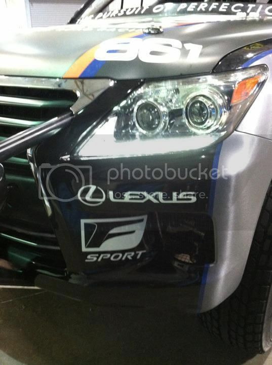

Is it really impossible to mod out the AHC on the Lexus? How was this LX570 lifted?
If you think that truck hasn't been completely rebuilt from the frame up you are snorting something... please pass some my way. = D
The frame is still the same. It also has a roll cage, custom wiring harness, but still retains the factory ECU as well as the power steering pump. It also has a custom radiator guard and transmission cooler as well as a custom bracket to hold 46 gallons of fuel. But the point of the thread is the lift. It's not impossible on the LX570 although it may look to be a little pricey.
