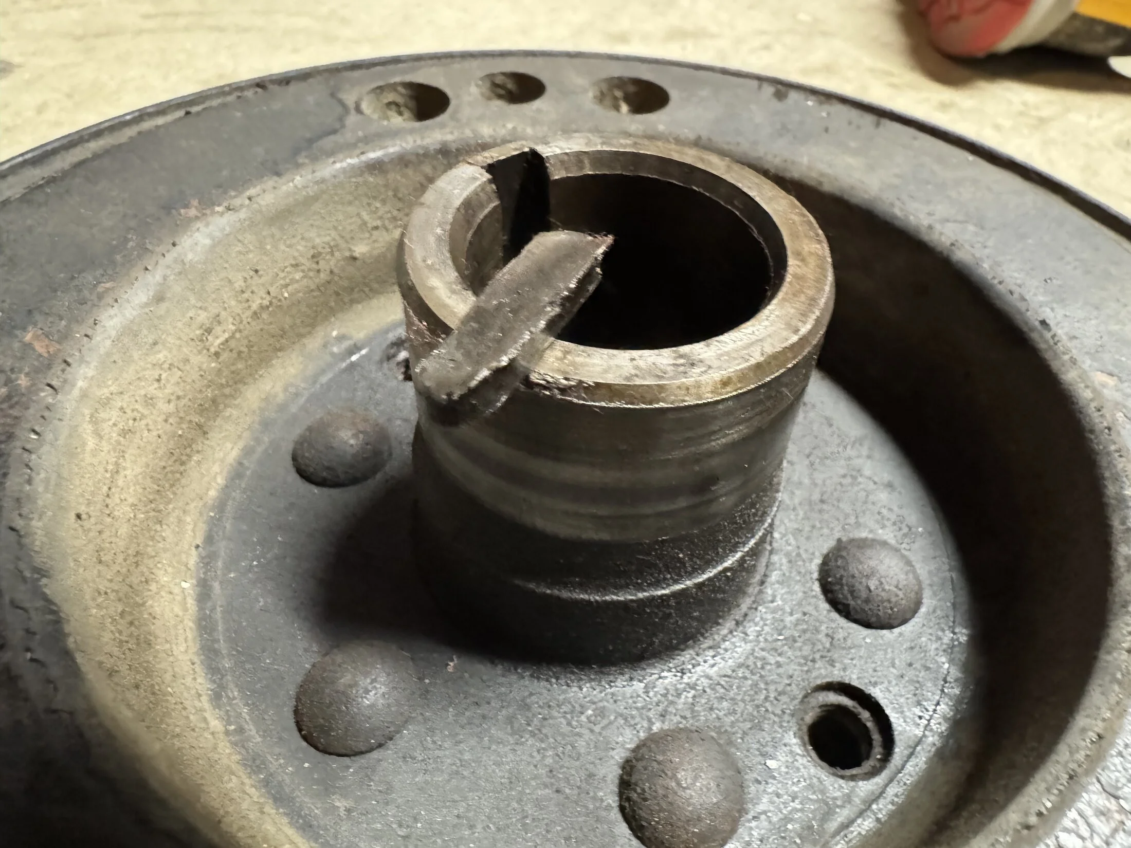

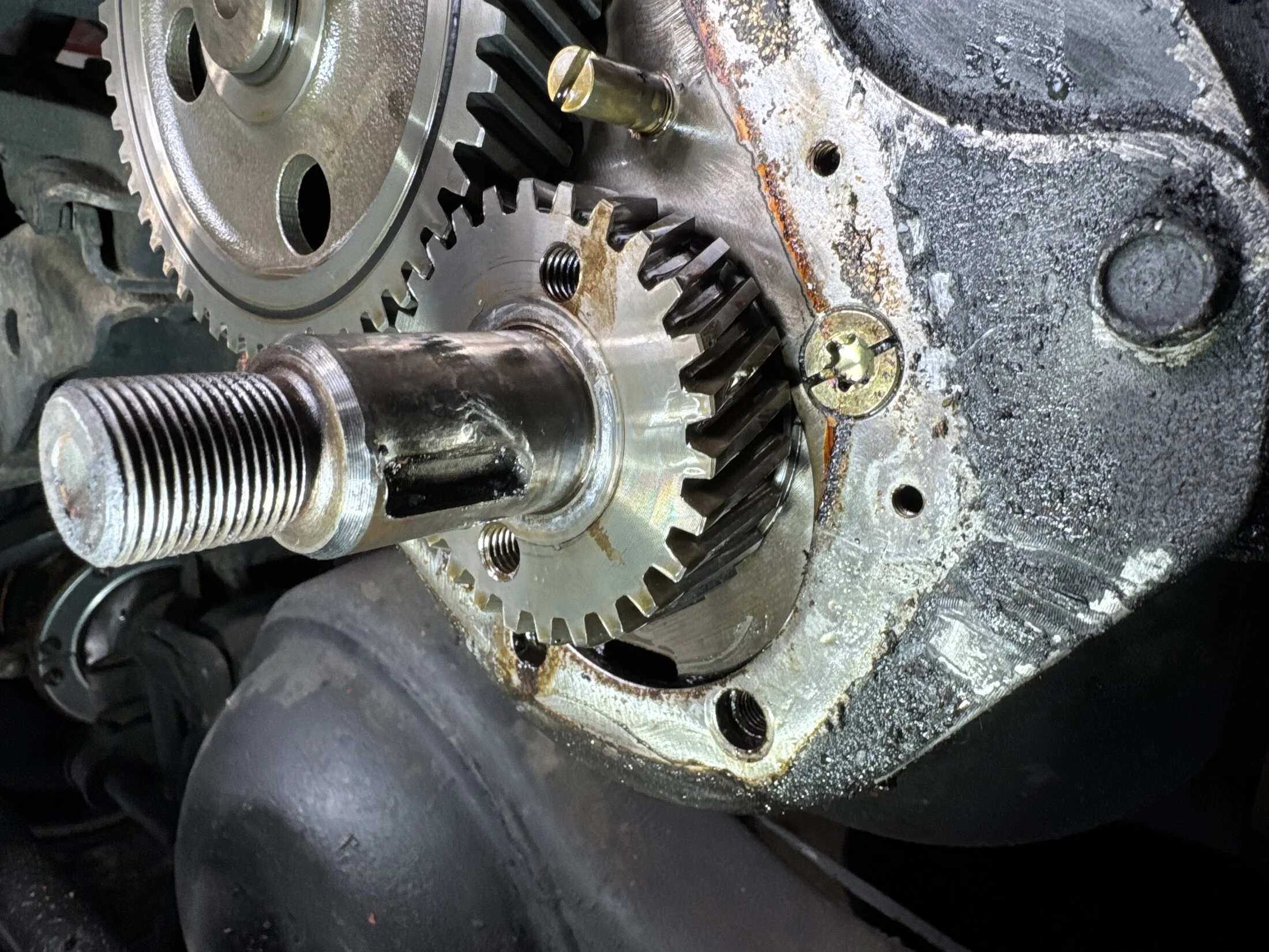

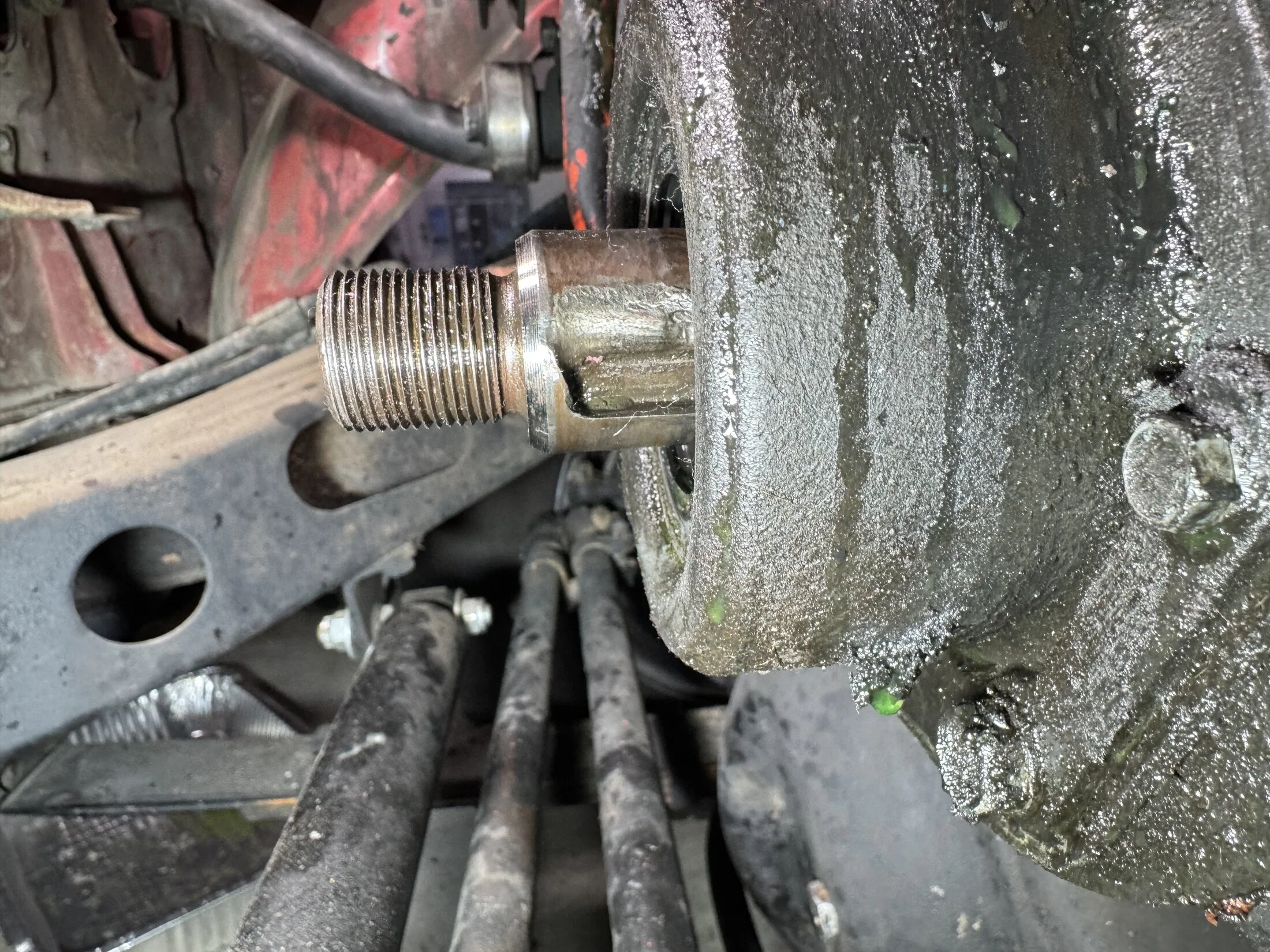

Still had a little bit of a vacuum leak, so - while Mark (Mark's Off-Road) was busy rebuilding my carburetor, I decided it would be a good time to refresh the water system and fix an oil leak I had coming from what looked to be the timing gear cover. Last week I picked up the seals, gaskets, new water housing, etc and earlier this week I drained everything, removed the radiator & belts. This morning I removed the gear pulley/harmonic balancer I ran into a fairly large speed bump. I included pics below.
I started to look for a new crankshaft and it looks like they're NLA. And the pulleys might be NLA as well, but I'm still searching.
Any suggestions on next steps?
Essentially anything the PO did the vehicle has been trash (why I decided to do the water housing fix b/c 1/2 a tube of blue rtv was go-ing out the sides), so I'm thinking I might pull the whole engine and jump in and just rebuild the engine right now. See what other problems exist. I'm also planning to put in an HF55. And I have a pretty big rear main oil leak. Could tackle all this at once...

The last photo isn't too bad - have you purchased a new key and dry fitted it to the crank and tried to slide on the pulley? You might get away with this, if it fits up tightly and you properly tighten a new nut on the crank end. Otherwise, a used crank may need to be in the cards.
Agree w Steve. Clean up the protruding burrs w a fine file, and hopefully you can find a metric key that you can interference fit within the slot that’s left. Hard to see how much of a lip is left on that chunked out side. Best of luck tho.
I would think a competent machine shop could rework that if needed. Easier said than done, of course.
Thanks! I ended up grabbing a new pulley from Mark (as mine has a hairline crack in the key well) & I think the local shop can help out the end of the crank. I'm going to take it all apart next week and see what other issues I run into!
