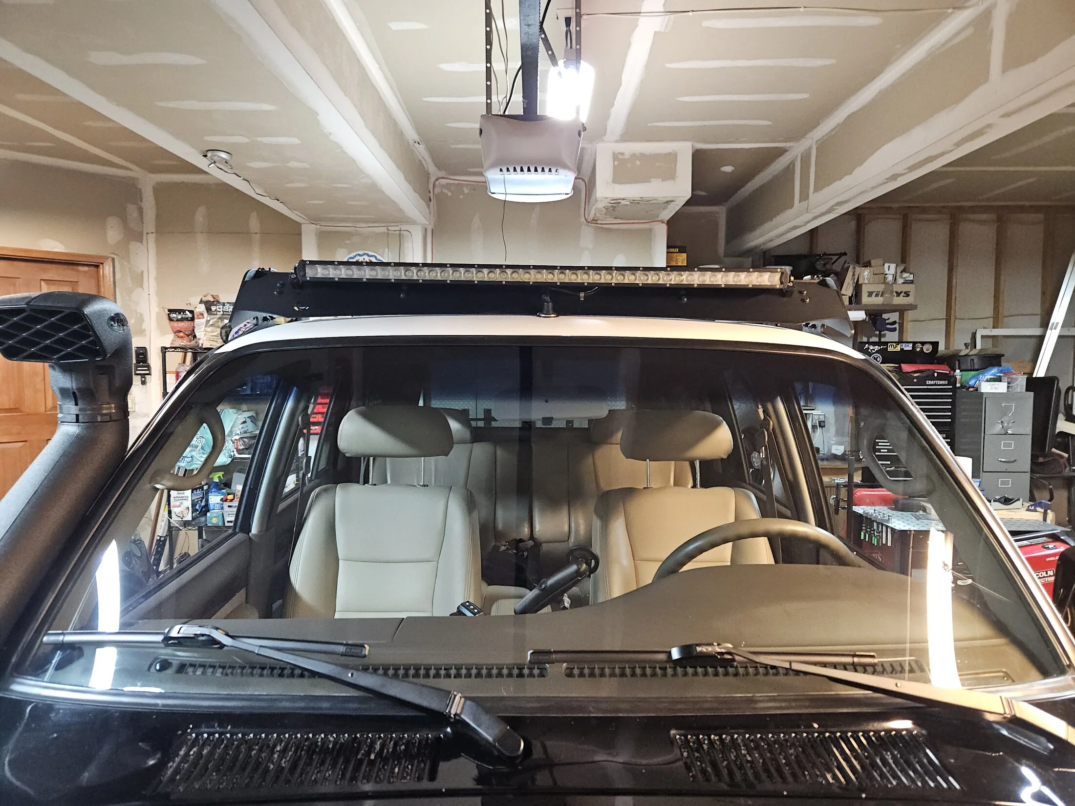

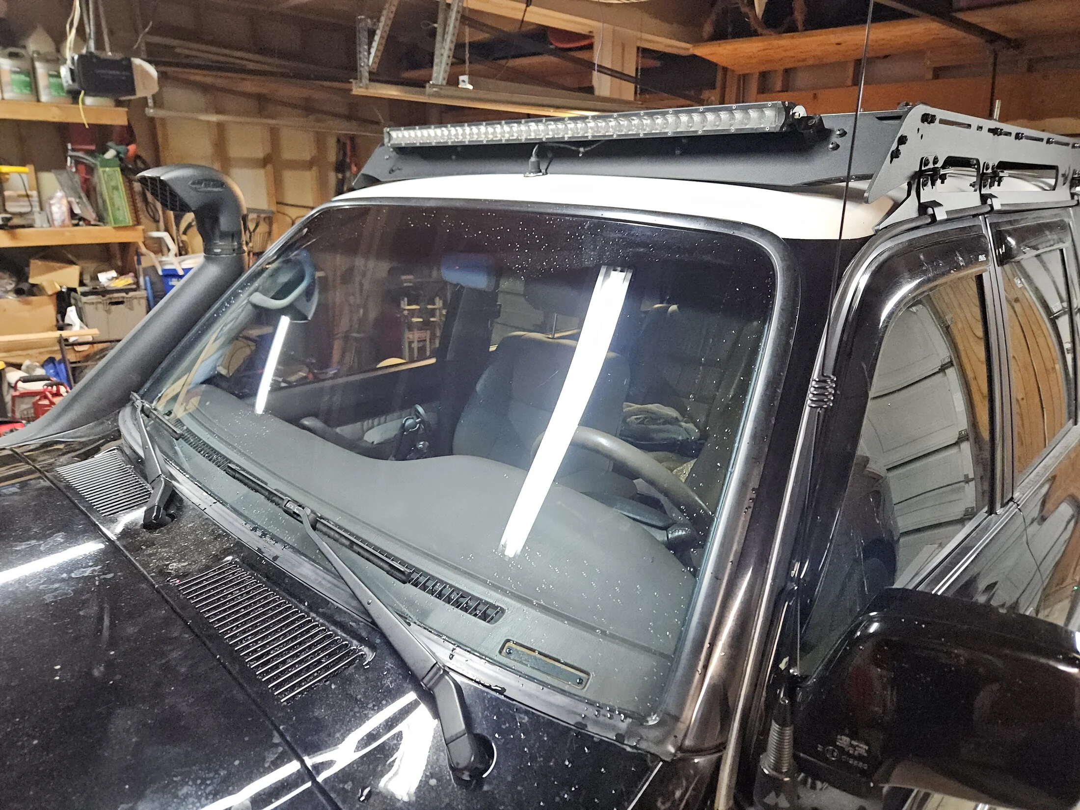

I got everything put back together today, except remounting the roof rack. Windshield reinstallation is scheduled for Monday. We got the rack off with two people, but it's going to take four to get it back on.

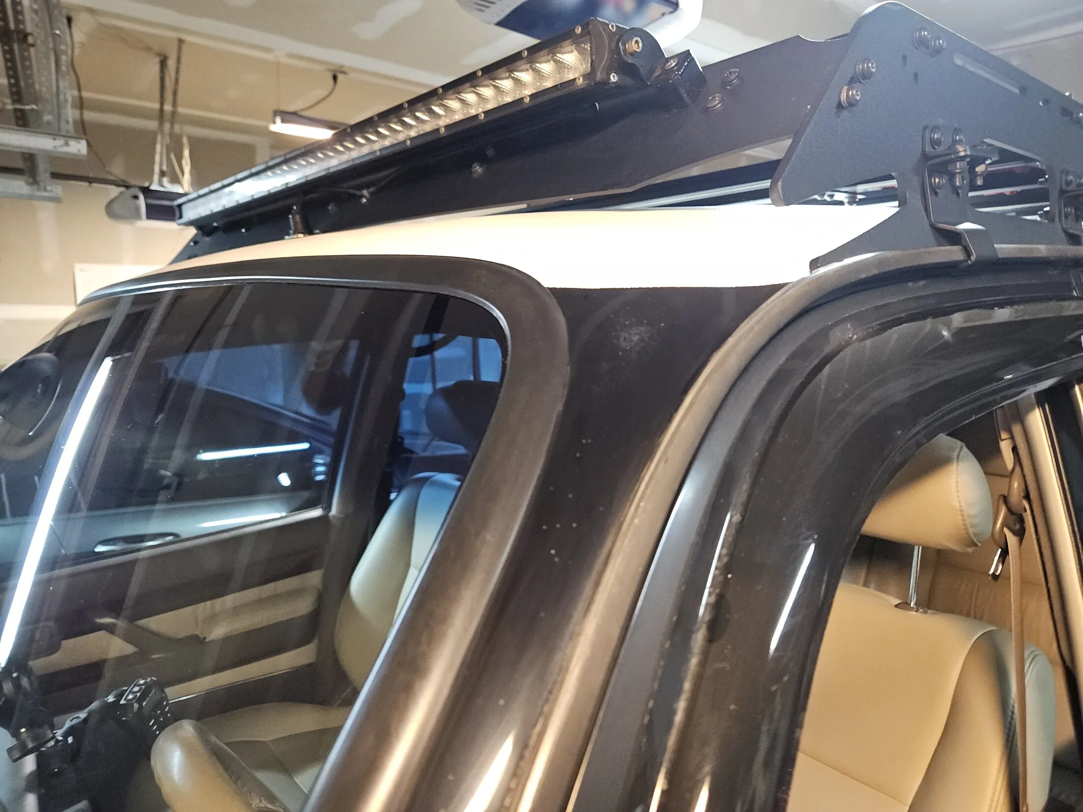

Today's fail is buffer burning the new paint on the a-pillar. :bang:

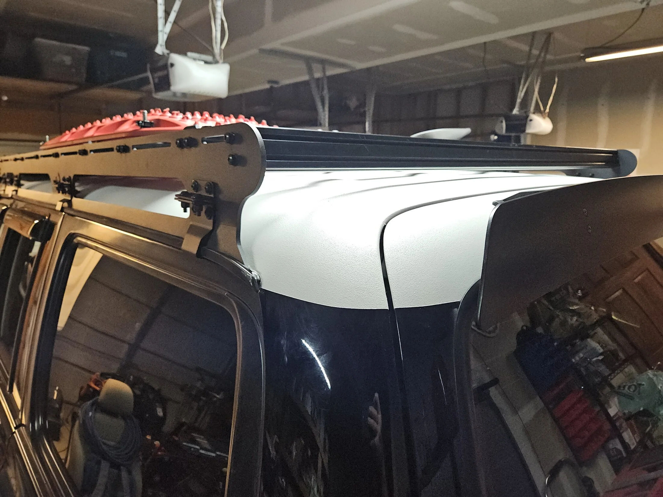

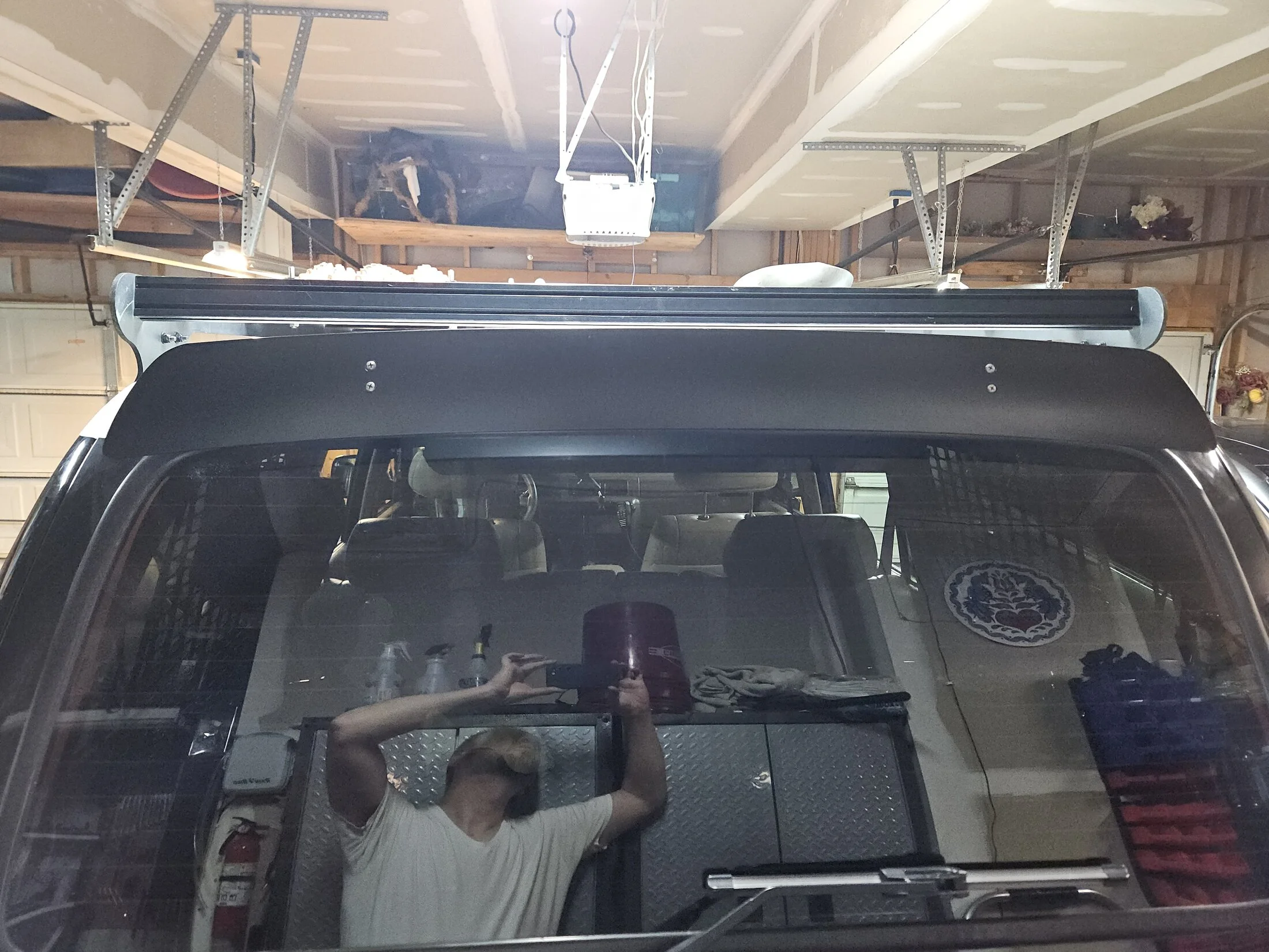

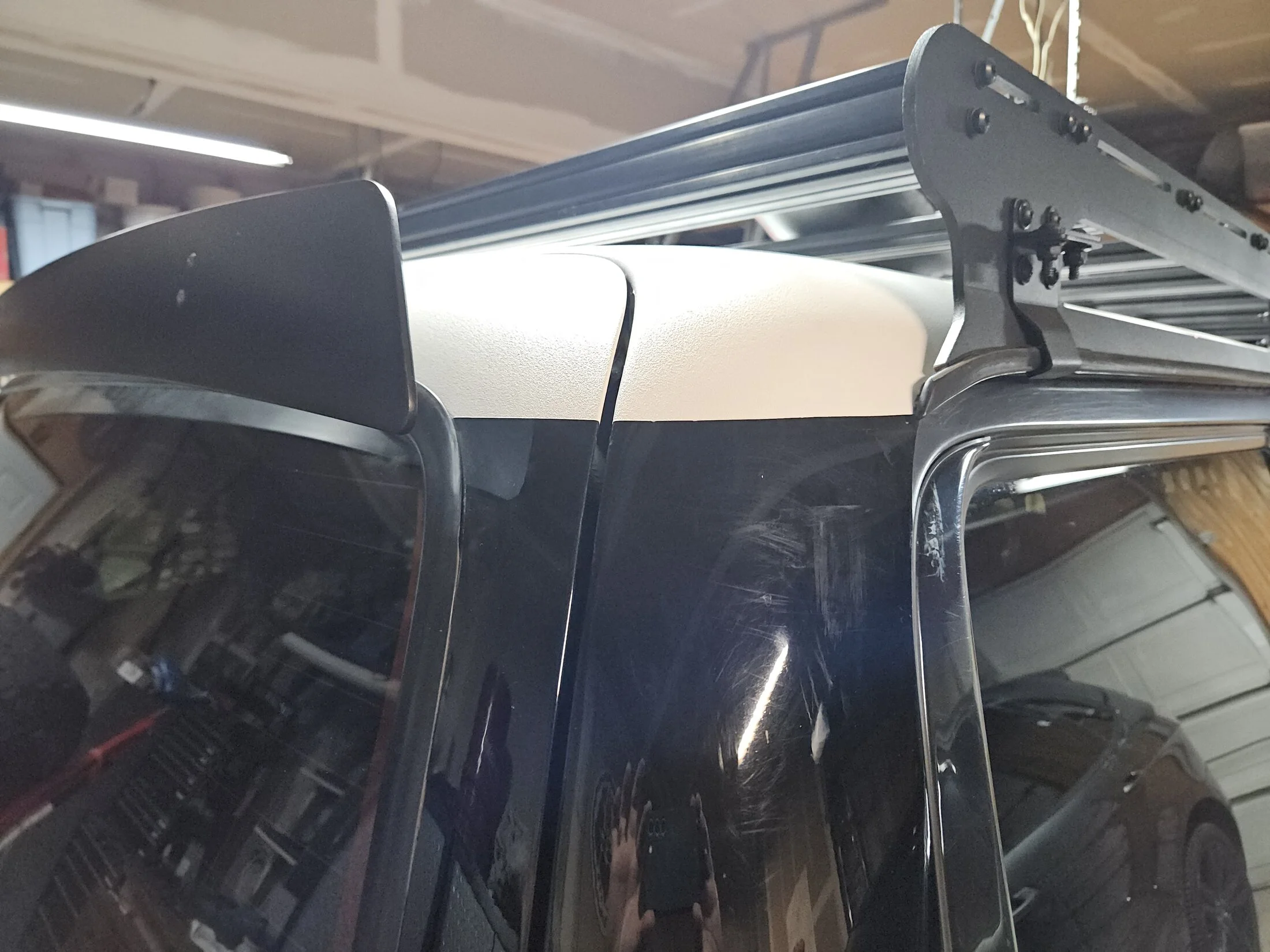

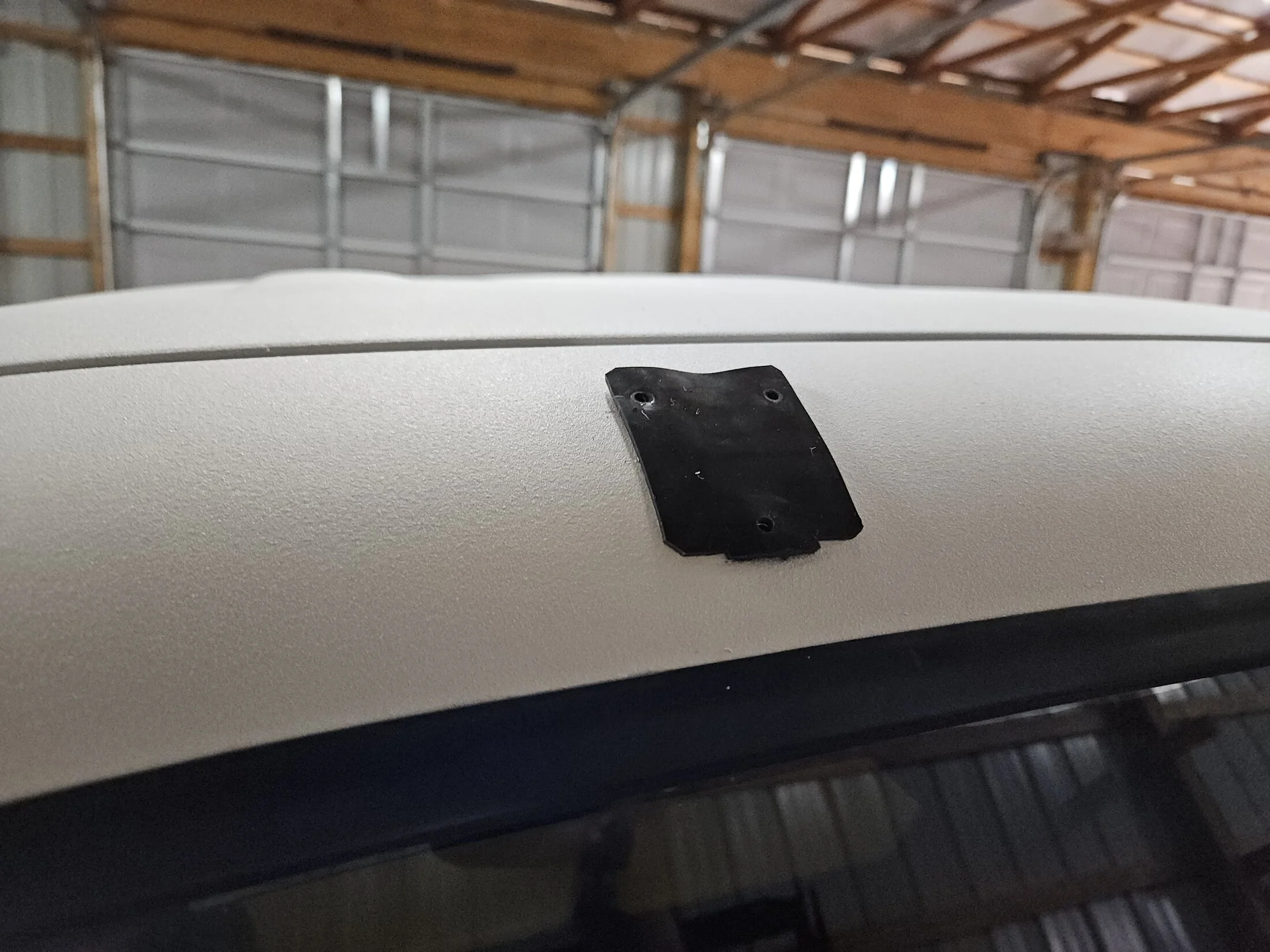

Here are my new cushions for the rear wing-thing. I used stainless rivnuts and plenty of sealant. You can also see here the matte/fine texture.

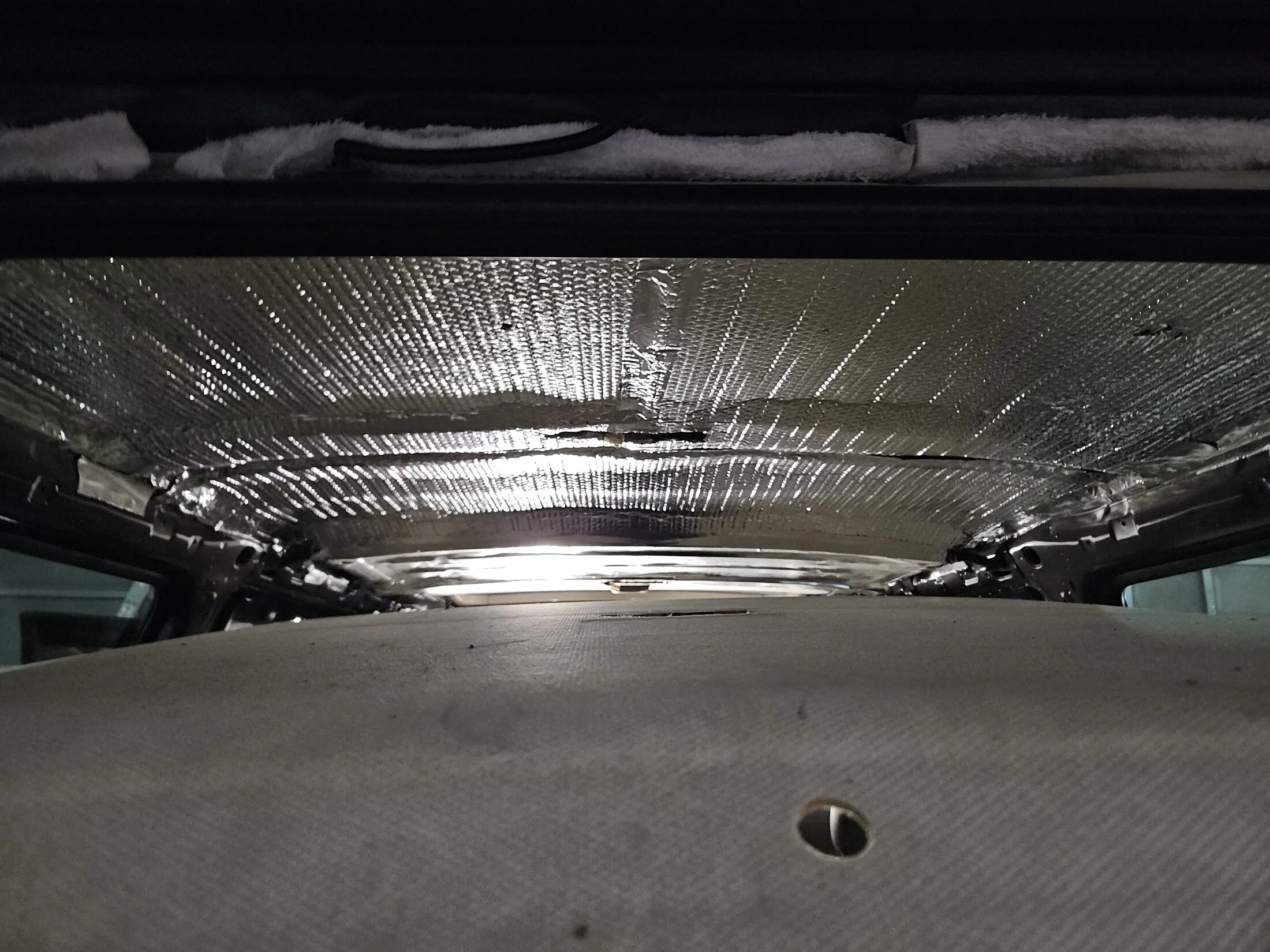

This is the insulation on the roof. Between this, the new, white roof, and full tint (inc. windshield), it'll be interesting to see what difference it makes in interior temps.

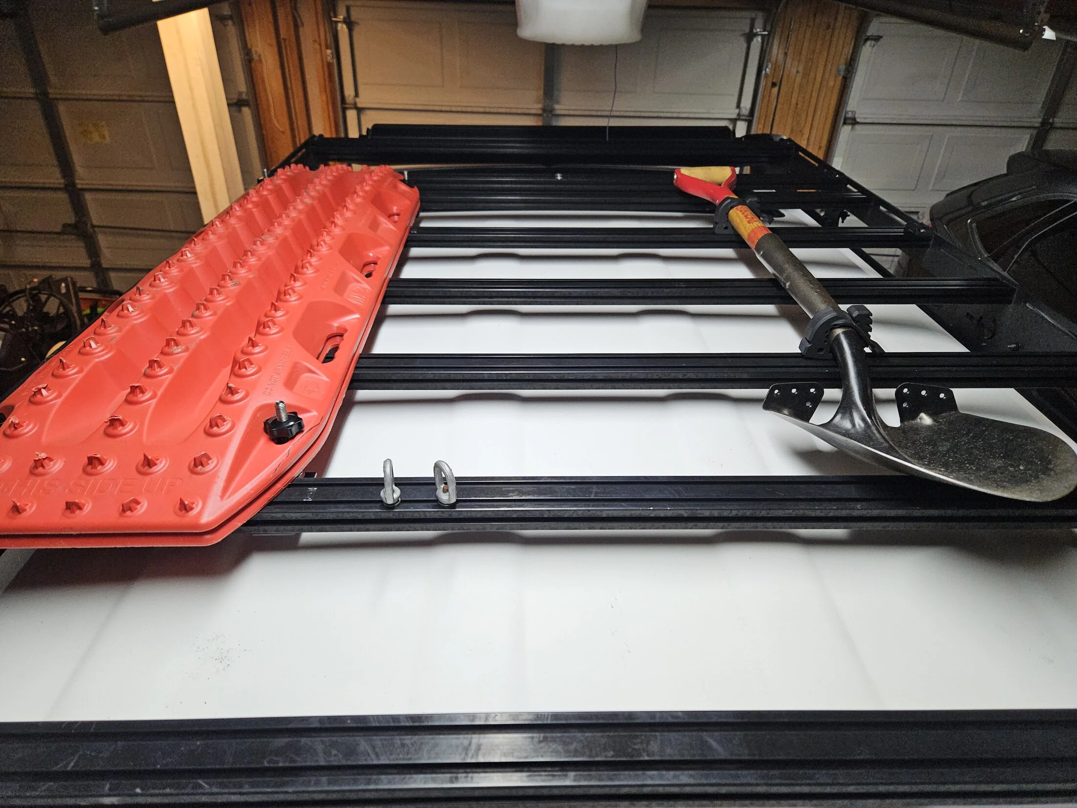

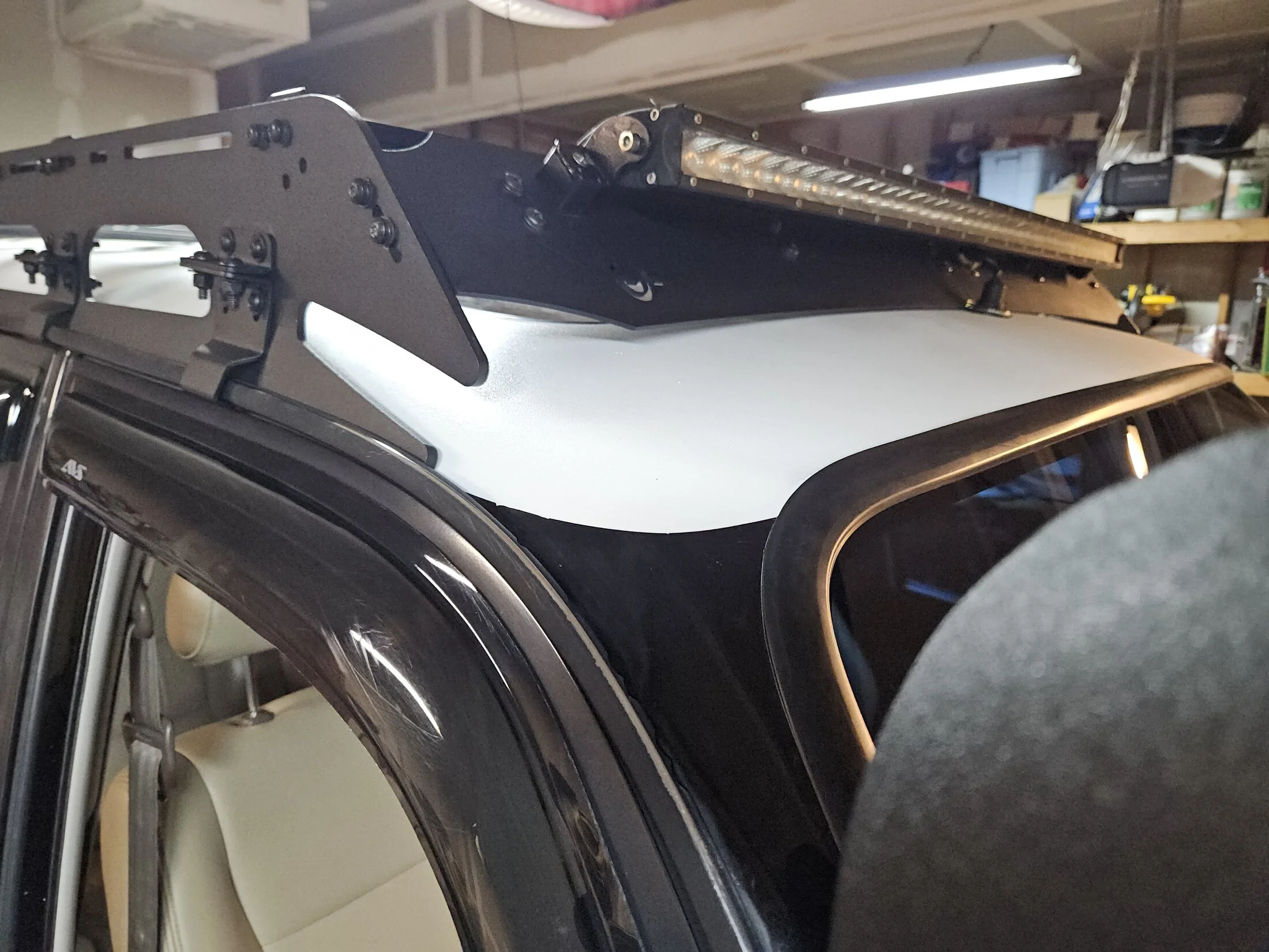

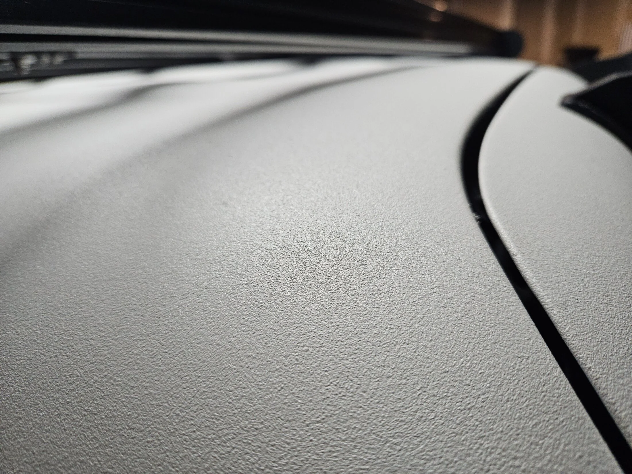

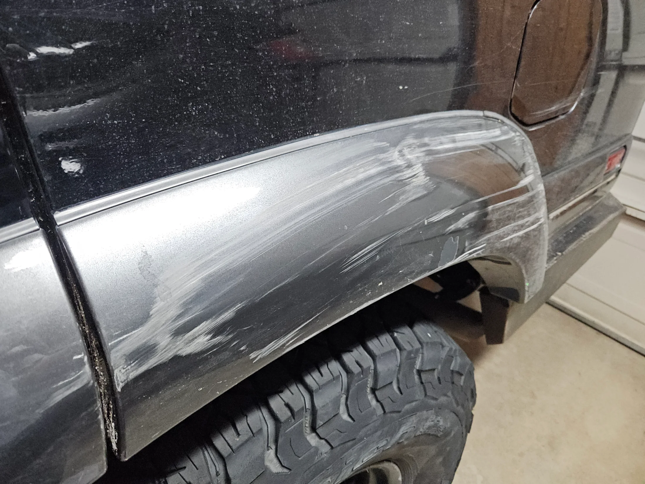

Since we'll apparently never see the sun again, in CO, here are detail photos under better fluorescent lighting (I'll still add some pictures in the sun, someday). Now that it's back together, and the roof rack and windshield are hiding some of the flaws, I must say that love the result! I nailed the matte finish.
I can't say I enjoyed this project. I can't stand fumbling my way through a series of failures like this! It was worth the hassle, though.
I think I might actually go a bit coarser (medium,perhaps) for the rest of the body, as that seems appropriate for where there will be constant sticks and what not dragging along long swaths.
Most of what you can see on the roof in that wide shot, is dirt from mounting the rack (which was a giant pain in the ass). Most of my flaws are now mostly invisible.

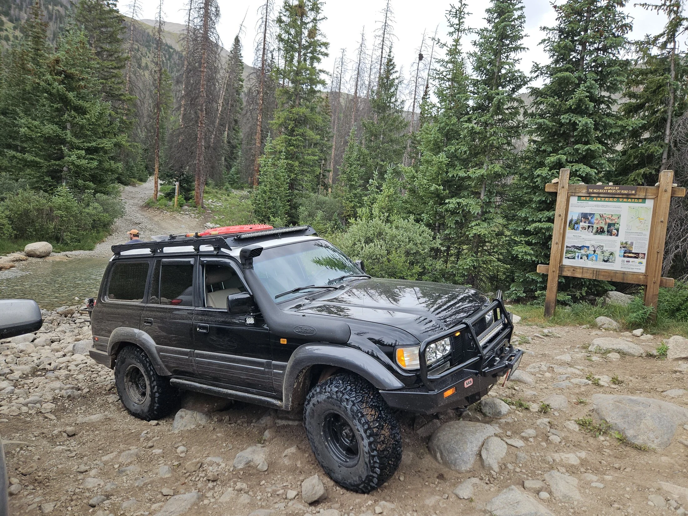

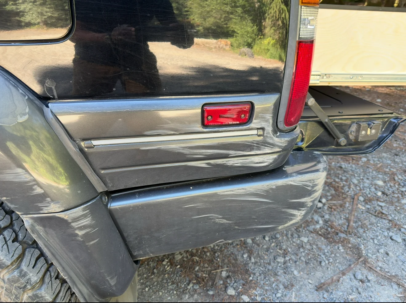

I slid sideways off the wet rocks and into a broken tree branch on Tin Cup Pass. That's one step closer to a full Raptor job.
Couple years back I got impatient getting past an obstacle and ended up getting too cozy with a tree and ripped the tupperware from the rear pax door. Luckily no sheet metal damage.
So I understand the feeling 😂

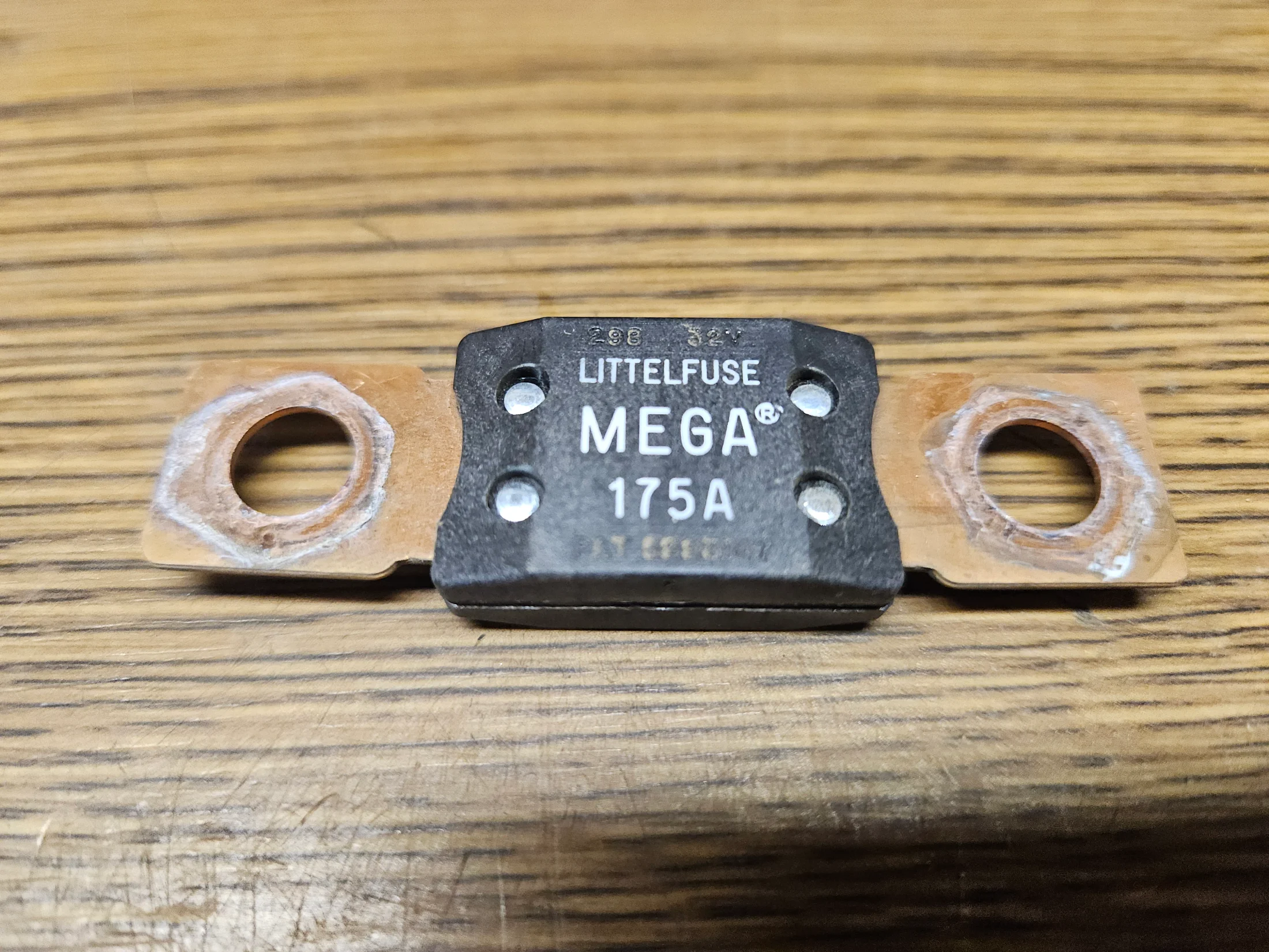

My truck came with a dual battery system inc. a BlueSea isolator and a switch. There's a Slee dual battery monitor on the dash, which has behaved erratically since purchase. On long days, it puts on a Pink Floyd light show for me. I did a bunch of (flawed) testing, replaced the switch (it broke) and the isolator (recommended by PO), and had concluded, for a minute, that the Slee LEDs were malfunctioning, but just as I started accumulating parts to remove it, I did one more test and determined that I was losing a volt between the battery and the isolator. I traced down that cable and wondered if there could be something wrong with the Megafuse on that line. It does have some corrosion and one of the nuts didn't feel as tight as it should have been, so I replaced it.
I uprated it to ensure it could carry full alternator voltage at 200*F. I slathered all the mating surfaces with conductive grease. So far, it appears to have worked - Pink Floyd packed up their kit and headed back to the UK. I'll know for sure on the next long trail ride.
Side note: I'm really disappointed in BlueSea's customer service. They were responsive in the past, but its been a whole month and they still haven't responded to any of the three messages I sent them in trying to troubleshoot this system.
I had similar problems this summer with my dc-dc charger. The diagnostics indicated it might be the alternator, but it ended up being a dodgy mega fuse the finally failed.
