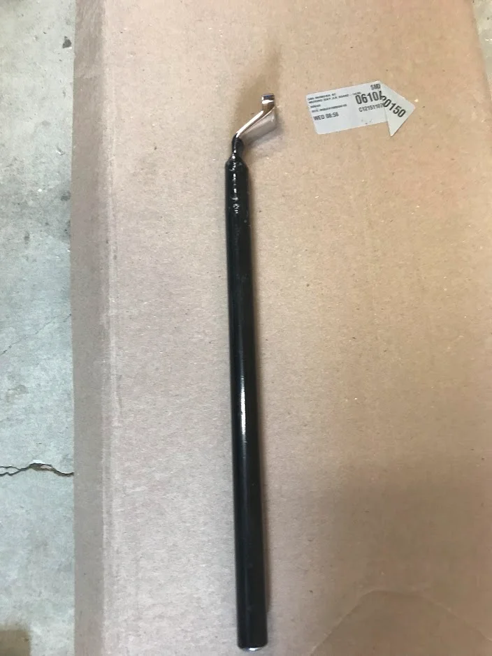

I'm running 39s and like hitting all the hardest trails, I made this so I can check my nuts on the trail super easy !!
17 MM offset wrench with a extended handle, makes it easy to get on the bolts next to the dust shield and long enough to get them tight.
It's always in my bag of tricks on the trail. Of course I always use a socket and torgue wrench at home ;)

All jokes aside, been looking for this thanks!
Even better if we can get 25 of us to get one each...lol
