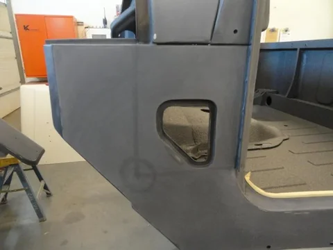

Just went through this very same exercies with my '67. The recommendation was that if I wanted to have OEM "looking" antenna, to put it on the drivers side cowl, just in front of the kick vent (40's have them on the passenger side, similar location on the cowl, but due to Vents, kick panels, internal bracing, mirrors, etc..., it was determined that on the 45, best mounting location would be on the drivers side).
The recommended location was smudged on to the cowl, the circle where the hole would be drilled, the vertical line showing the line of the antenna:
In the end, I didn't want to drill a hole into the cowl, so I went with a hidden antenna from crutchfield. It has mixed reviews on reception, I figure I'll get good reception in the city, outside of the city...will have to hook up to the ipod.
