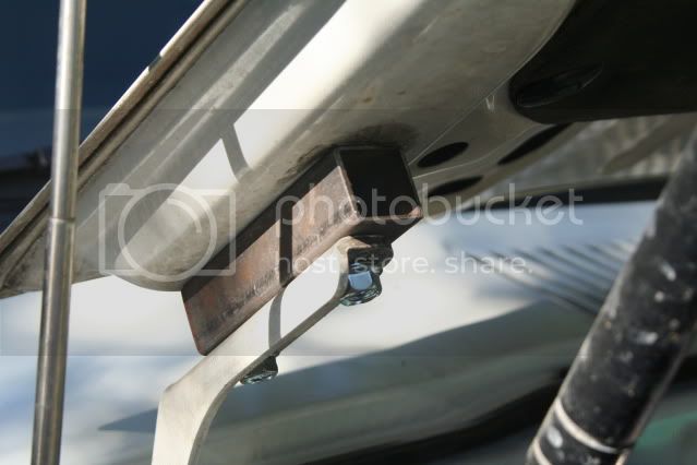

I could not bring myself to cut a hole in my hood so I did this instead
Seems to work very good, not only does the truck run cooler and cool off faster when it does heat up but the :princess: sais her feet are now cooler also!
Easly reversable in the winter too.:bounce::bounce2:

There is one major thing I dislike about hood spacers (other than the look), and that is if you get any sort of smoking from your engine, you're essentially blind.
Additionally you'll get any smells into your vents. Considering how much these trucks tend to stay "well oiled", that's pretty often...
I have been running these spacers for a month now an have not noticed any new smells even when I blew a power steering line and sprayed power steering fluid all over. It would require a lot of smoke to blind a person and I have not heard that as a problem with the thousands of cowl induction hoods on the road but I hope that will never be tested and like I said I only need to keep these in for two or three months out of the year.
