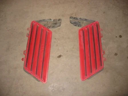

I got these Z34 Lumina vents off ebay to my door for <$35.
I sandblasted them and painted them to match my green machine.

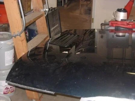

Next I missed out on turkey hunting this morning and was up at 4am anyways, so I decided to cut holes in my hood.
Then I dropped said vents in the holes.
...undershot of the mount (used neoprene washer with fender washers and the stock mounting holes on the vents with black RTV).
Finally, I reatttached and realigned my hood.

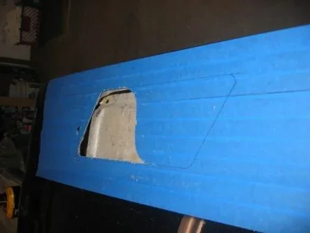

What did you use to cut the hood? I punched a hole with a drill, then I mainly used a jigsaw, but I also used a sawzall.
Did you cut from the top or bottom? Definitely top with the longest metal cutting blade on the jigsaw I could find.
Did you have to cut through any of the hood supports? I got into numerous supports. I did not cut through any entirely. I checked out the stability of the hood with the holes and the vents not installed. It felt solid (no considerable increase in flex). With the vents installed, it seemed stiffer than stock. Many people have voiced concern with this in other threads, they haven't done it, and aside from conjecture, I haven't seen it documented where this has been a problem.
Any damage to the paint? (I see the blue tape.) I covered everything in masking tape. Just outside the cutting lines, I quadruple layered the tape where the jigsaw guide would be riding as right off the bat, it started to tear through some of the tape. No noticeable damage.
