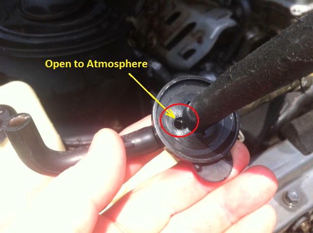

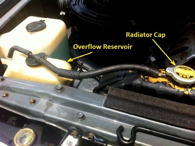

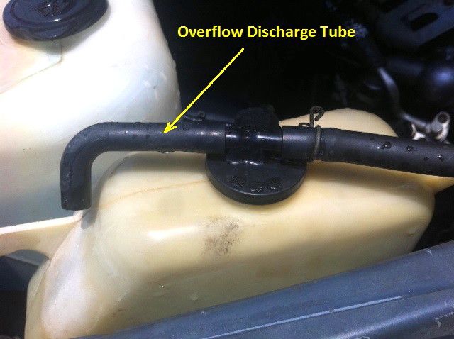

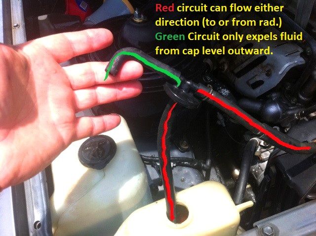

The pics posted below are from my 80 series...but the concept is the same for all 'Overflow' reservoirs (not the same thing as an expansion tank).
The Overflow Reservoir works in conjunction with your properly operating radiator cap. The purpose of the reservoir is to hold expanding coolant (rather than have it dump out on the ground) and then allow it to return to the radiator as the system cools.
Without going into a detailed explanation concerning the necessity and function of a radiator cap, suffice to say it is basically a relief valve (2 way).
When the coolant temperature/volume (related) reach a prescribed level...the radiator cap valve opens and allows the fluid to expand into the Overflow reservoir. When the engine cools...the fluid volume in the radiator (cooling system) becomes less, creating a vacuum. This vacuum draws a certain amount of coolant from the Overflow Reservoir back into the radiator.
This happens in a 'circuit' comprised of the hose coming off the radiator, going into the reservoir cap and then to the bottom of the reservoir via another hose. That circuit is separate from the discharge hose (which expels/purges air and excess fluid). So if you overfill your reservoir when cold and the expanding fluid from radiator travels to the reservoir, any excess will simply flow out the discharge hose since it is open to atmosphere. There is a hole in the underside of the reservoir cap that allows this.
