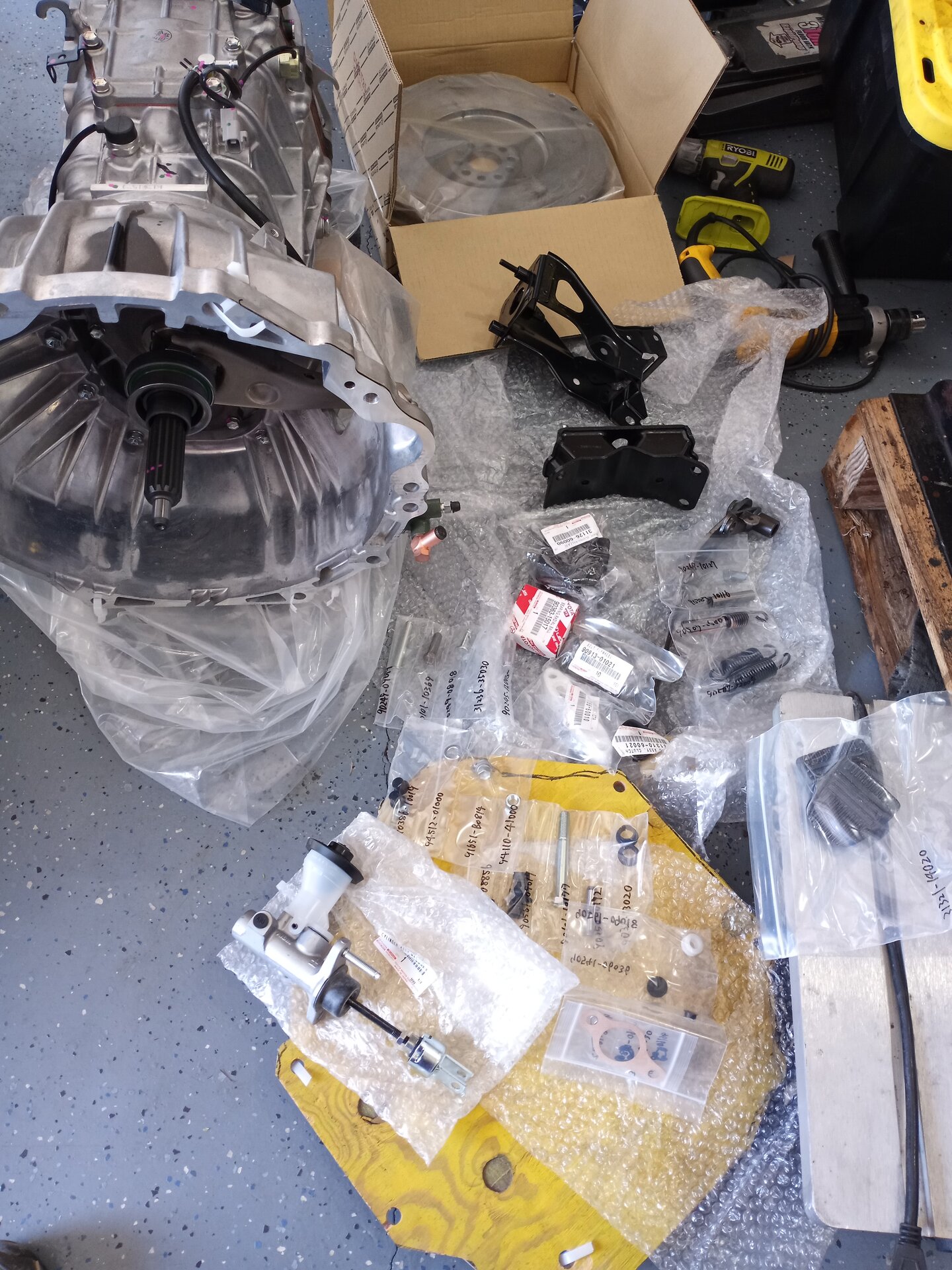

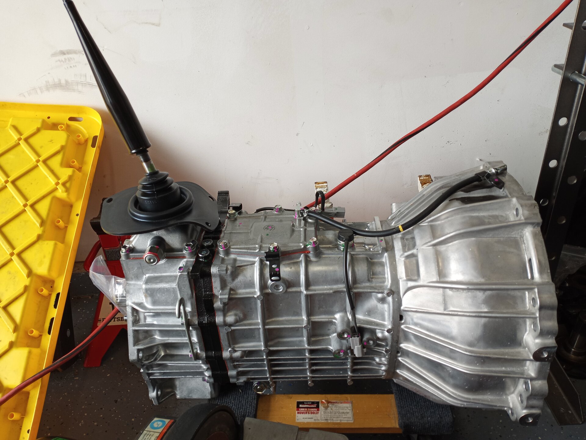

I am in the process of building a 2uz/H151 to replace that previous 80. It has already cost me more than 5k to do the swap. I am doing a motor swap though, so it is going to cost more than just a manual swap.
