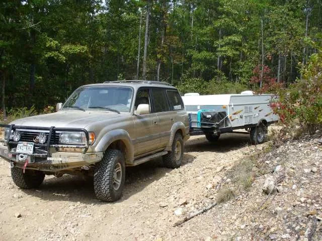

I have the Jayco Baja 10Z and am very happy with it. I haven't really taken it off road except for shrine pass and that was a lot of rattling at the speed I was going. I also took it on the road into Flat nasty to the camp site, but thats not too bad. The only issue I have had was with the sink on that trip, it folds over when stowed and is held together by staples which came out. I simply used good as nails around the whole seam and then put it back together and that works great.
It does ride better with the shocks. I elected to get the unit without the bathroom or shower. Can't see sitting in the popup going to the bathroom. I bought a shower tent and can use it for a portapotty or for a shower. Then you just throw away the poo bags and don't have to worry about cleaning anything. I bought a hot water shower system.
It was real comfortable for a week in Moab last year. I have the NASA foam on top of the mattresses and its great.
I also have a 4000 watt generator bolted to the front deck so I can have my cup of coffee or even use the microwave when in the boonies

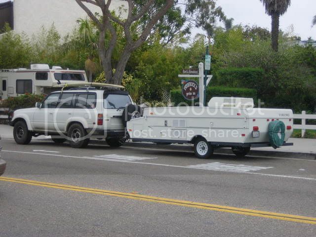

So here's the old girl. Maiden voyage this last weekend was easy; a trip up to Carpinteria, a crowded suburban beach camp with hookups. Met my family, so my dad and brother could help out with setting up and testing equipment.
Few hitches at first: couple of plumbing leaks (minor), and one of the conduit bed supports crapped out, requiring the crafty use of a picnic table, my Cruiser's jack and some scrap lumber. Those supports definitely need to be re-fabbed in steel. Fridge never got cold. Sink drains super slowly, as there's tons of kinks in the hoses. There's no water heater, so one of those Coleman On Demand water heaters is in order. But the furnace, A/C, water pump, and cranks all worked fine. The porta-potty was great, as I didn't have to wake up to accompany my wife to pee.
I've definitely got a ton of work to do in order to get this thing up to speed, even for on-road adventures. I'll need to take it camping a few more times in civilization and conduct all necessary preventative measures and repairs before I even think of taking it on even the mildest dirt roads. I can't emphasize enough how crappily these things are put together, but for what I spent on it, I can't complain. My brother spent $20k on his toy-hauler, and was fixing leaks and separated body panels all weekend; his best friend has a $35k fifth-wheel and the bumper fell off on the road, not to mention numerous electrical shorts and popped fuses.
I spoke with another guy who had a Fleetwood pop-up. I pointed out the numerous issues I was having, and he pointed to a 4x4 Sportmobile van and said "That guy's rear tire carrier fell off at Pismo, and his solar system hasn't worked in a week. He spent $80,000. My Fleetwood has a problem every time we go out--I carry a bunch of tools and spares, liquid nails, duct tape, written instructions detailing things I've re-worked or fixed, and lots of patience. RV maintenance requires zen thinking." He added that before a trip, I should print a list of all the nearest RV supply houses in the area of my destination. "You'll get to know those people by name."
Bottom line is I still had a great time. And it sure was nice when things got chilly to crank up that furnace and not worry about the baby being too cold. Changing clothes standing upright, plenty of privacy, and some damned comfy beds. I think I could get used to it...once I work out the inner turmoil.
