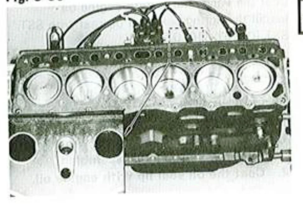

The head gasket technically can fail between two adjacent cylinders or between one cylinder and the water jacket. Only the latter will cause water to end up in the oil. You can seen in this picture from the FSM how close the cylinders are and how thin the gasket is between cylinders 3 and 4. You can probably check by taking out both spark plugs and blow compressed air into one cylinder. If it comes out the other, that's an indication that gasket between the cylinders is blown (this is similar to a cylinder leakdown test).
That makes sense. I went ahead and took the cylinder head off, I figured I'd need to rather it was the gasket or not. It most definitely was, it was completely missing between those two cylinders.
I'm going to, check for cracks, for warping, and the cylinder seating. Hopefully the gasket is all that went wrong.
