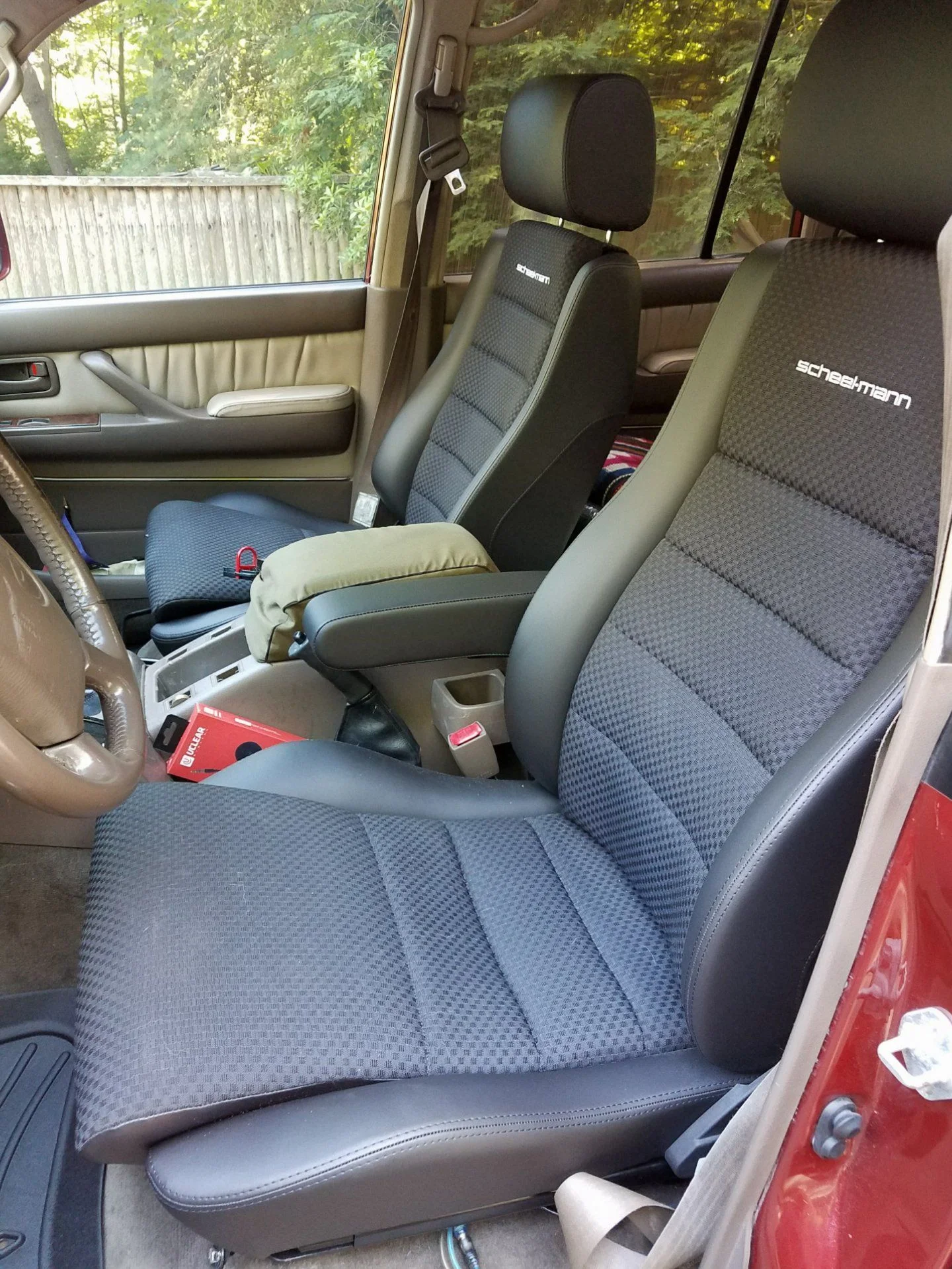

It took about 4 weeks after ordering to get the seats from Germany to Oregon and then a week to get them to me. The seats came wonderfully boxed with all parts needed included.
I tested the fitment of the planted brackets and they were perfect.
Next we follow the directions that are included with a web address that outlines the install
We then install the bracket covers and adjustment knobs.
Next comes the slider rails if you so choose to have them, which I highly recommend. In the full rear position, I cant even touch the floor.. This should give you big guys a great bonus.
Next comes the Drivers Side Arm rest and headrest...I recommend that you leave the headrest out until you get them mounted in the truck.
Finally, mount the planted brackets to the seats "Before" you install them.
Repeat for the other seat and your all done.. Took me about 3 hours.Unfortunately, now I need to recover the center console and change out some door accents..
Time to enjoy!

@Overland Tailor those are gorgeous. I got a pair from Toby that he was letting go, but my choices were black, black, or black. Envious of the combo you decided upon, those are sweet. Excellent seats overall, and Toby is patient and informative.
I had the same problem, my back and hip suffered a lot in the stock seats. I didn't know what to do, don't have fab capabilities and don't have a local pick and pull. The new seats did the trick.

Nice to see another set of Scheel-Mann Seats. The black is sexy..
