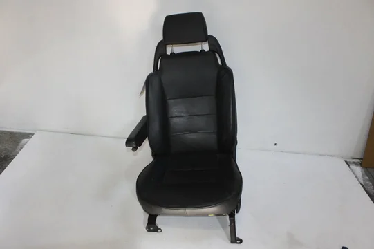

This subject has been covered many times, and I have brought this up before. I have recently had a little more time to dedicate to this project. The issue is this, most of our seats are showing their age, and options for a replacement/upgrade are currently limited. I have chosen the LR Discovery seats for a reason, mostly being that *typically* they are purchased by people who take care of them, and they die a Land Rover style death before the seats are gnarled. The problem with other Toyotas are by the time the Yota is dead the seats are roached, and they hardly ever make it to the JY. Discos on the other hand are always aplenty. Now some additional benefits are:
ARMREST
Did I say ARMREST?
HEATED SEATS w/ module built into seat(without the module the system is useless, points for integration)
Flush bottom (after bracket is removed) 80s need the clearance under the seats.
6-way Seat Adjust, controls not on seat*
Pretty cool looks for a seat
ARMREST
*I actually think this is advantageous, even if it does mean some extra wiring. Reason being, most seats we have looked at are too wide, the Discos work, but once you have the controls down the side, if the seat is too wide you'd have to open the door to move your seat. PITA. Discos are built into the center console, I plan to use the coin blanks in the 80 center console for Heater ON/OFF and 4-way seat adjust. This has an additional benefit brought up by @NLXTACY with one of his inventions (not to steal bread from your plate), but you could adjust both seats from the center console.
As has been mentioned before, 80 Series have a narrow seat track, and the feet of the Disco in no way match the 80. What I am considering is fabricating and selling an adapter which removes the Disco Track, and bolts on the 80 track, then bolts directly to your floor using the Yota bracket. As mentioned, I plan to figure out all the wiring, but that would be up to the owner to do individually for their adjustment and heater.
So, with Recaros being $400-600 (no ARMREST) and the bracket another $60-75 PER SEAT, would this option be of any interest to the masses? Pick-n-Pull usually charges $35 per seat, my target depending on materials and tooling required would be $60-$100 per seat. Assuming you find a great pair at a JY, this would put you at about $300+/- for both front seats, or half to a quarter the cost of Recaros.

What I have been going off on the my sketchups are full power Disco II seats to my manual FJ80 seat. However, given how the 80s seat rails just bolt to a flush plane and essentially the Discos (with the bottom feet plate removed) do as well, its essentially an issue with fabricating a bracket to match the holes up. I need to have a look at a power slide 80 base, but in my mind, this bracket leaves the buyer to "choose their own adventure". The Disco bracket will have a built in screw-drive power slide, which will in turn sit on top of the 80s power or manual slide. Personally, I plan to not use the power Disco slide, and use the manual 80 slide; BUT I can hot wire the Disco slide if I want a "seat extender". I would say the same principal applied to the 80 power slide, where it could be used to tweek the final seat range. I see no reason why anyone other than some Harry and the Henderson size would need to utilize both slides.
I would honestly prefer no power, and adapt a manual recline to the Disco seat, but keep this in mind. Like most high(er) end import vehicles, they typically import the nicer tier models, so there are not a lot of Discos out there with manual seats, and less common with armrests. A note on the armrests too; They can be added to seats without them. There is a capture nut bracket under the leather, the armrest is screwed into this via a bolt attached to the arm rest. This info might be useful if anyone needs to combine a couple seats and armrests from the right donor vehicles.
I will agree that the adjustable armrest is amazing. Wish we could just have a bolt on kit for the Land Rover armrest in the Land Cruiser
I attempted this route, but the bracket with the capture nut is welded to the disco seat frame. Ultimately, pulling the disco seat to cut the bracket and welding it somehow to the 80 seat made me realize, just take the whole damn seat. My coils are poking through my seat foam anyways.
