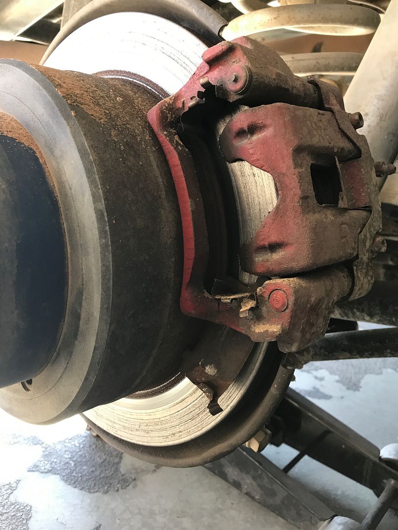

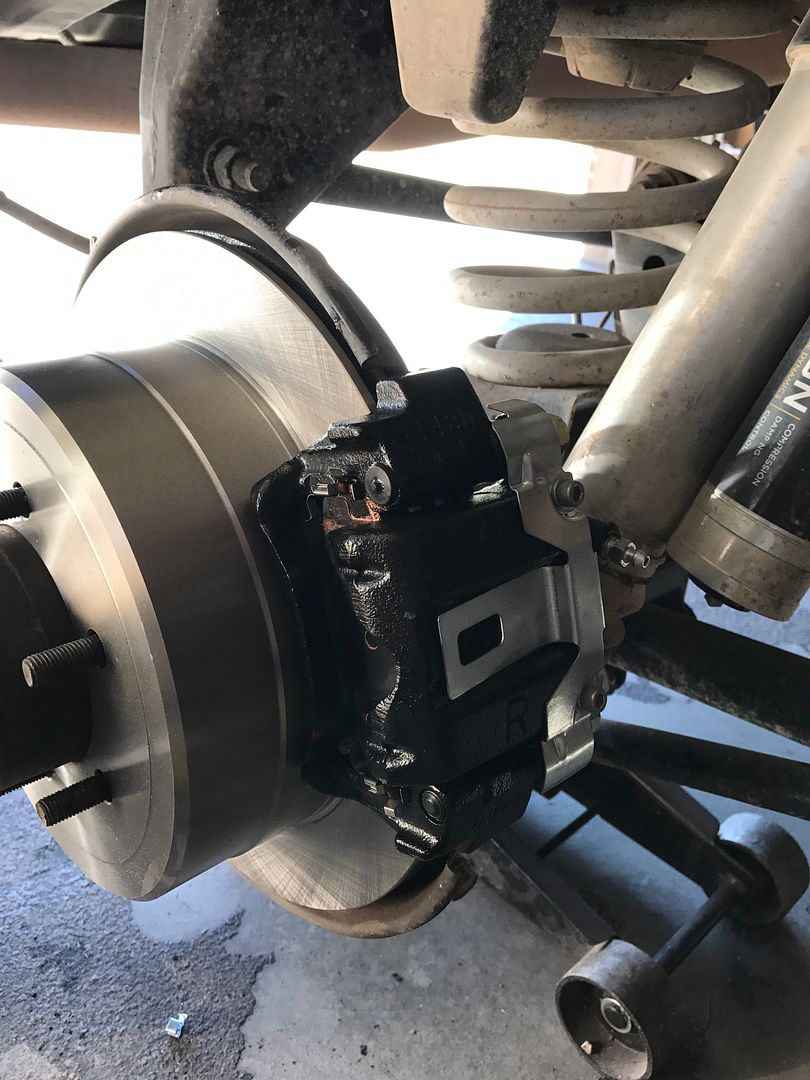

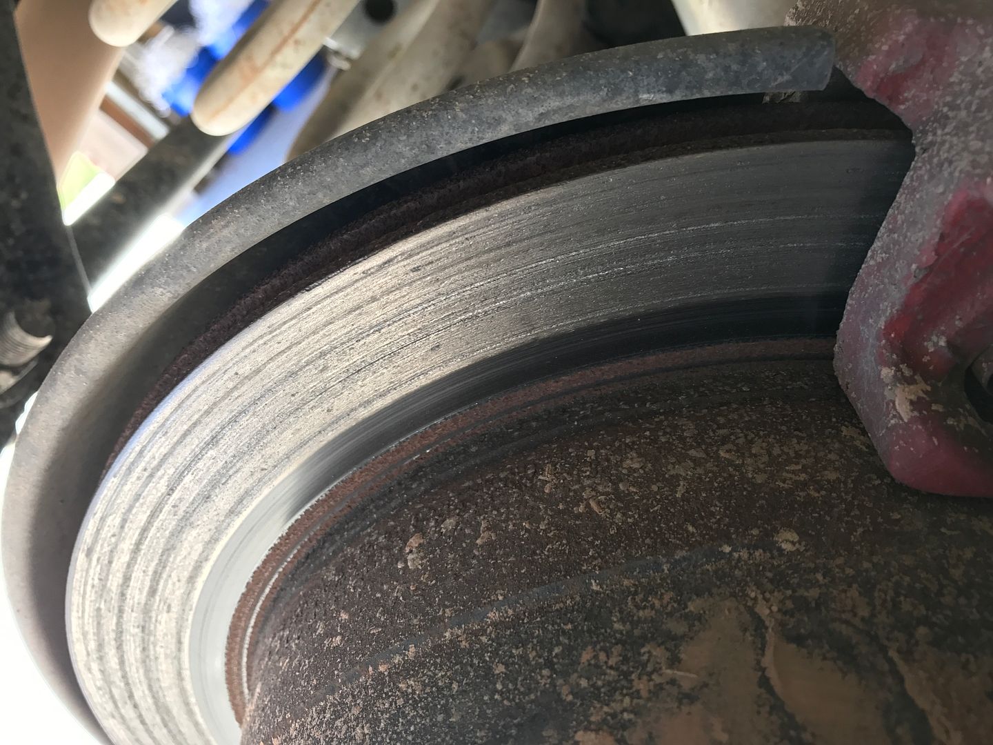

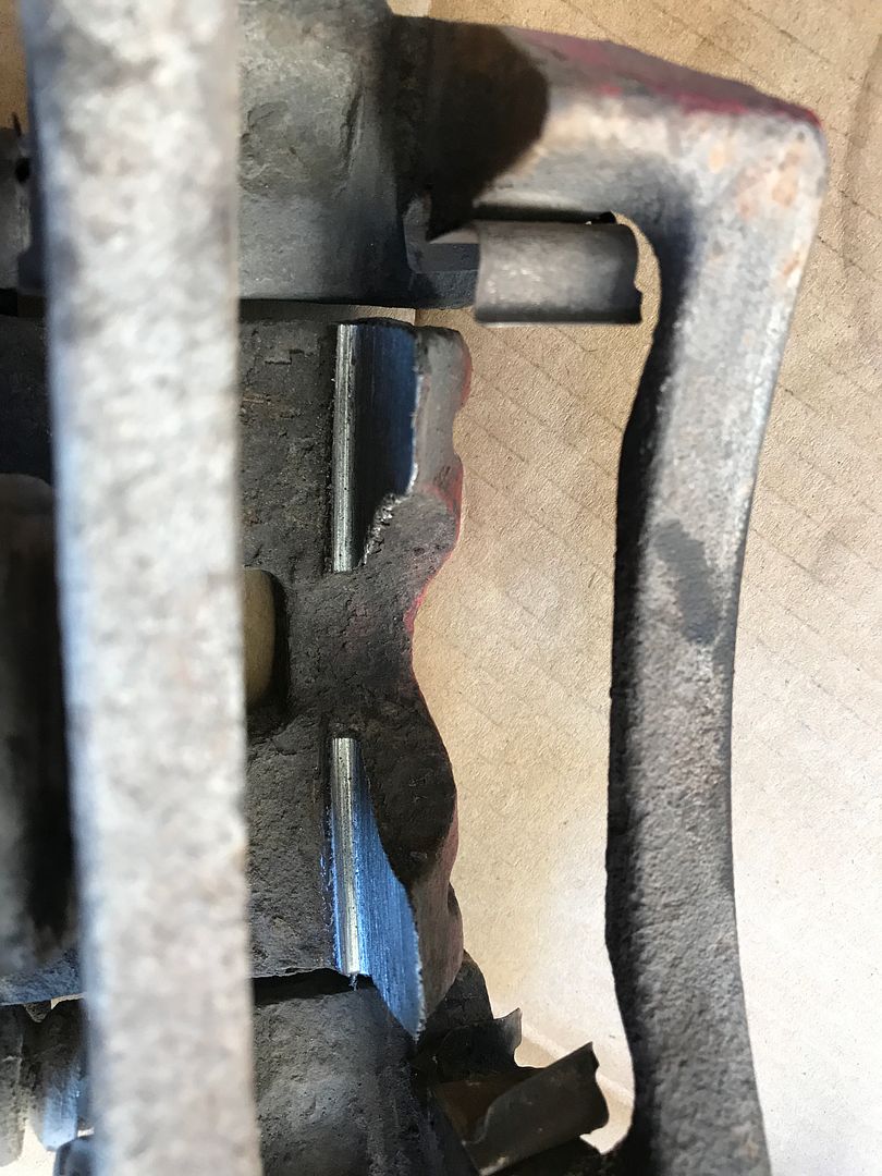

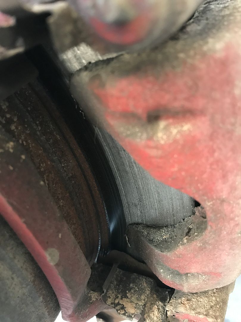

Took a trip last week that covered 700 miles of dirt across Utah. On the way home one of my rear brake pads shattered and came out of the caliper, leaving only the backing shim. The pads were not worn out so it was a bit of a surprise. Didn't see it until I got home. Didn't hear it over the noise of the truck. Destroyed the rotor and the caliper. Got it all replaced on Saturday so all is well now but kind lame. Never had a pad shatter before.
Carnage pics

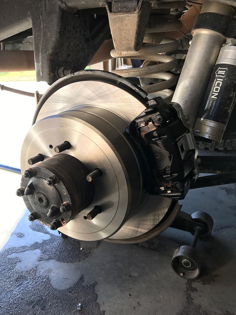

New parts.
Isn't there pins holding them in?
