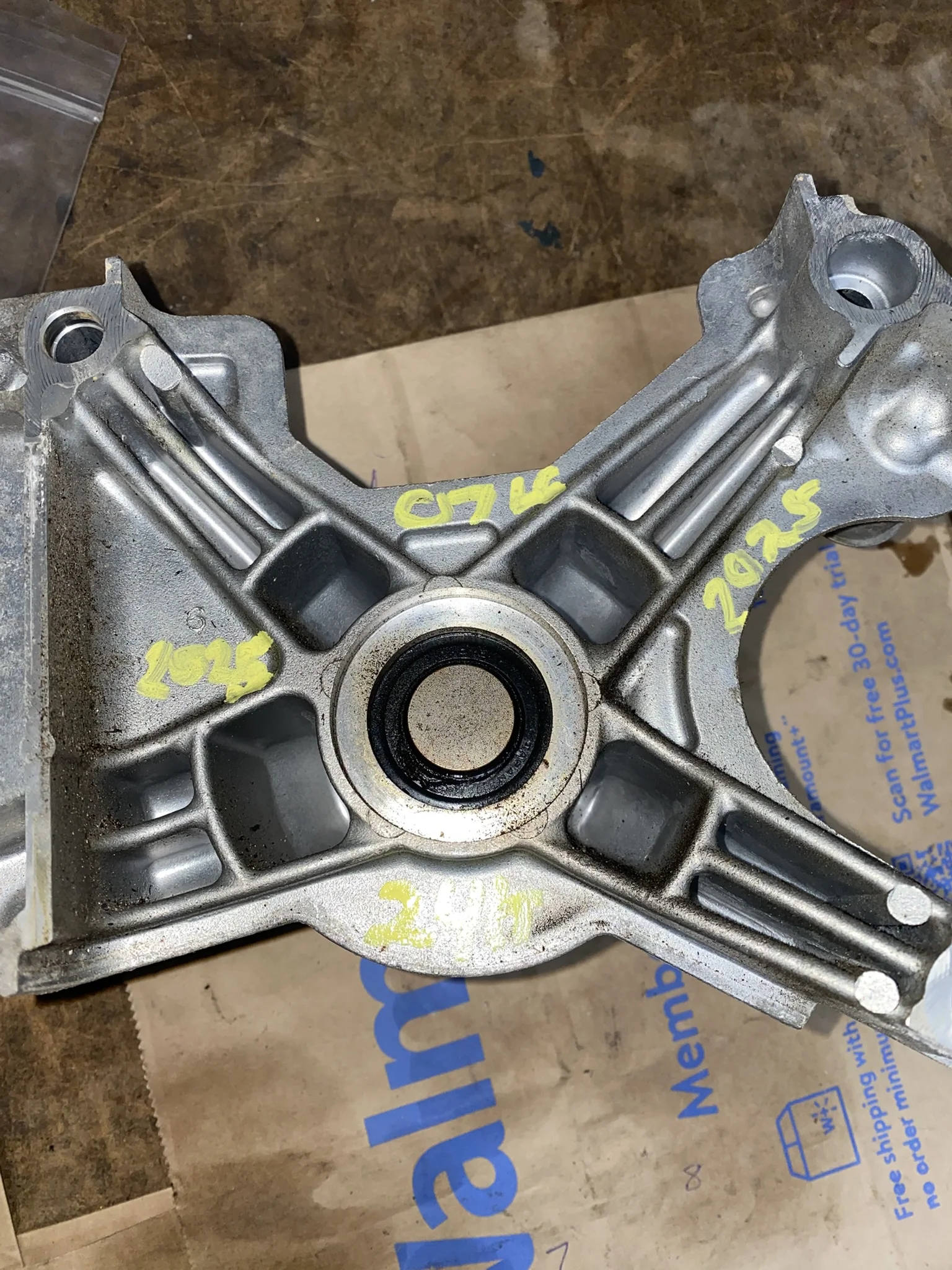

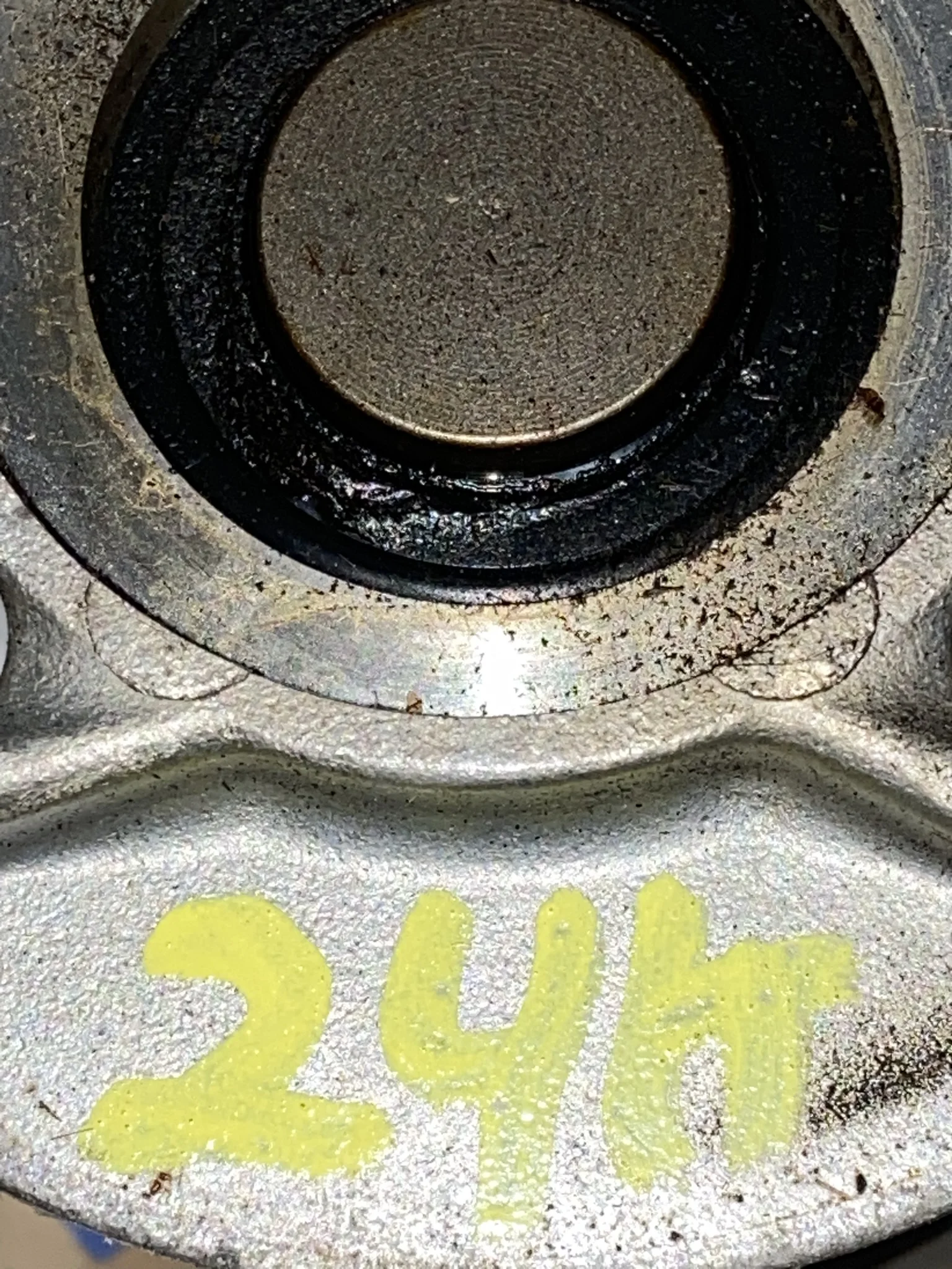

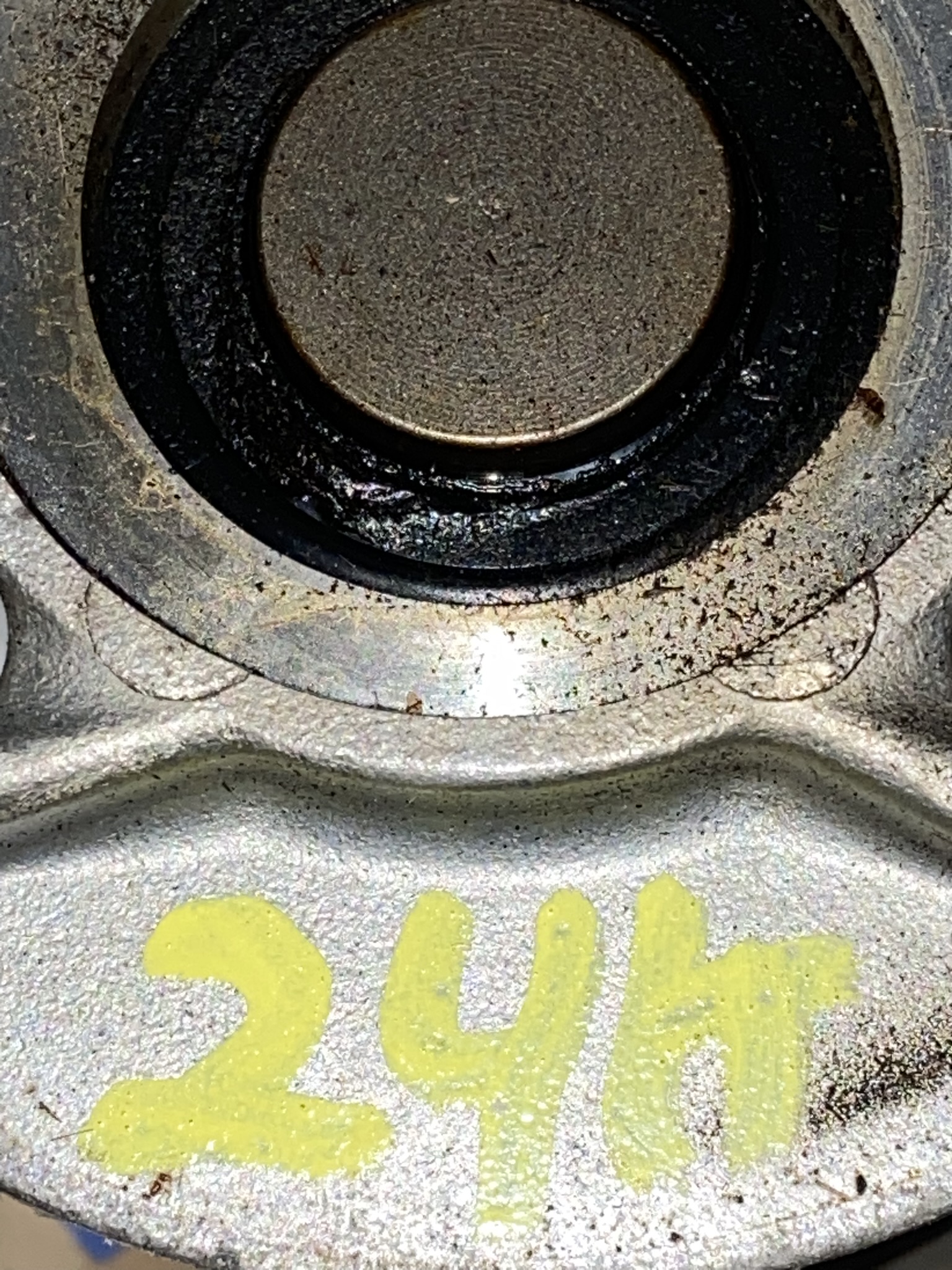

Factory installed fan bracket with ~18 years and only 24K miles: FSM states: Any oil seen at back seal, replace fan bracket.

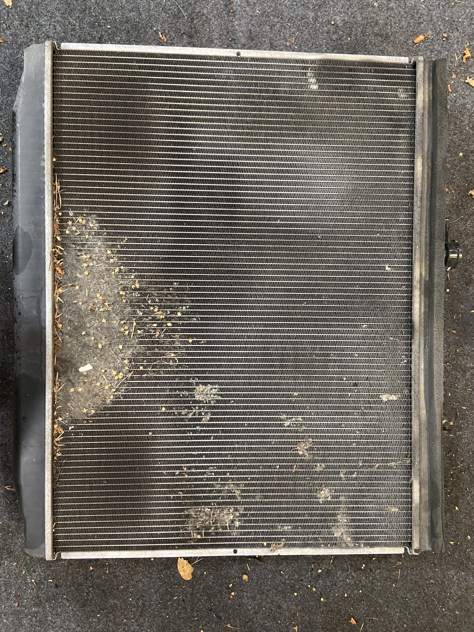

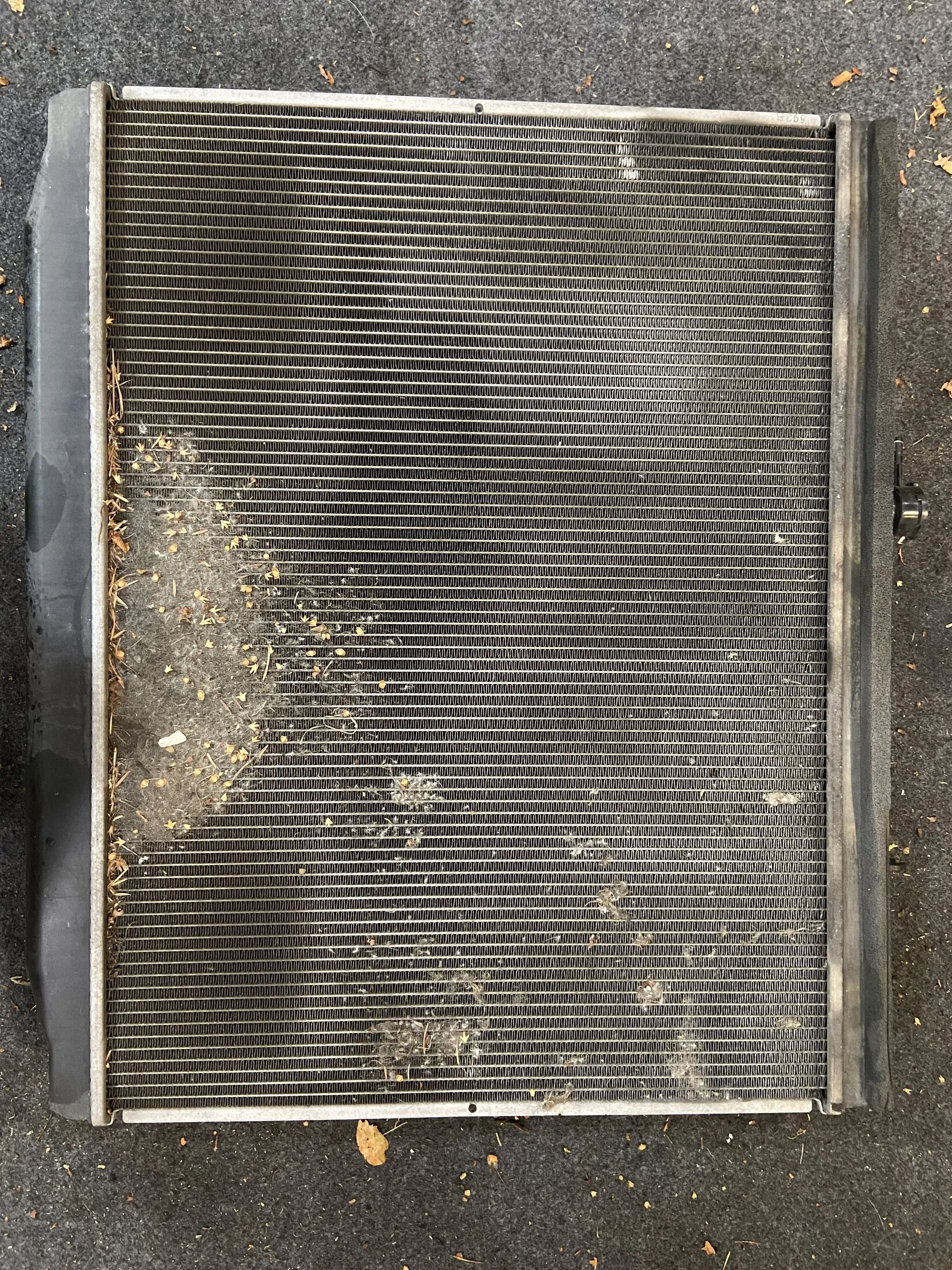

This is the old radiator, forward face. That debris is what was left over AFTER I attempted to clean it in place when I got the truck. 😬
