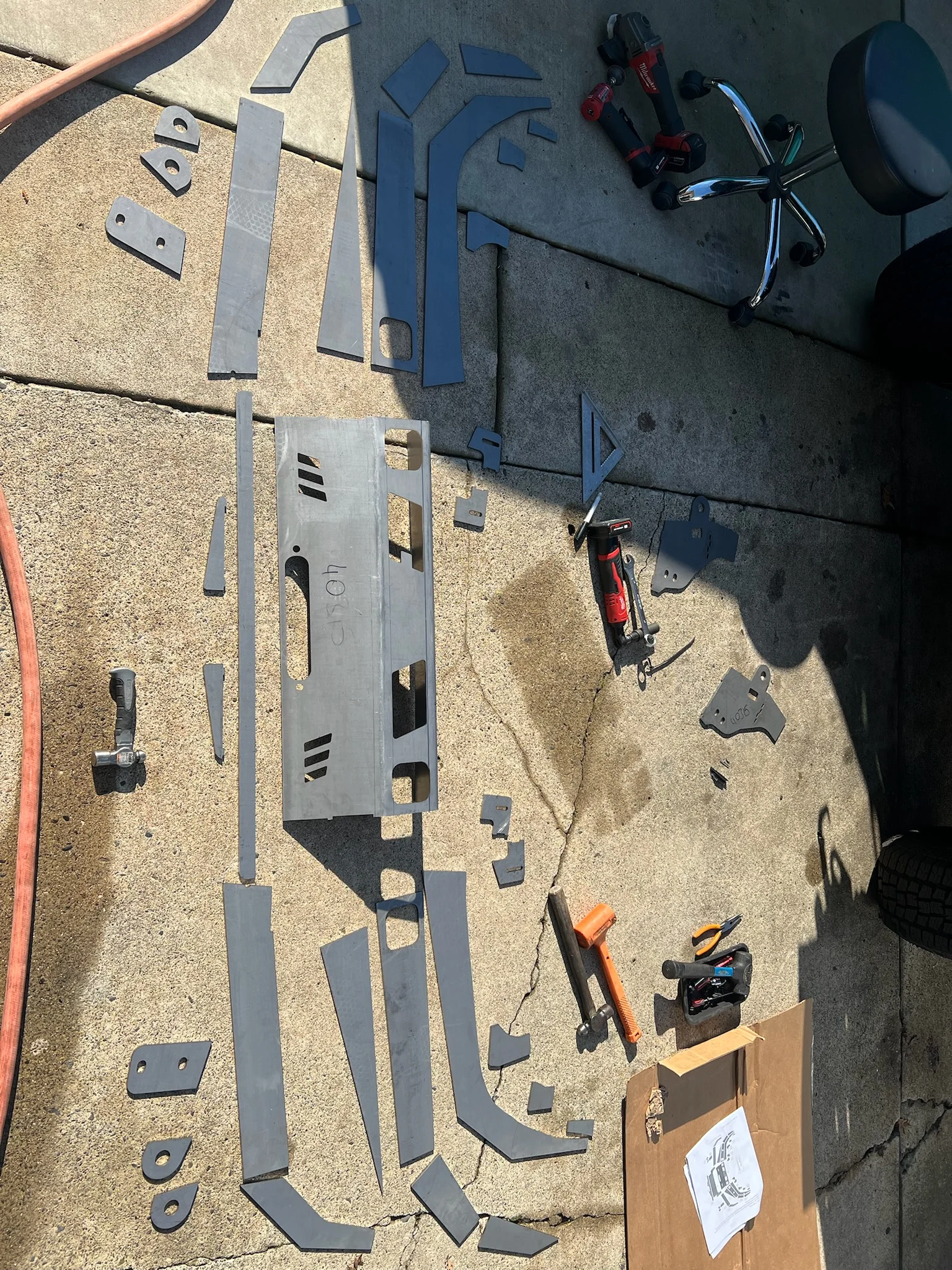

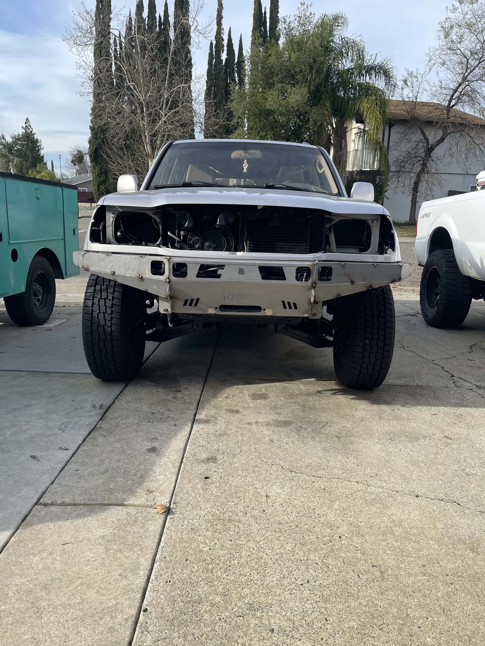

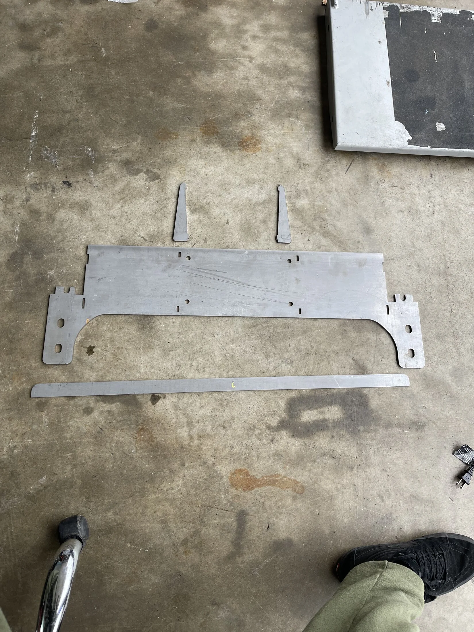

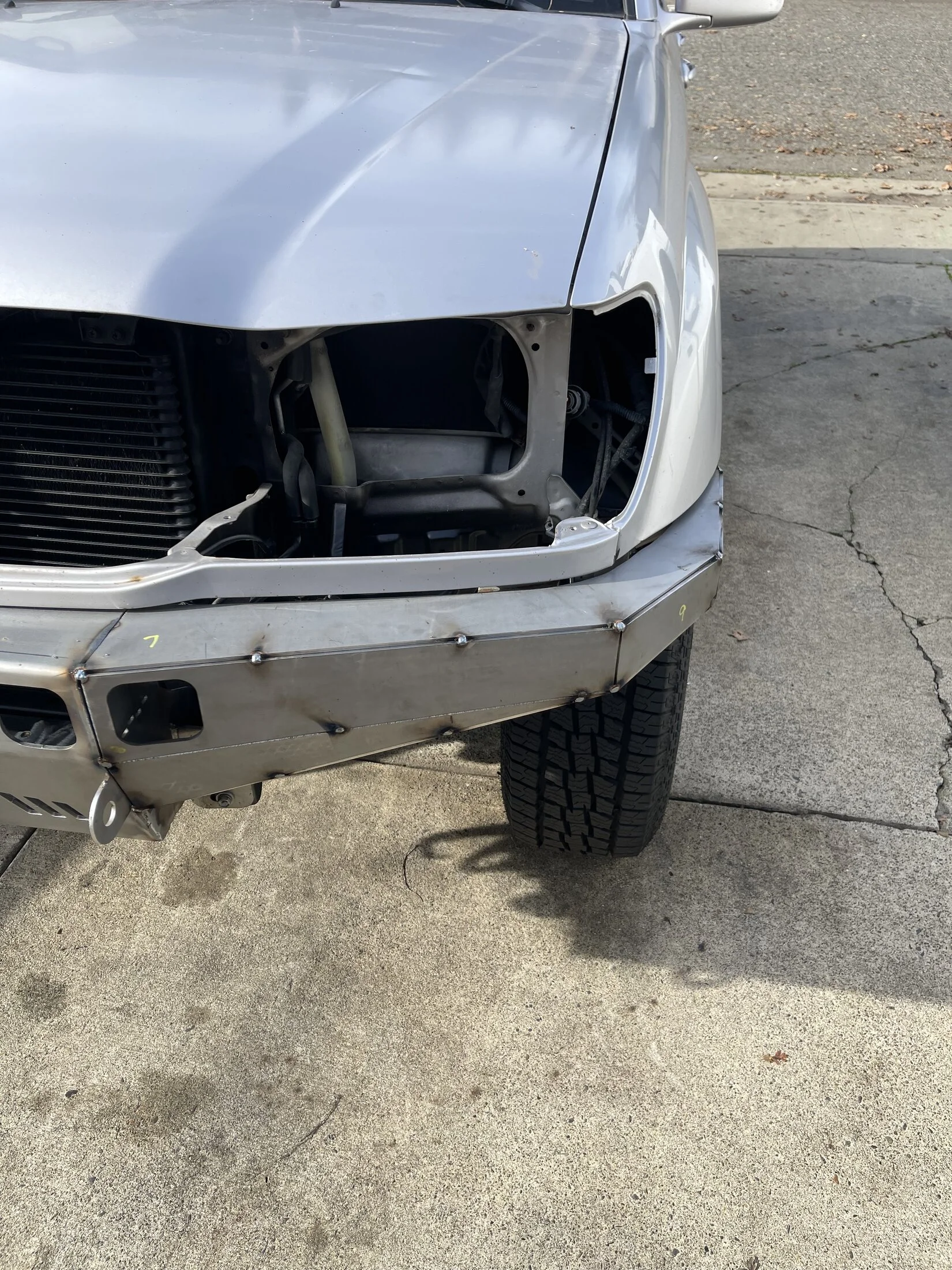

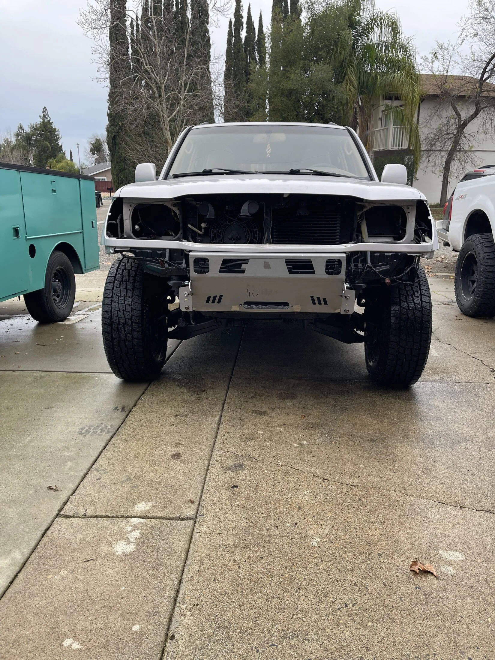

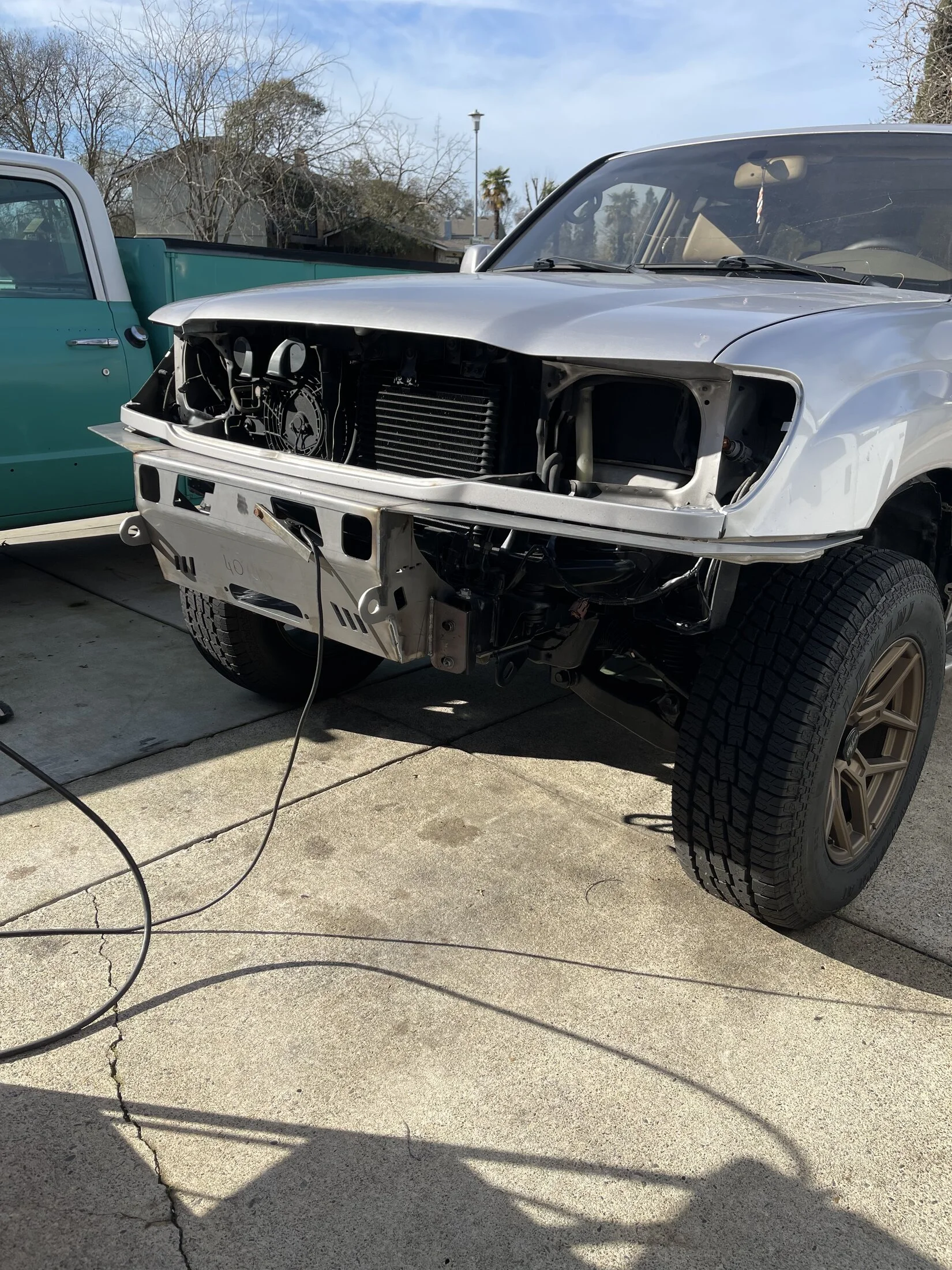

Welding up a Coastal Off-road bumper kit this week for the cruiser.
I will get the rest tacked up tomorrow and pull it off for final welding. Love the kit so far. Comes with great instructions and the design is solid 👌

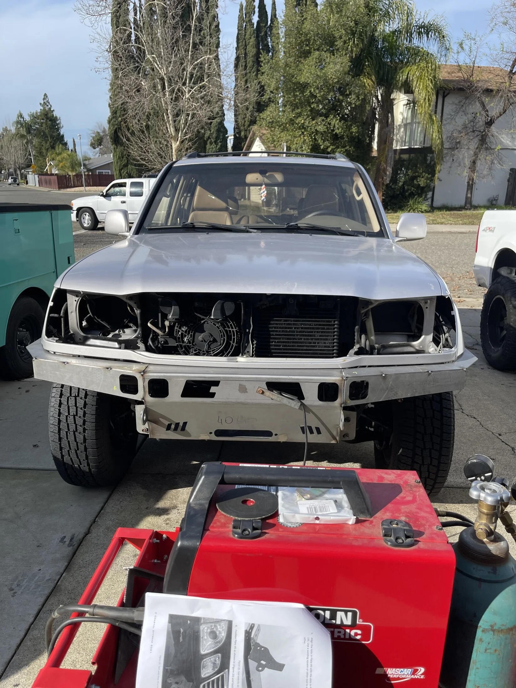

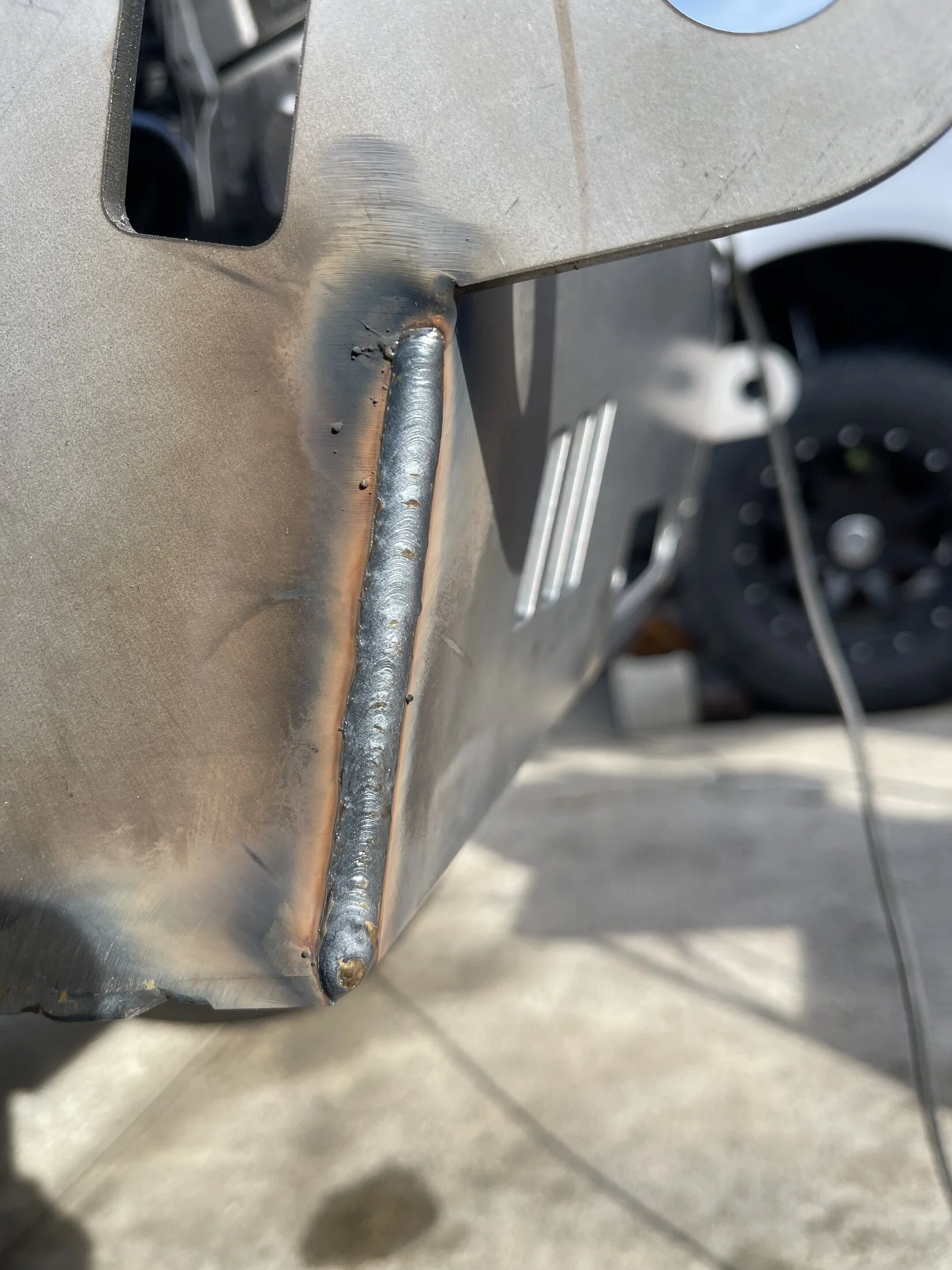

What size welder are you hitting this project with?
3/16" is a bit thick for the little Miller 125 at the shop I now work at.
Back home we had a massive 250 amp that did it all.

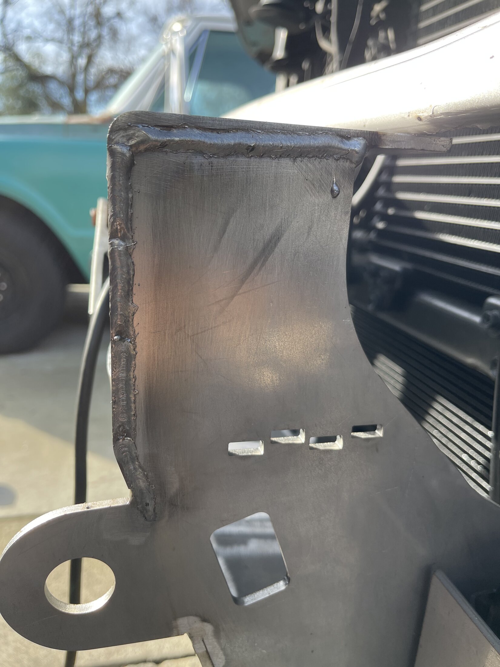

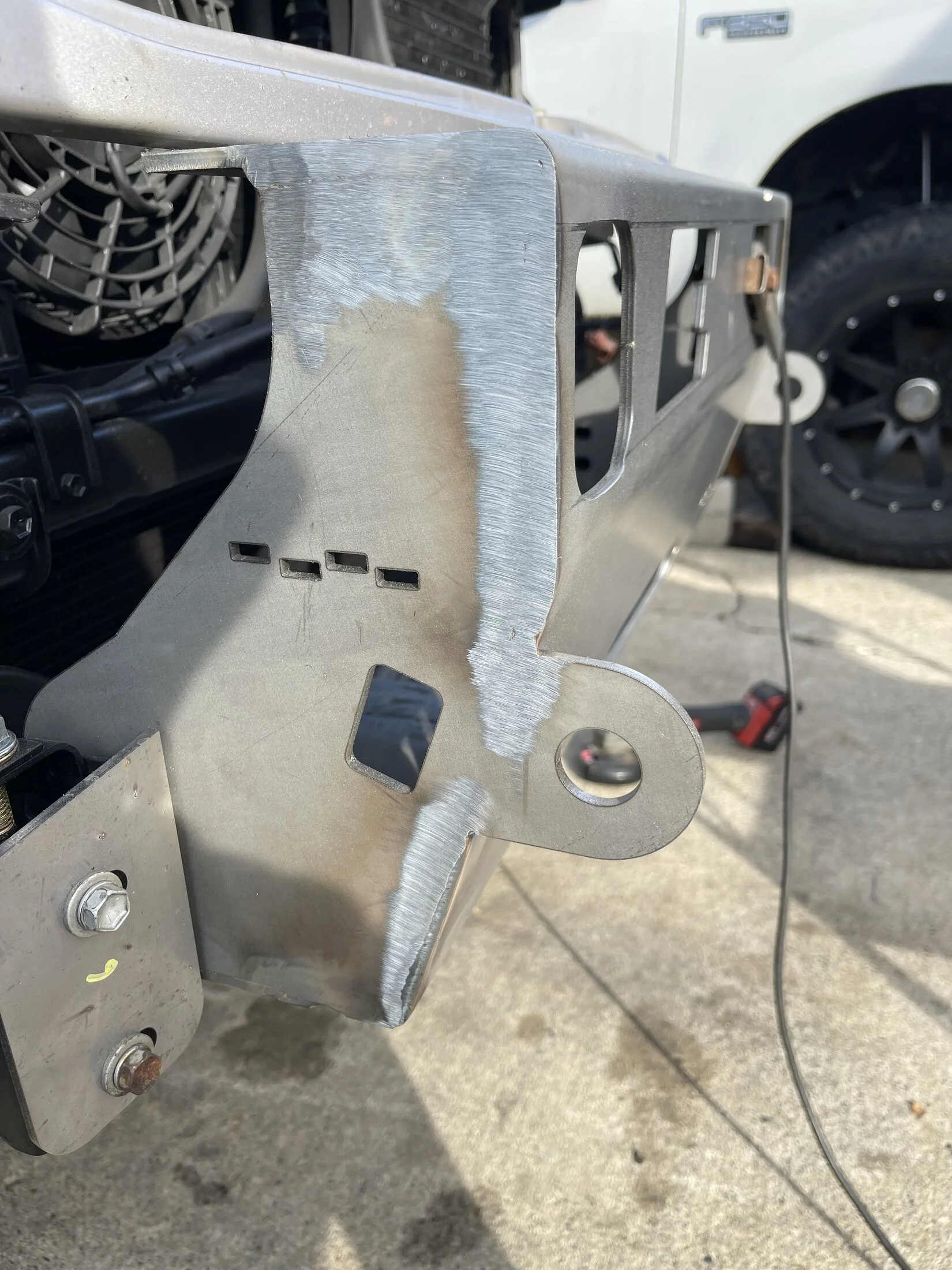

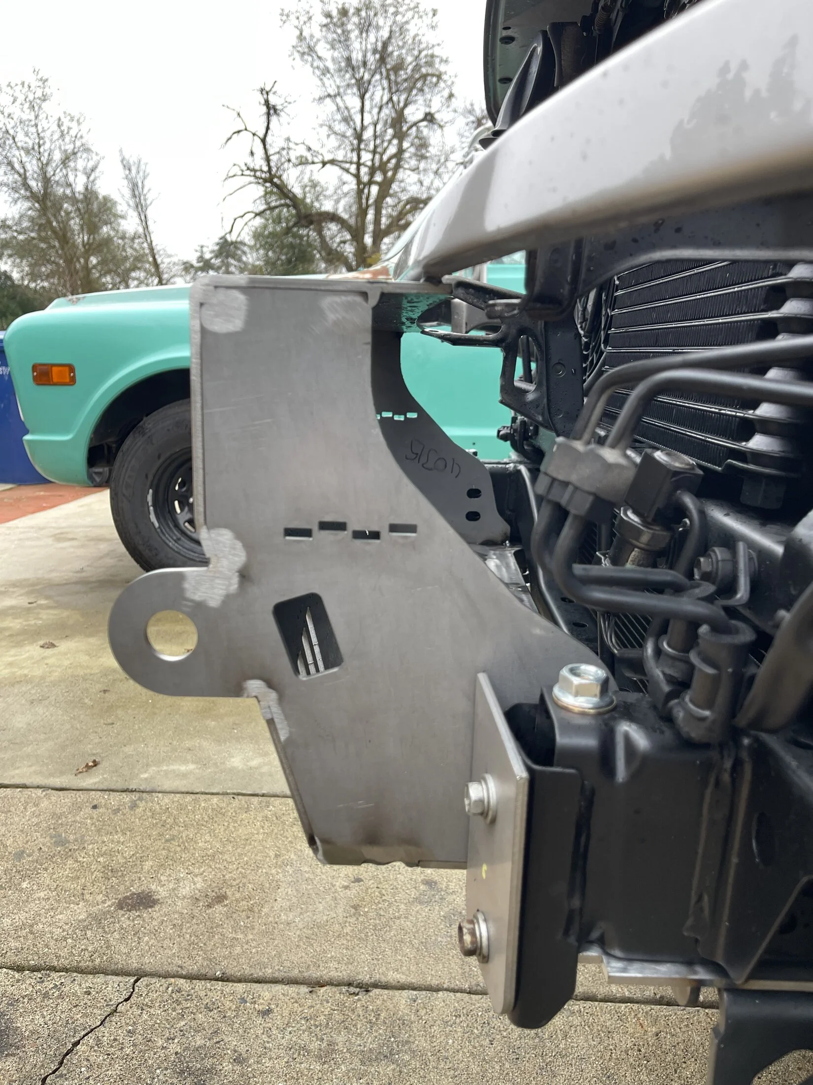

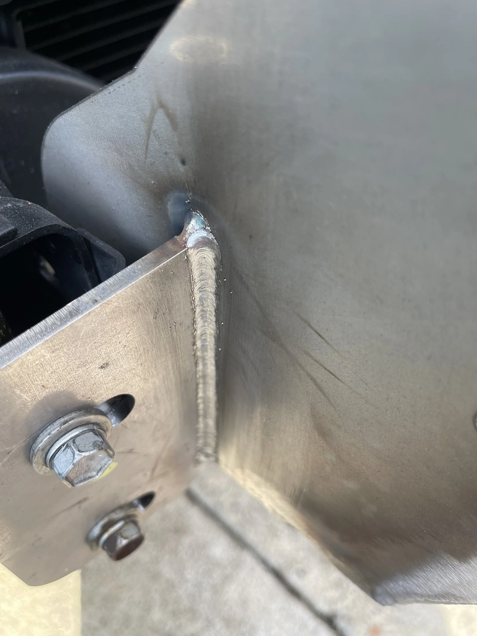

Cool to see one as a puzzle. And for the welder, I know you said you're just tacking, but a couple of spots where you've ground the weld off, you can see the metal seam. Going to want some more penetration for sure.

I’m using a Lincoln 180 with .35 wire. Voltage turned all the way up.
There’ll be lots of penetration 😉

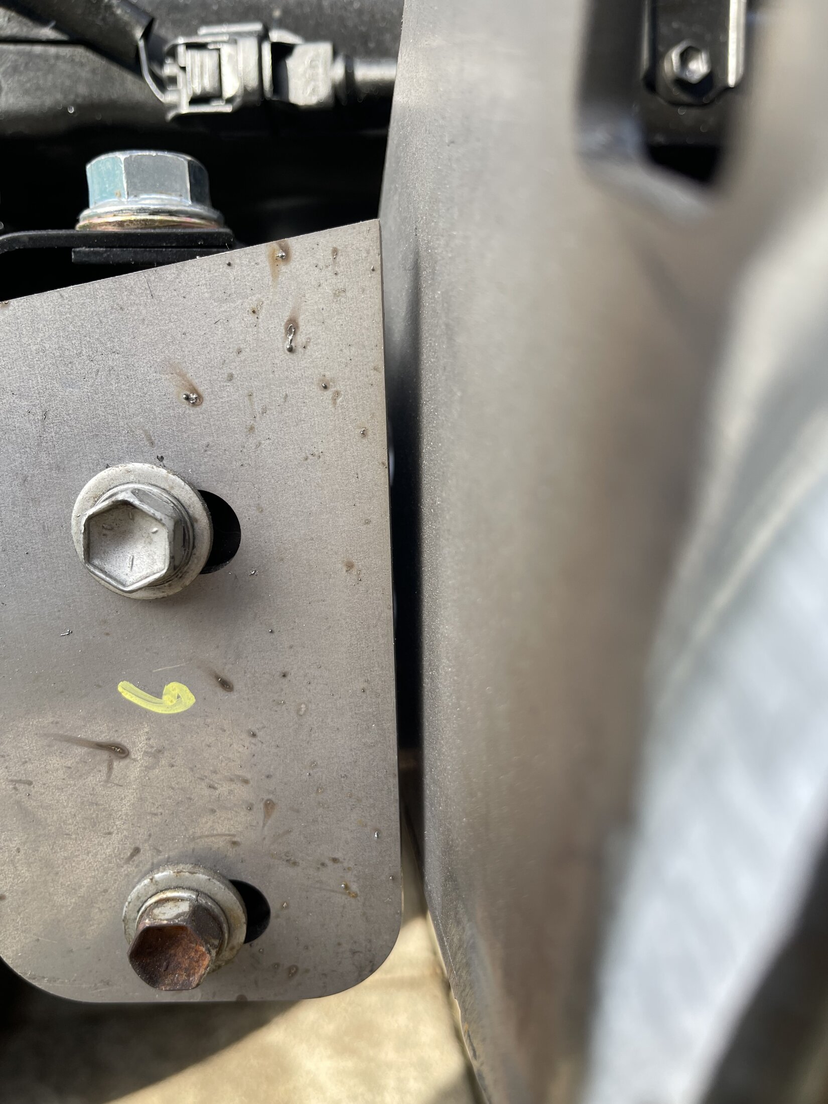

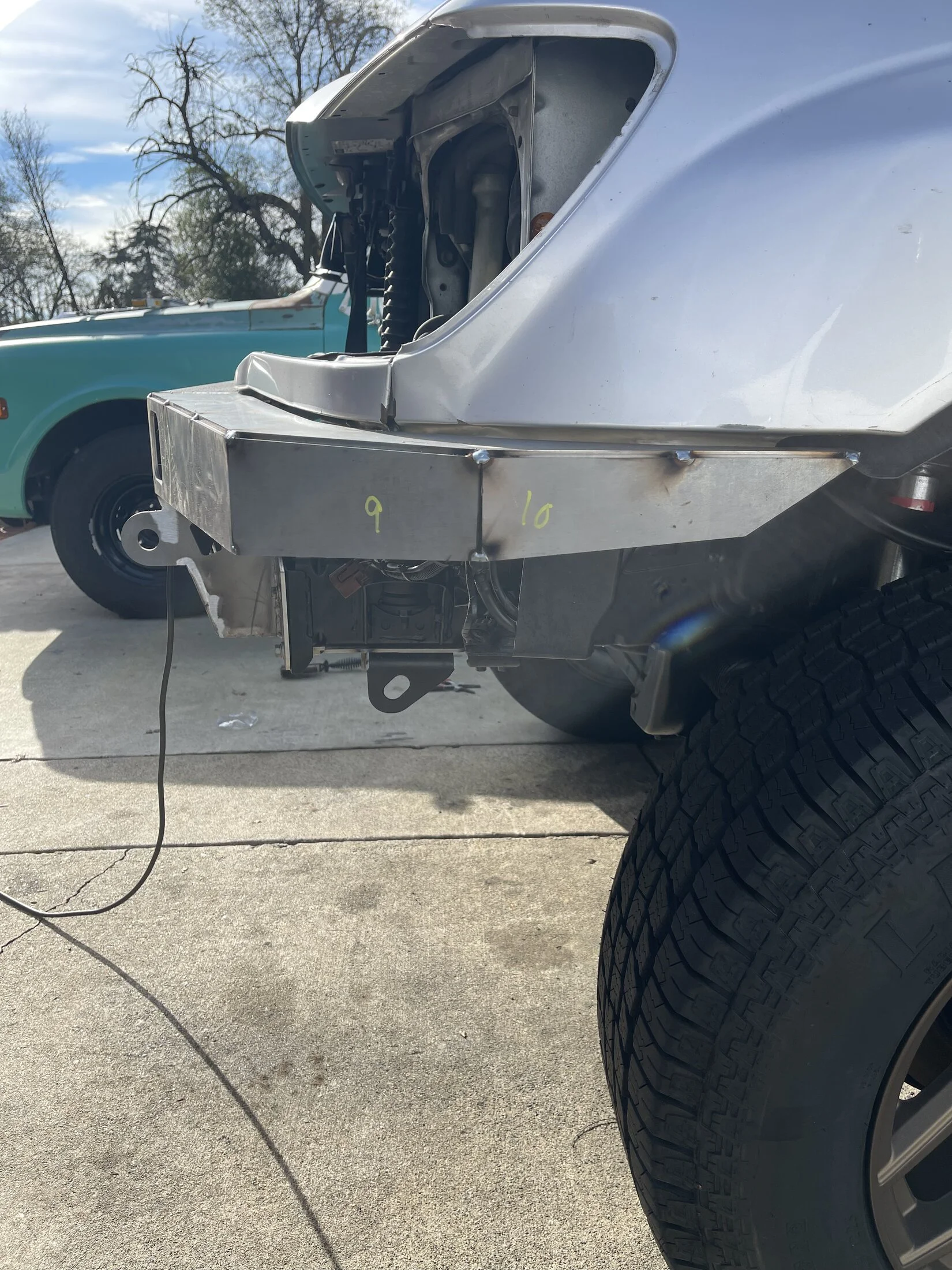

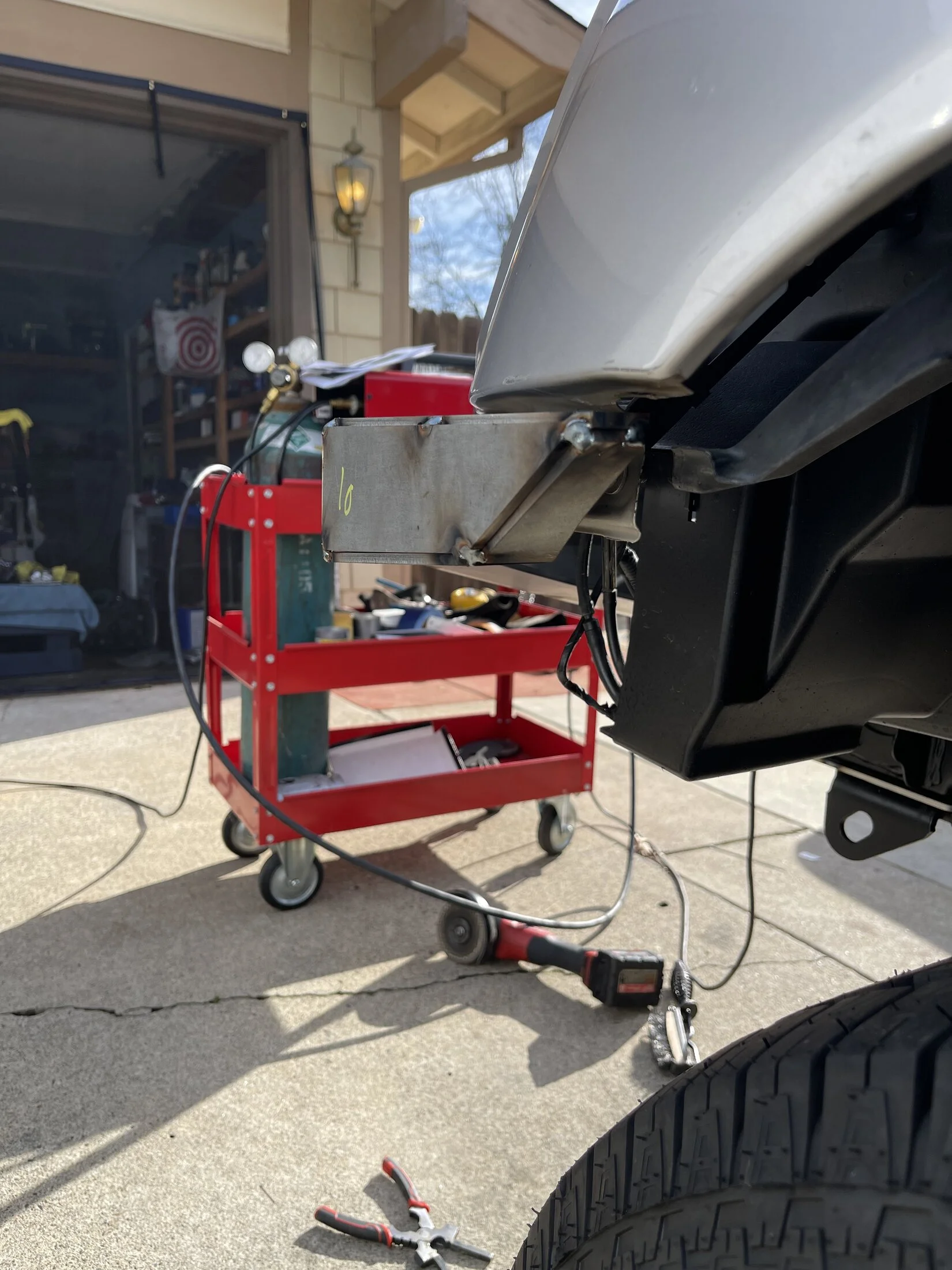

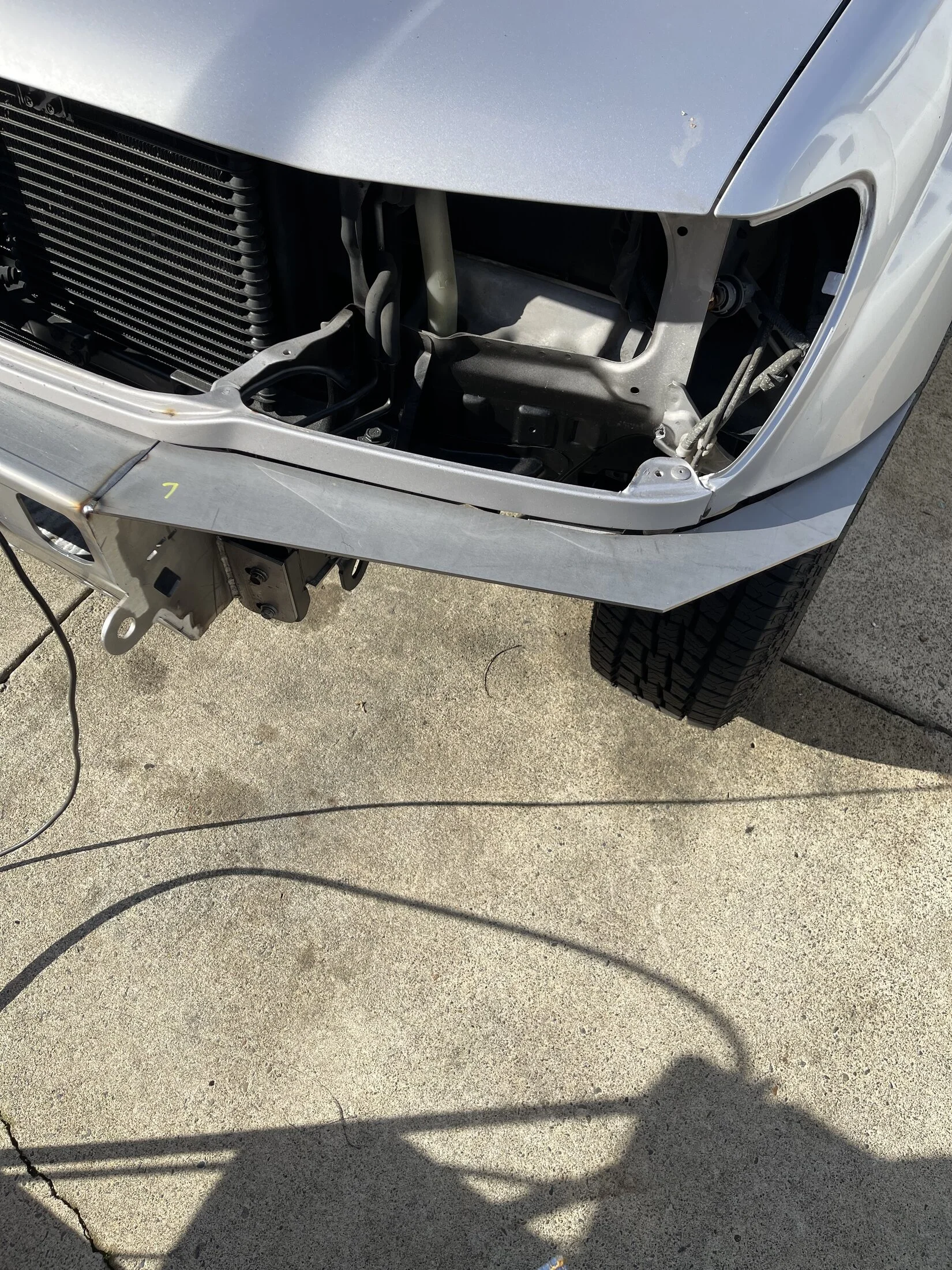

Well just finished the tack up. Took about 2 hours. Very happy with the fitment! I started by back gouging the seams on the center section and welding them because I won’t be able to access that with the “wings” tacked on

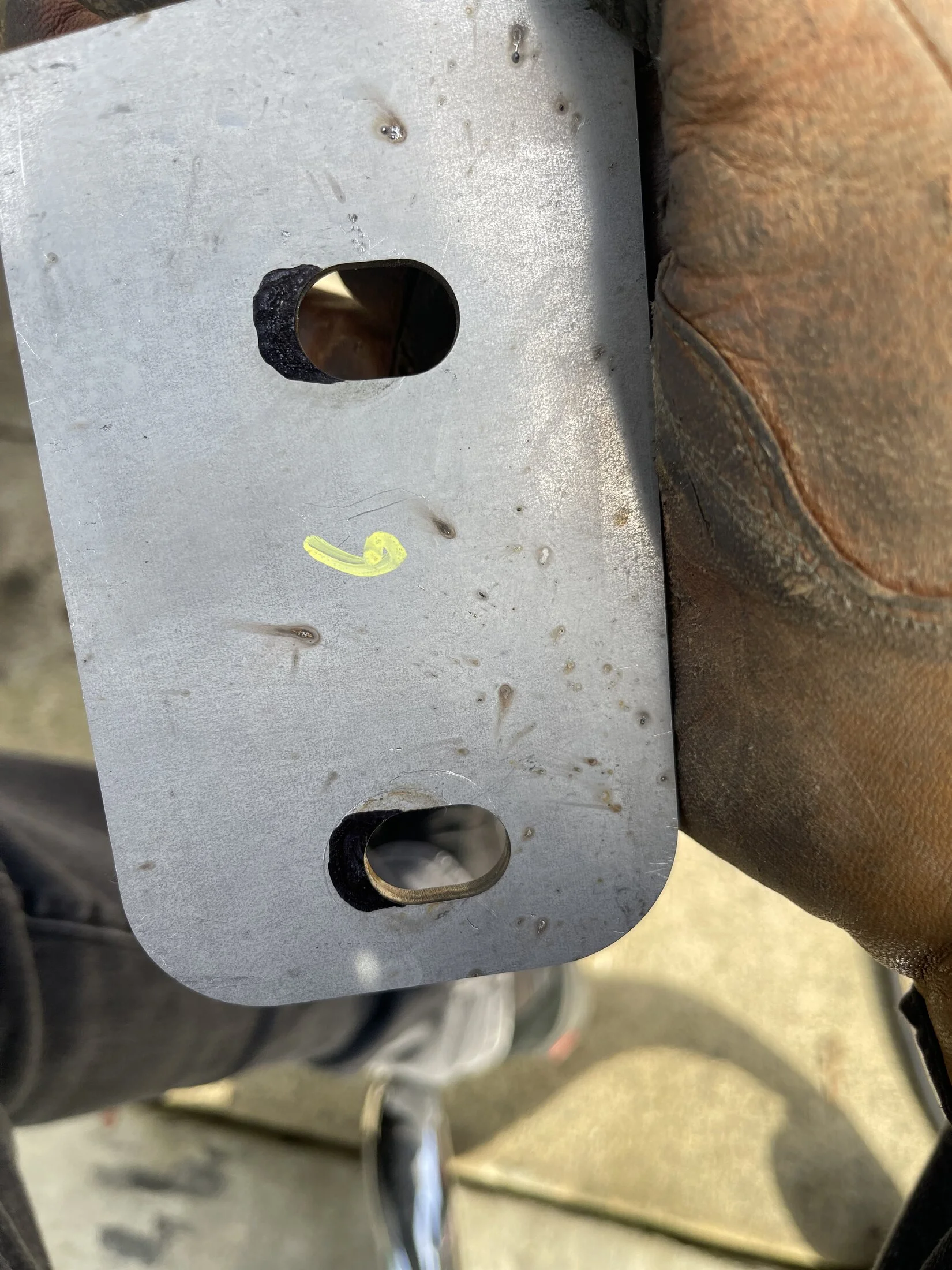

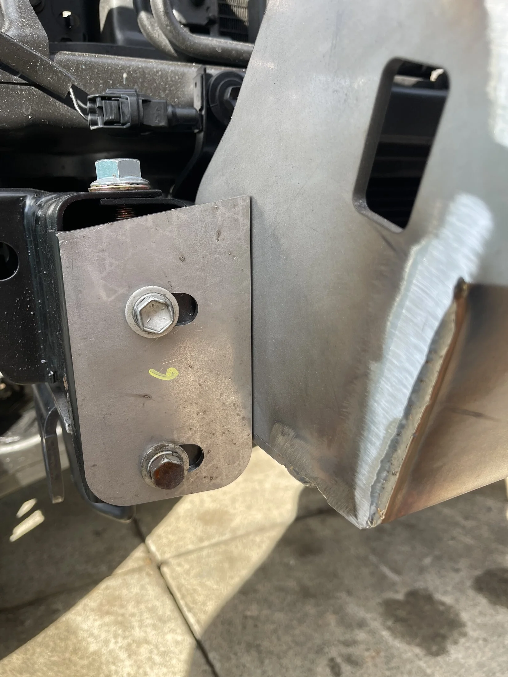

Next I had to elongate the slotted holes for the frame brackets cause they were off the center section at least a 1/4”. Carbide bit on my die grinder made short work of that.
