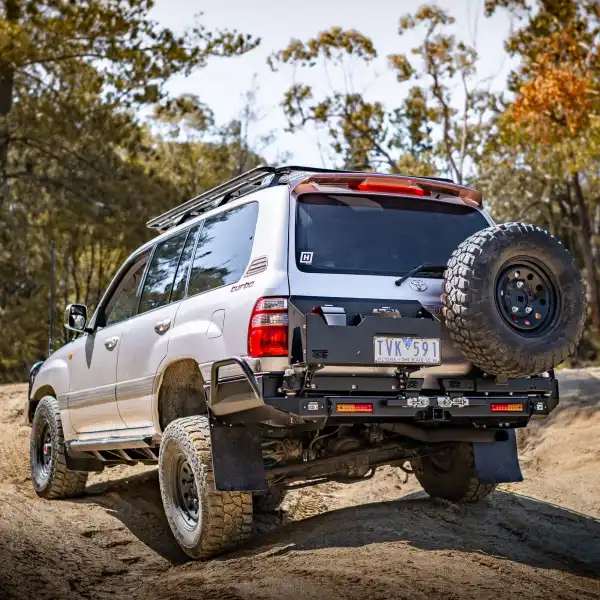

Anyone have The Cruiser Company rear bumper? Wanted to get your feedback positive or negative about it. Thanks!
No experience, but just took a brief look and compared to Dissent.
Generally it looks nice! Like the design, narrow, the side hoops.
Price: very similar to Dissent
Availability: Cruiser Comp seems to be very quick
Stiffness: Comparing the wing mount Dissent seems to be significantly stiffer
Weight: can't find it for Cruiser Comp, but full steel vs. Dissent Steel/ Alu mix with 155lbs (w/o swing outs)... Not sure who the winner is.
For both you'd have to remove the rear cross member.
For me it would still be Dissent, although like the narrow design with swing outs.

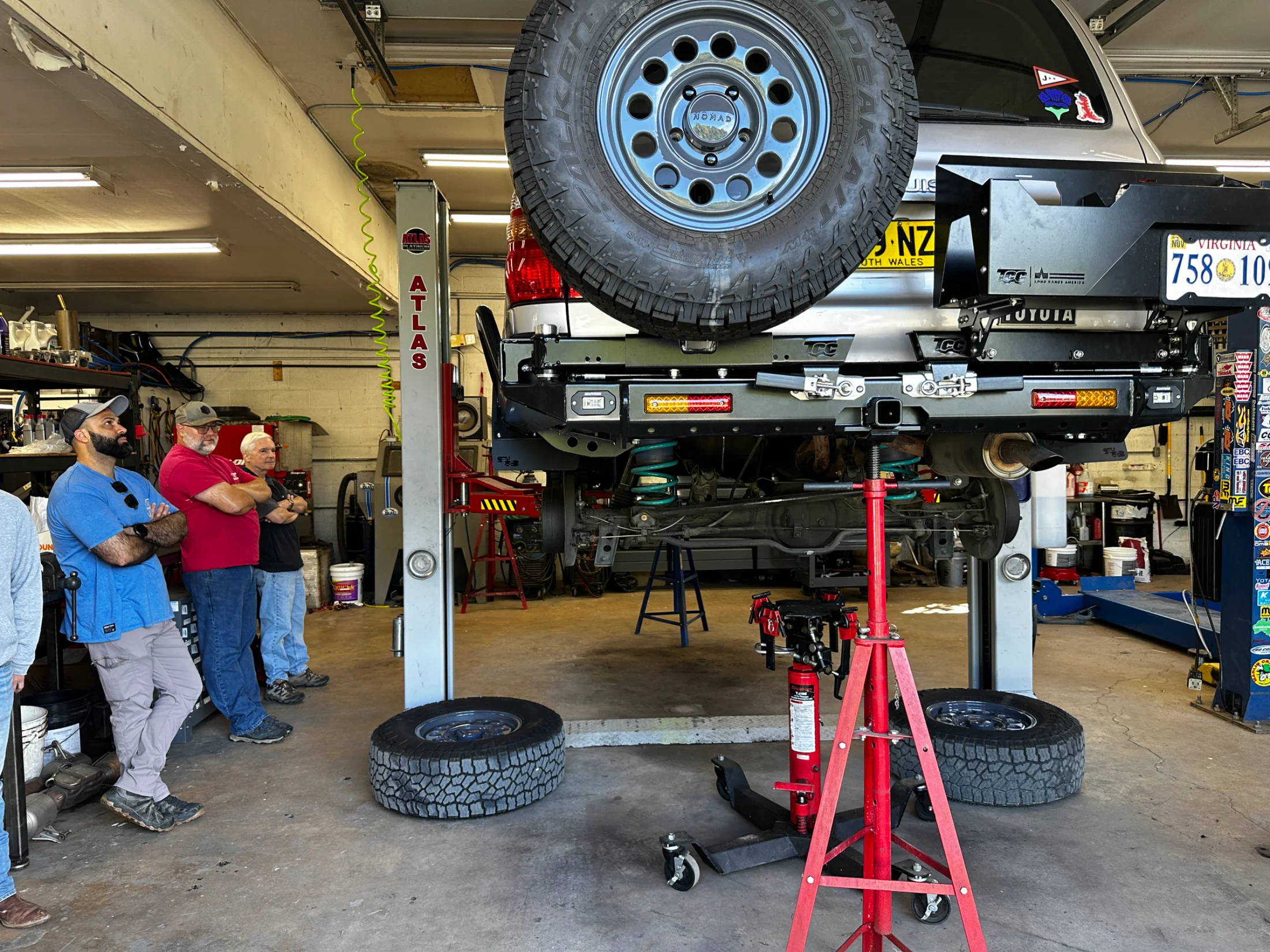

I had the 1st version and the side mount plates that connect to the frame caused serious rubbing issues on my 100 with 35’s. I shoot the guys at LRA a message about it, they in turn reached out to TCC and two days later I was told they would be sending me the updated version that is higher clearance but does require cutting the cross member. I now have the second version on my truck and this thing is a beast! No rubbing issues, one piece design with integrated tow bar, higher clearance (I’m gonna have to cut the tip off my exhaust now!), attachment points on the bottom of the frame. I would dare say it’s one of the best rear bumpers on the market right now. It’s pricy, but I would almost guarantee this will be the last rear bumper you ever buy

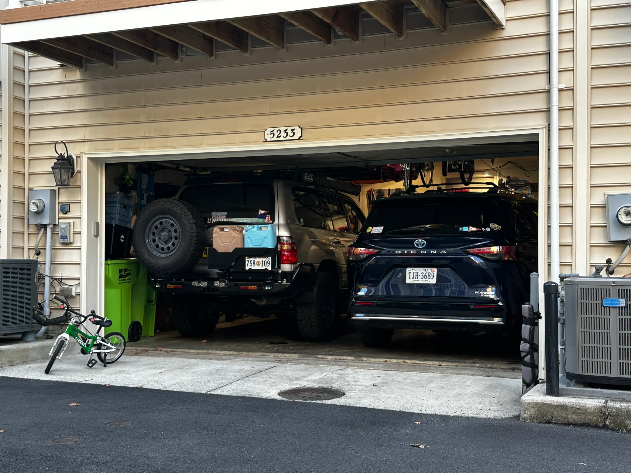

Can you tell me roughly how long it takes to put the swing-outs off and on? That's one of my biggest concerns because my garage isn't very long so I might need to take the swing-out off if I need to park it in the garage for maintenance.

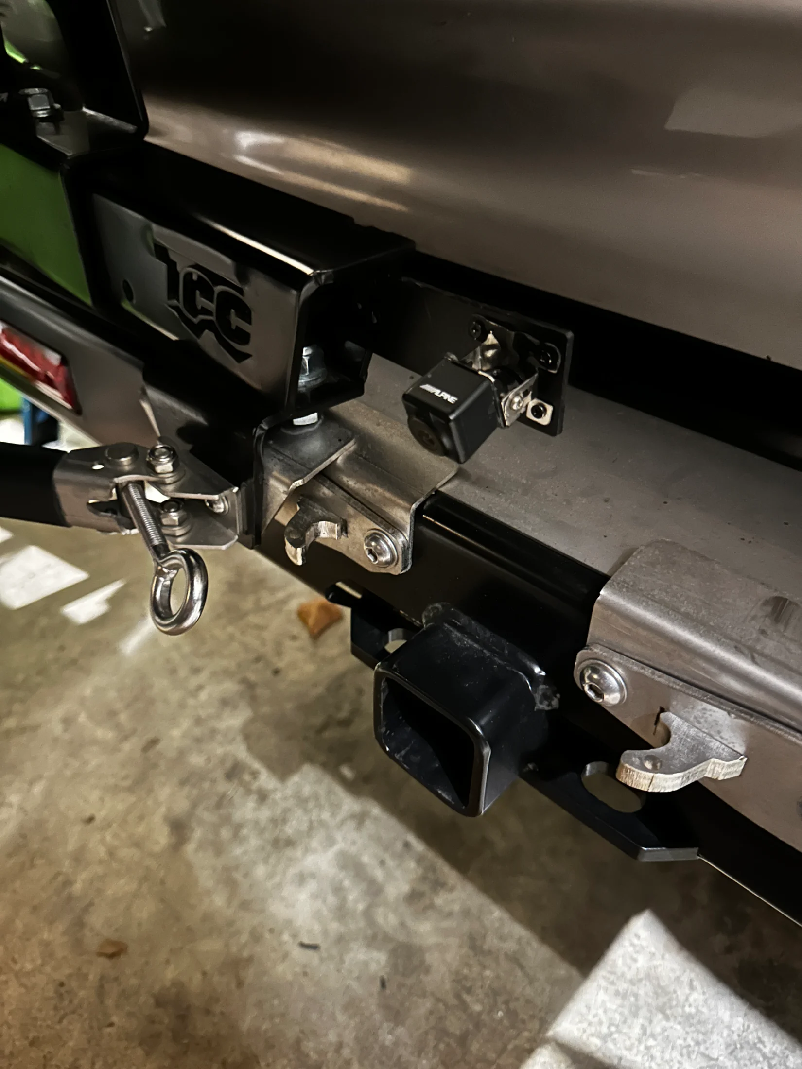

Love my TCC so far. Haven’t wheeled it hard yet but I don’t have any concerns. Some hole enlarging/massaging was needed to get all the holes to line up. I see this as a trade off for tight tolerances and a 1 piece design since every frame is possibly slightly different.

There’s a metal dust cap and a nut on top of a spindle with a cotter pin. I think it took me about 6 minutes per side to pop the swing outs off

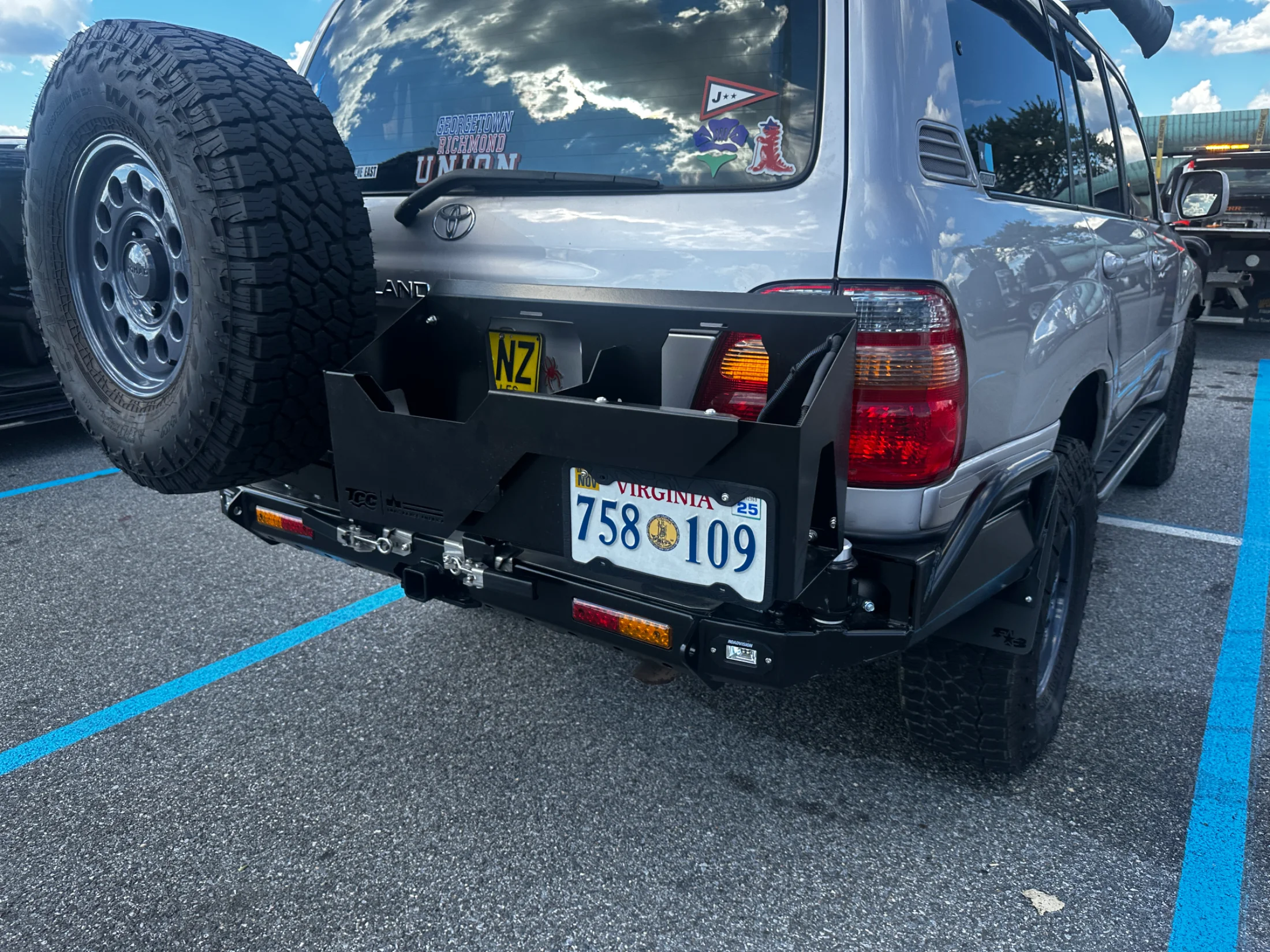

I much prefer the look of the TCC to the bolt together look of the Dissent.View attachment 4002061View attachment 4002062View attachment 4002063View attachment 4002064View attachment 4002065
