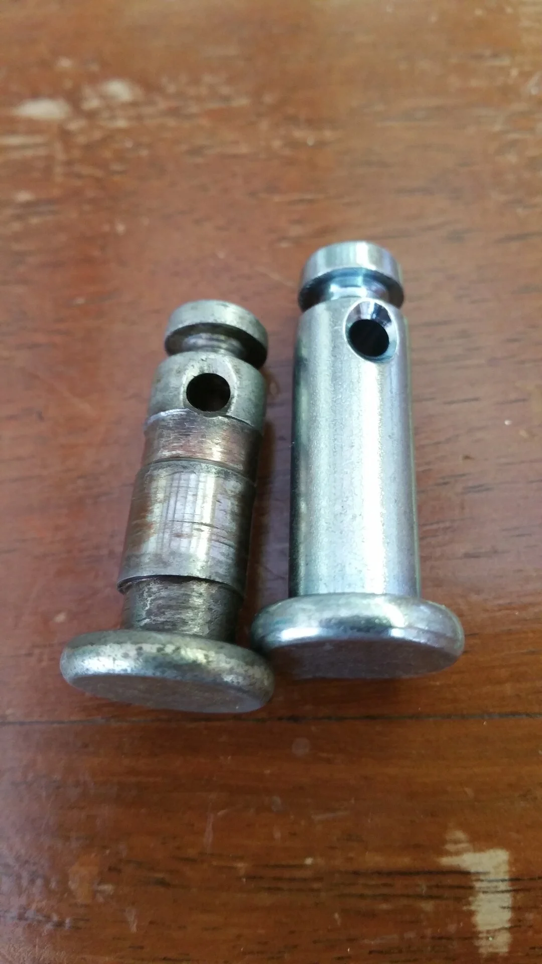

Mine was making a terrible noise when I first got my cruiser. Assume it has more wear than yours, new one was a simple fix.
Mine was making a terrible noise when I first got my cruiser. Assume it has more wear than yours, new one was a simple fix. View attachment 3453446
Mine was worse than that on the cotter pin end, and better than that on the other end. It was the lip that had been created closest to the hole that was hanging it up and prevented removal until I freed it up by screwing the rod all the way out and off.

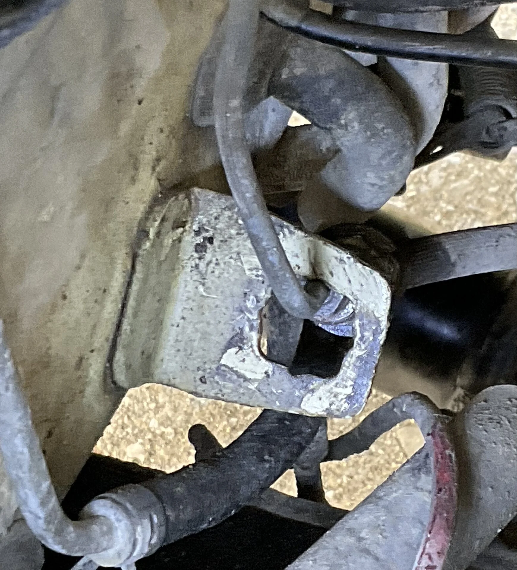

In case anyone was wondering why I said it was impossible for me to disconnect the hard line from the flexible line, this photo might explain why it was difficult, at least for me.
I couldn’t turn the fitting on the hard line because the entire thing would spin, even with the clip in place. Ended up cutting the flexible line assuming that it was going to take more extreme measures. Attached is a photo of the hole in the tab, once I freed up the hard line and moved things out of the way.
I’m assuming that the hole in the tab is supposed to be a hex that the hex on the flexible line fits into, to keep the flexible line from turning when the fitting is tightened or loosened. Not the case here, so the whole thing was just flopping around in there.
I had a total, instant failure of the clutch hydraulic system about 23 years ago and a professional took care of it for me, but I’d have to go back and dig through receipts to find out what was done, but grinding out the inside of the tab looks like that must have been done at that time (?). I really don’t know what exactly went on, but it looks like it involved tightening down the fitting down within an inch of its life and then reamimg out the center hole of the tab, then……something. Too bad they didn’t make a youtube video of “how it’s done”.

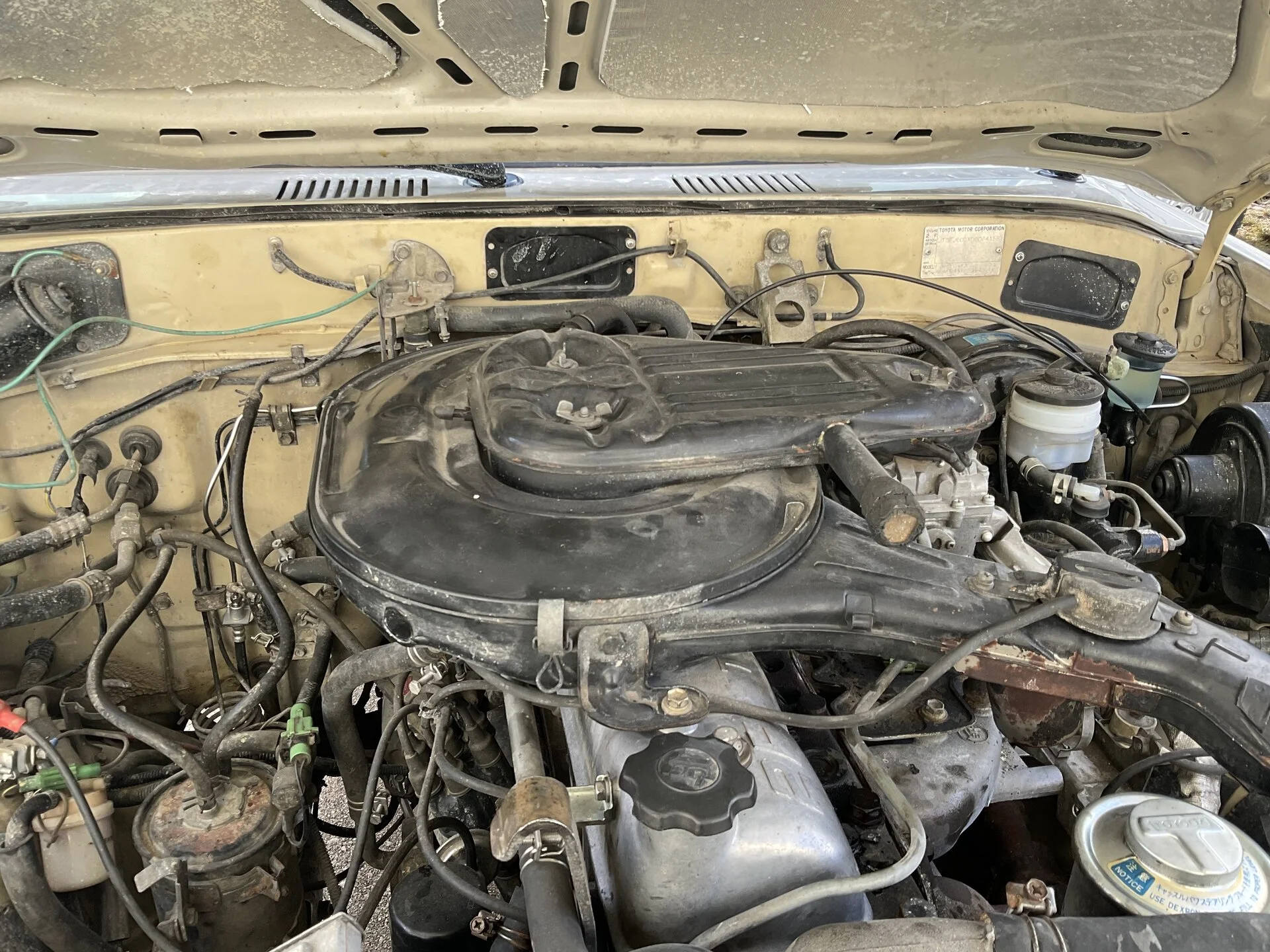

So…got the new hard line in place, as shown below, with the new flexible line, and new master and slave cylinders. Went to do a gravity bleed, bleed screw open, started pumping pedal as I would normally do, and no fluid exits the master cylinder. I’ve bled the clutch system on this car before, but never after replacing everything, and never had a problem. Also, I can disconnect the hard line from the master cylinder, and no fluid comes out. Which surprised me, but I don’t know what I am doing.
Any ideas on how I need to bleed this and get my car moving again, and what the problem is? What I should do next?
Nobody knows whether fluid should leak out of the master cylinder if the hard line fitting is removed? Or any of the rest of this posted above? I know you're out there by the dozen, with the answers. Am stuck and can't find another thread to stick this onto that might make it more noticeable, didn't think it was worth a new thread, so will wait a while, but do need some advice/help. Have ordered an adapter 3 days ago to allow me to use my pressure bleeder on it, but it won't be here for another three days, and I don't even know if that is the answer I need to get this bled. Thanks in advance.
Did you bench bleed the master cylinder before installing to the firewall?
crack the bleeder screw and have a helper pump the master cylinder really fast by hand. It will bleed.
No, I didn’t, though it occurred to me after I started having problems. This is actually helpful, because I didn’t know whether this would have made the difference or not. I’ve not done that before, but there are youtube videos, so that’s an option now. Of course it was my following an fj40 youtube video to put this all together, where they didn’t bench bleed it beforehand that made me think that would not be necessary.
Thank you.
Thanks. Bleeder screw has been significantly cracked, but it’s possible I was not pumping it fast enough. Pumped it a significant amount but maybe not enough, and not fast enough. Will give that a shot right now. Thanks.
