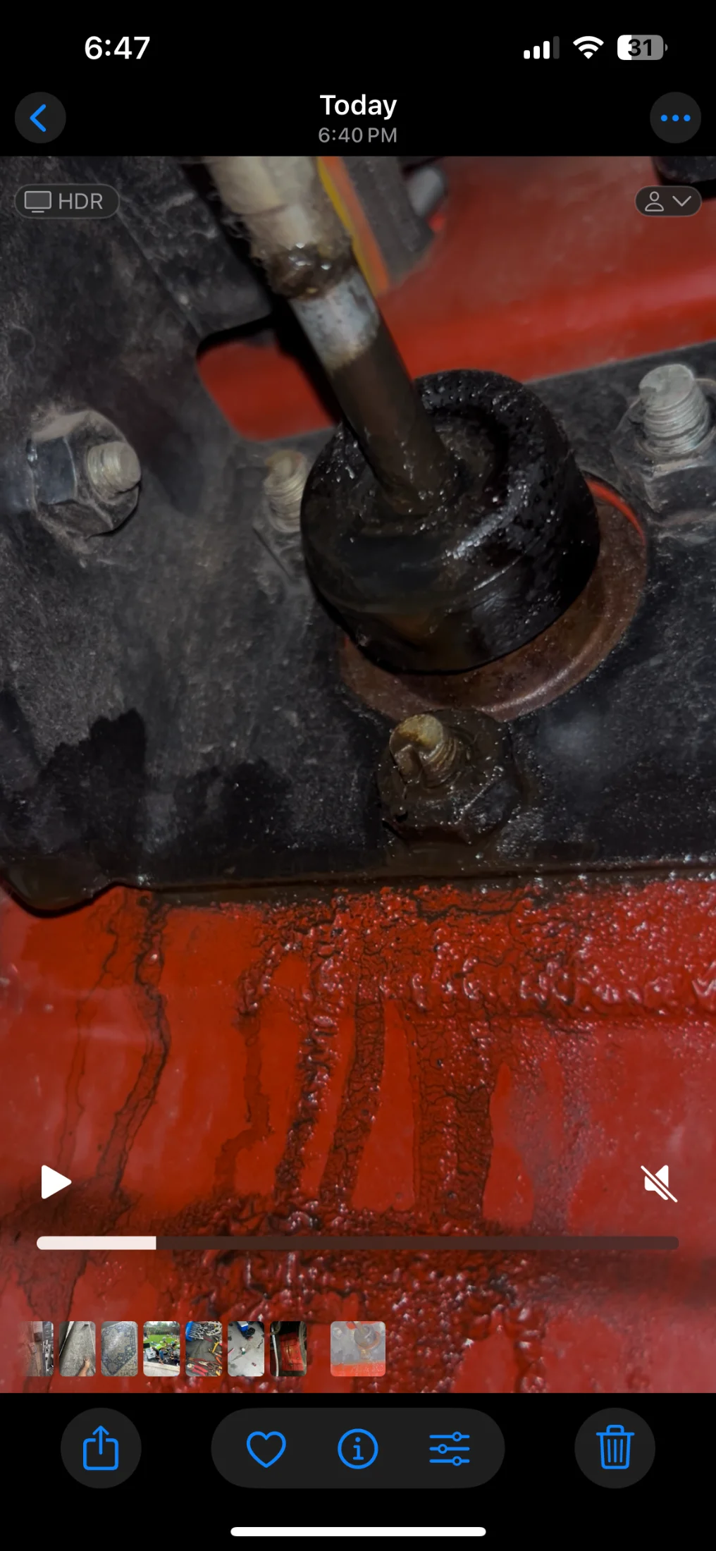

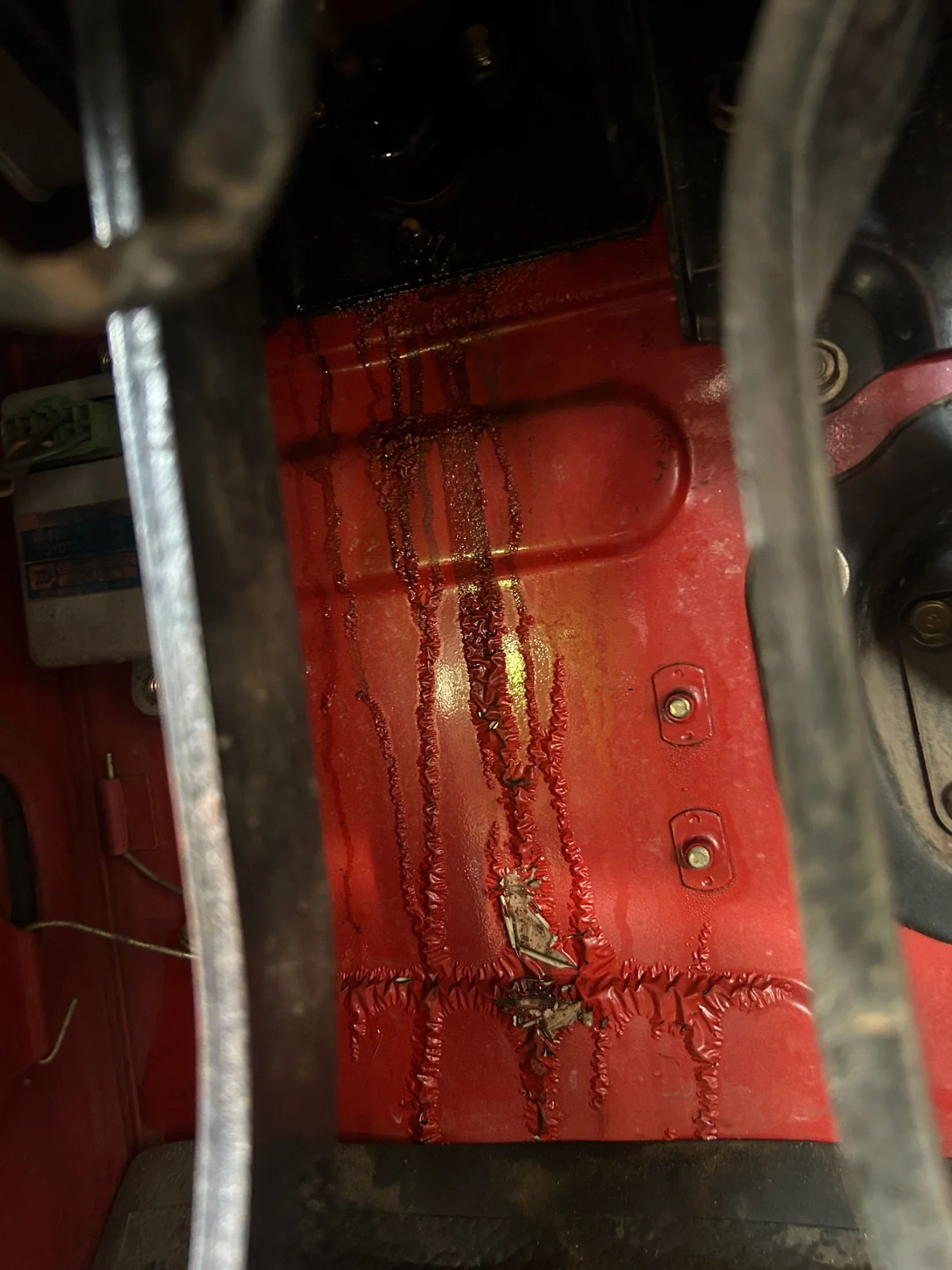

It appears the linkage seal for the clutch is leaking. Anyone have guidance or a walk through on how to fix this? Hoping for a guide before just diving into it.
This is on a 1977 FJ40
Cruiser outfitters sells replacement clutch master and slave cylinder, along with some other vendors. Id replace both. You want Aisin parts.
Easy button.
There can be kits for both master and slave. Not very hard to do - if bores a really pitted/rusty way better to get new stuff. I bought a master/slave and with a stainless steel braided off ebay (joetlc if I recall correctly) for like $130 delivered. It had a extra long hose for a FJ45 - was like $50 more for a short correct hose - I just made a loop - works great. ProTip on this unit screw the hose to slave first - then install slave, route the hose, connect to master - bleed, done
