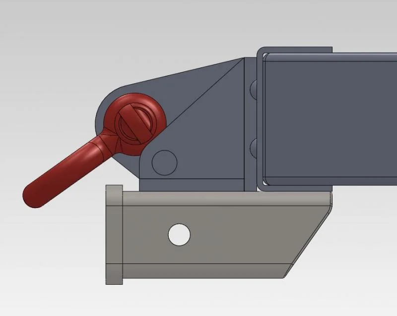

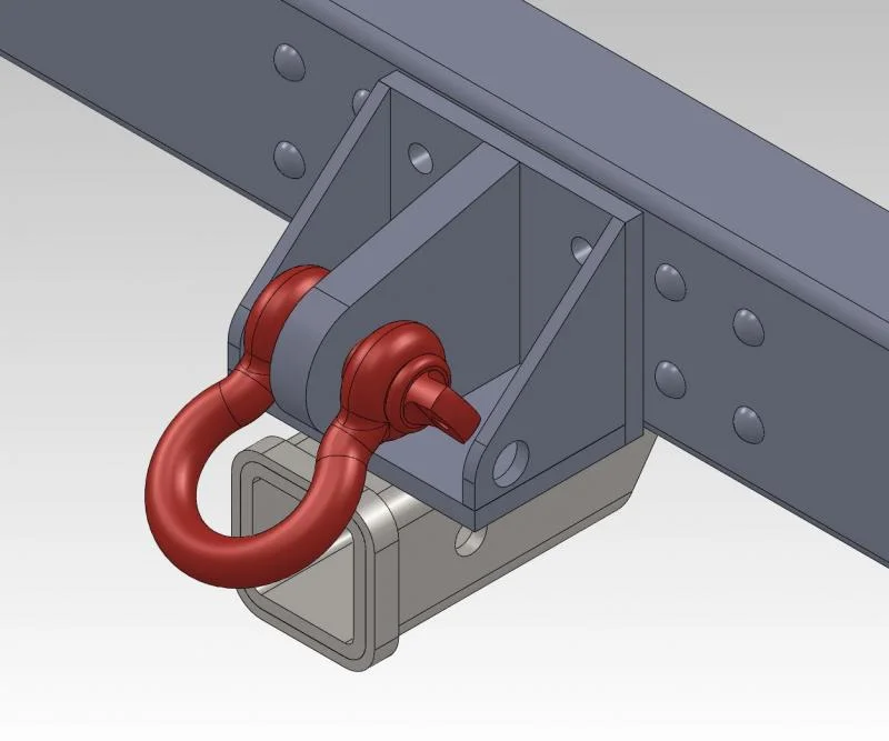

Final Design
Okay, I've been out of town for a bit... got home and spent some time whittling on the previous weldment. I now have a final design and parts ready for welding...

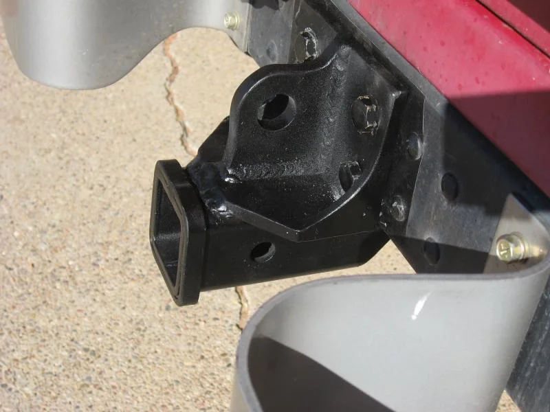

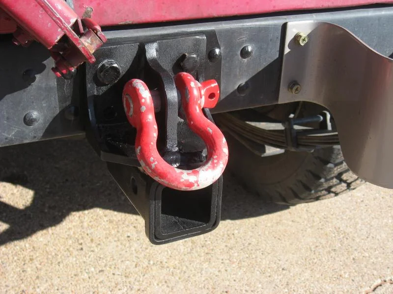

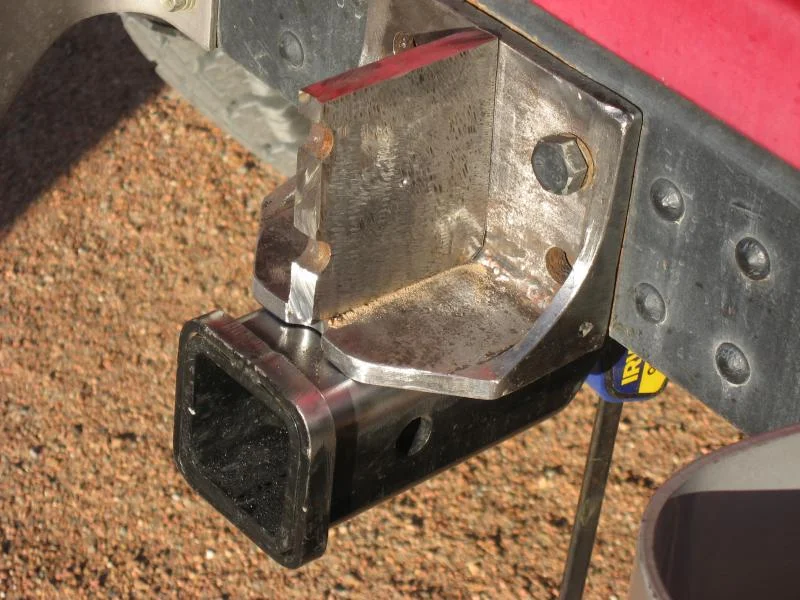

Got it welded together today and it looks great. I'll grind on it a bit tomorrow and paint it.
Thank you Jericho!
Thank you Jericho!
Well then why the heck are we still looking at some CAD drawing for?
Don't grind on it. It looks perfect, paint it and go!!!!!
Yes, Jarred has skills!
I probably should have clarified about the grinding... I was going to round the top corners but decided not to. It's painted and when I get back in town I'll install it and post a pic.
Baldwin's got some welding talent indeed!
Nice.
Thanks for the compliments! Cant wait for the install pics!
Looks nice & stout. If you ever want to add some struts from the hitch to the frame for more strength let me know and we can zap some on at my yard. Lots of scrap to work with. What is the program used for the drawings?
