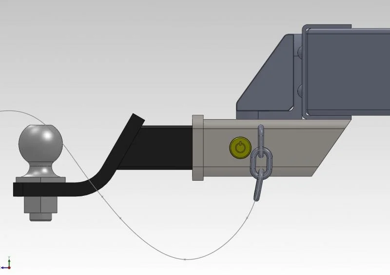

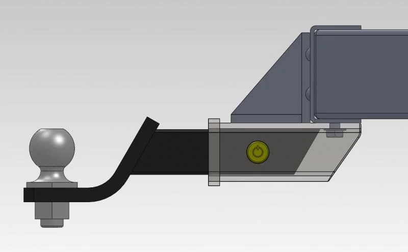

I have a simple receiver hitch that I'd like some angle iron welded on to...
If you have the materials I can melt those together, hopefully without it looking too ugly.
I have the receiver tube but need a source for the angle and gusset... a drill press would be nice also.

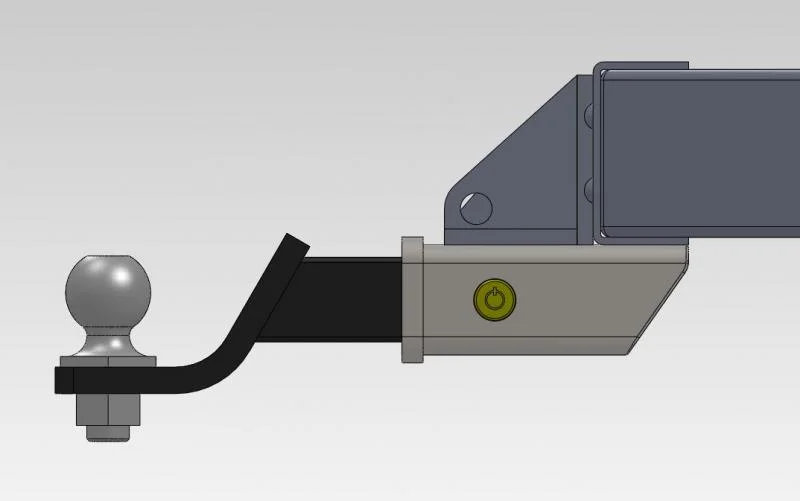

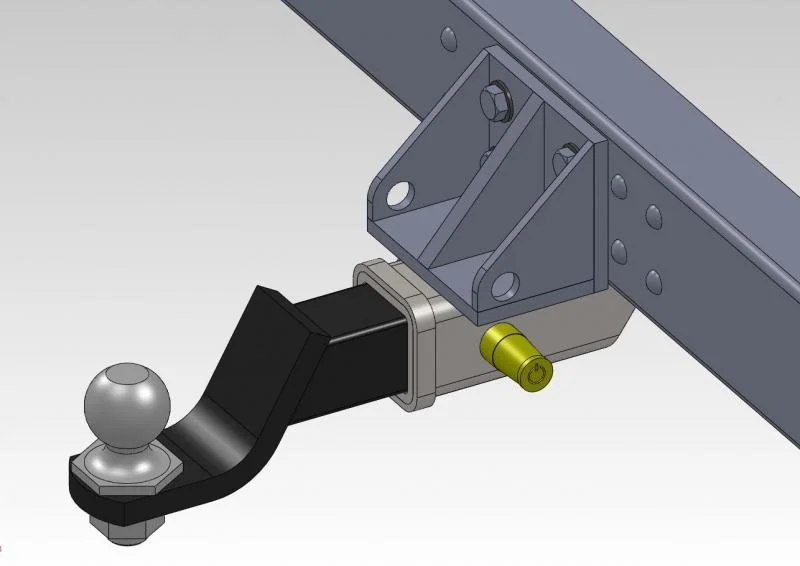

I've looked at the three or four that are available on line... MAF, Mark's, CCOT, etc... all would probably work fine but I have a Yakima bike rack that if too close to the bumper would interfere with the spare tire. The one designed above is extended further aft to clear the tire.

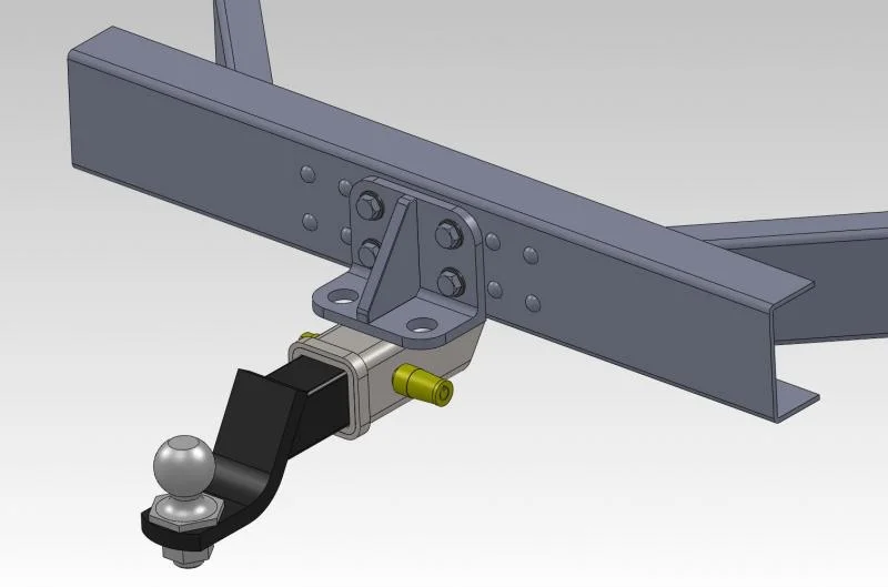

Remember, that the farther out the less it can carry...................not saying its not a good idea, just saying that it won't be good for much more than that bike rack!!!!
SolidWorks 2011
It's out 5.5" from the frame/bumper... continues under and is bolted to the bottom...

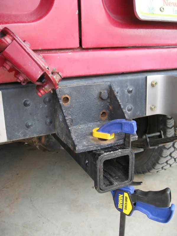

Easier solution?

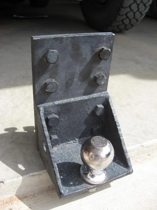

I took a look at the hitch that came with the cruiser... I originally thought that it was usable.
But with a little clean up and maybe add a center web, it might be an easier solution!
Too easy.

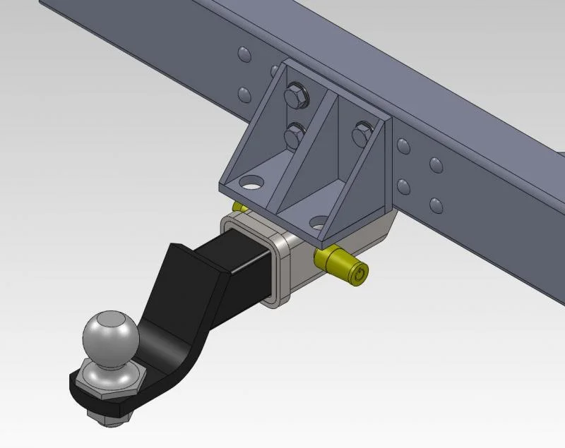

Updated hitch...
Fill in some holes, trim back the bottom, add a center gusset and some holes for the safety chain...
