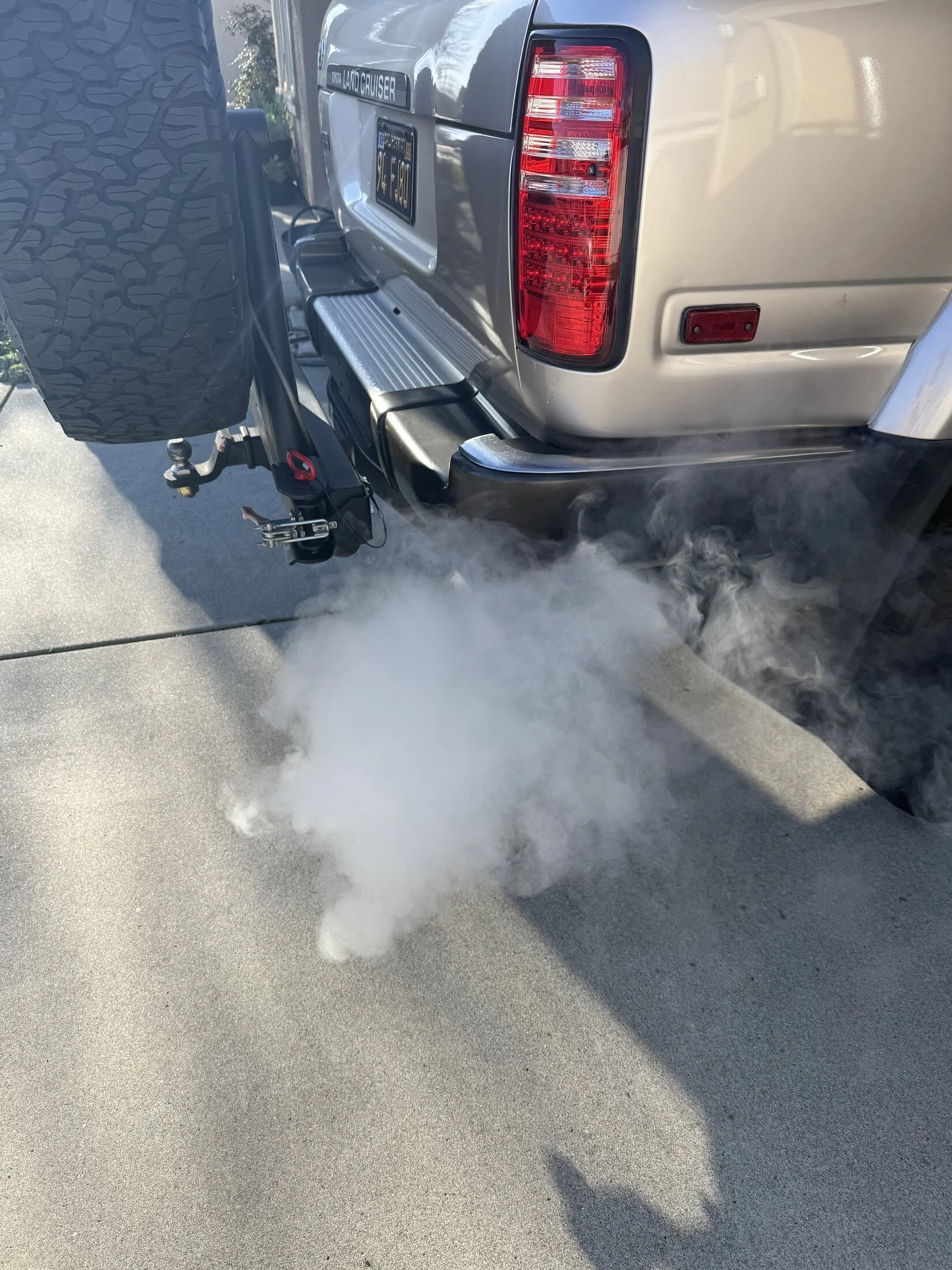

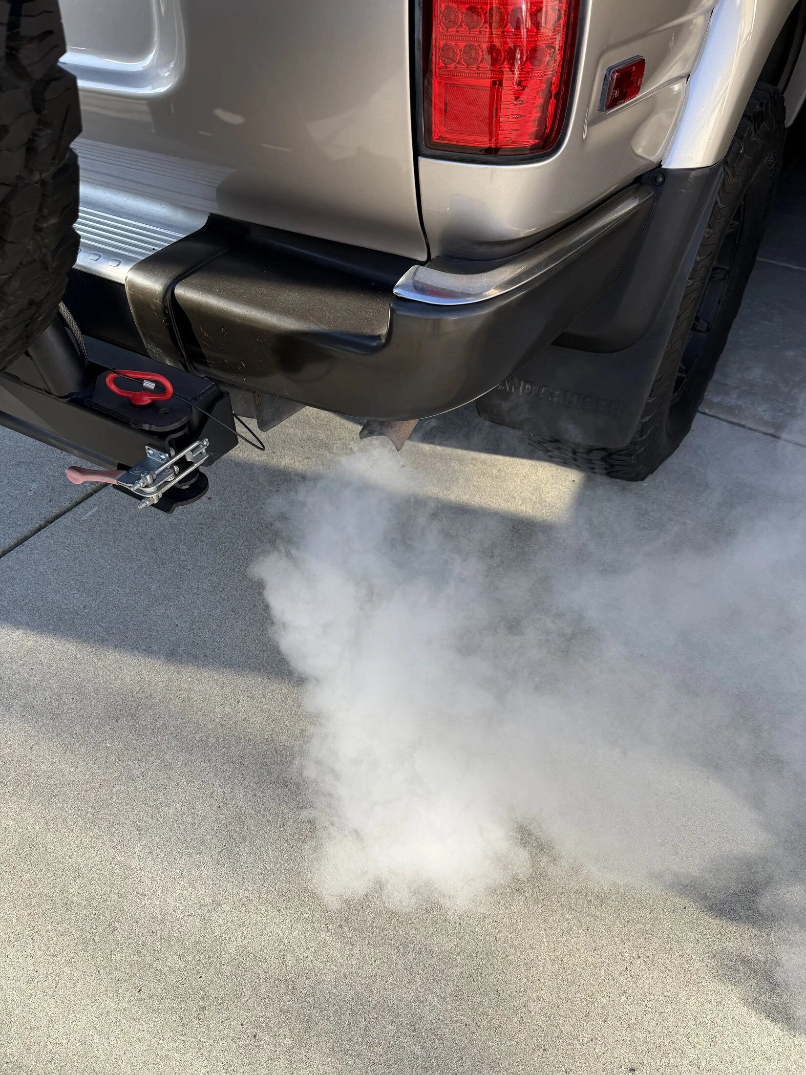

Sorry all, but I’ve just read 20 “white smoke” threads and none seems to have the same symptoms.
Previous to all this, there was just the normal amount of white smoke in the mornings during cold starts, assumed to be condensation/normal LC stuff. I did add some Lucas fuel system treatment the week before, but have since filled the tank again with gas.
Last week, it struggled to start once, then a large amount of white smoke came out of the exhaust. Enough to create a smoke screen that even James Bond would be proud of. Ever since then, she’s been smoking at least double the normal amount. Seems to be white smoke. I don’t seem to be losing coolant. No loss of power. Oil from the dip stick still looks good and not milky. The oil cap did have some milky residue but I think that’s attributed to the frequent short drives. Did a block test on the radiator and it passed. I pulled the spark plugs and they all look pretty normal except #6 is a bit darker than the rest. I’m planning on sending an oil sample to Blackstone this week. Could this be caused from the fuel treatment I put in a week before this started? Any suggestions would be appreciated on what this could be.
I’d be ok with this if she had just started on a cold day. Pics below are after ideling 20 minutes and fully warmed up. It does get a bit better after driving.
That white smoke doesn't look normal-its thick. On cold mornings mine lets out smoke but not at all like yours and I had my HG 12k miles ago. Get yourself a scan gauge since its is an OBD2 to monitor your ECT.
White smoke almost always indicated to oil being burn off, whether internally or in exhaust. Hate to say but it could be your seal(s). How many miles is on the 80?

I bought this truck just a couple months ago. Has 250k on the body. PO had a local shop put in a remanufactured motor in around 40k miles ago.
Well that sucks.....he provided you with paperwork, receipt...ect. Was it a rebuild or a refresh? How does the exhaust sound? Could be an exhaust leak.

I would test for head gasket issues..does the plume if smoke smell sweet?
Get the kit that looks for exhaust in the radiator fluid.
Good luck
The exhaust fumes smell like exhaust fumes. Kind of harsh, fuel smell. Definitely not sweet. I’ve done the block test with the radiator and it passed. I’ll be keeping an eye on the radiator fluid levels though in case things change

Don't assume this is the HG.
You've done the coolant test. PASSED
You've checked the oil and no milk: PASSED
Not losing coolant: PASSED
Spark Plugs: One was darker, were any looking brand new or steam-cleaned?
Do a compression test dry and wet to determine if two cylinders next to each other have a lower compression.
Have you taken it out on the highway and driven it like 20 miles at highway speeds? What's it look like then?
A true HG problem gets worse with time and as you drive, it does NOT get better. Frequently it gets worse.
Does the smoke smell like maple syrup?
Does the smoke smell like wet gasoline?
A fuel injector dumping gas into the cylinder will wash a cylinder and it will create white smoke.
Oil is blue smoke.
Coolant will create white smoke that smells like maple syrup.
Yellow-green smoke out the exhaust could be Freon being ingested into the engine and is now Mustard Gas. RUN AWAY! (Seriously)
If this truck has sat a lot, I would look at rodent wire damage on the wiring harness that has maybe grounded out one or two injectors and it it dumping fuel into the cylinders.
What was the temperature, dew point and relative humidity the day you took that picture?

Highway driving is fine. After a couple minutes of driving, it does go away. I’ve been checking both the oil and coolant daily. Coolant level did drop about 2 inches in the reservoir, which is concerning/new.
Exhaust doesn’t smell like anything in particular, just standard exhaust smell. Not sweet like syrup. Pics in the first post were in the afternoon, temp around 60, so not cold outside, and low humidity.
