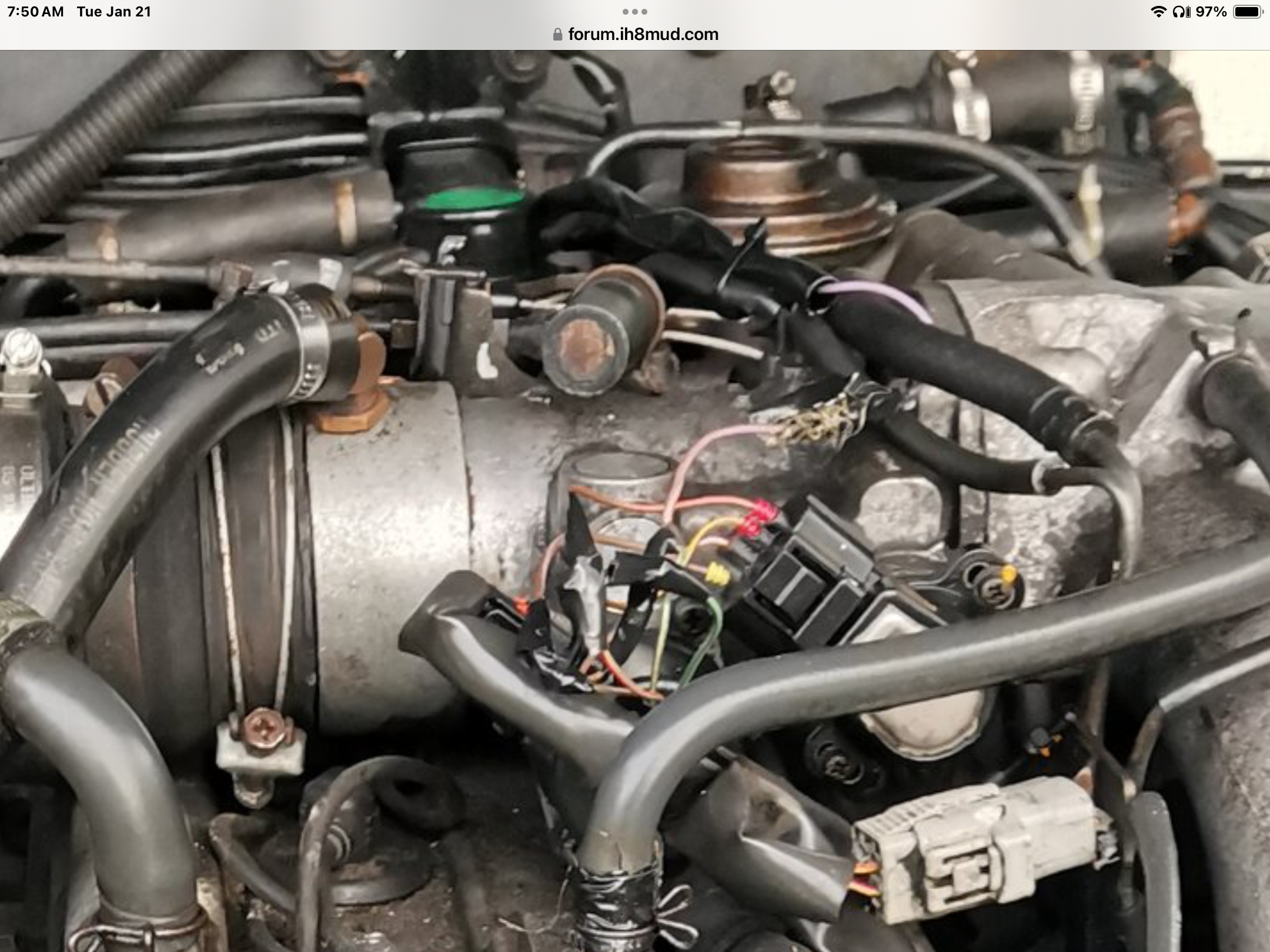

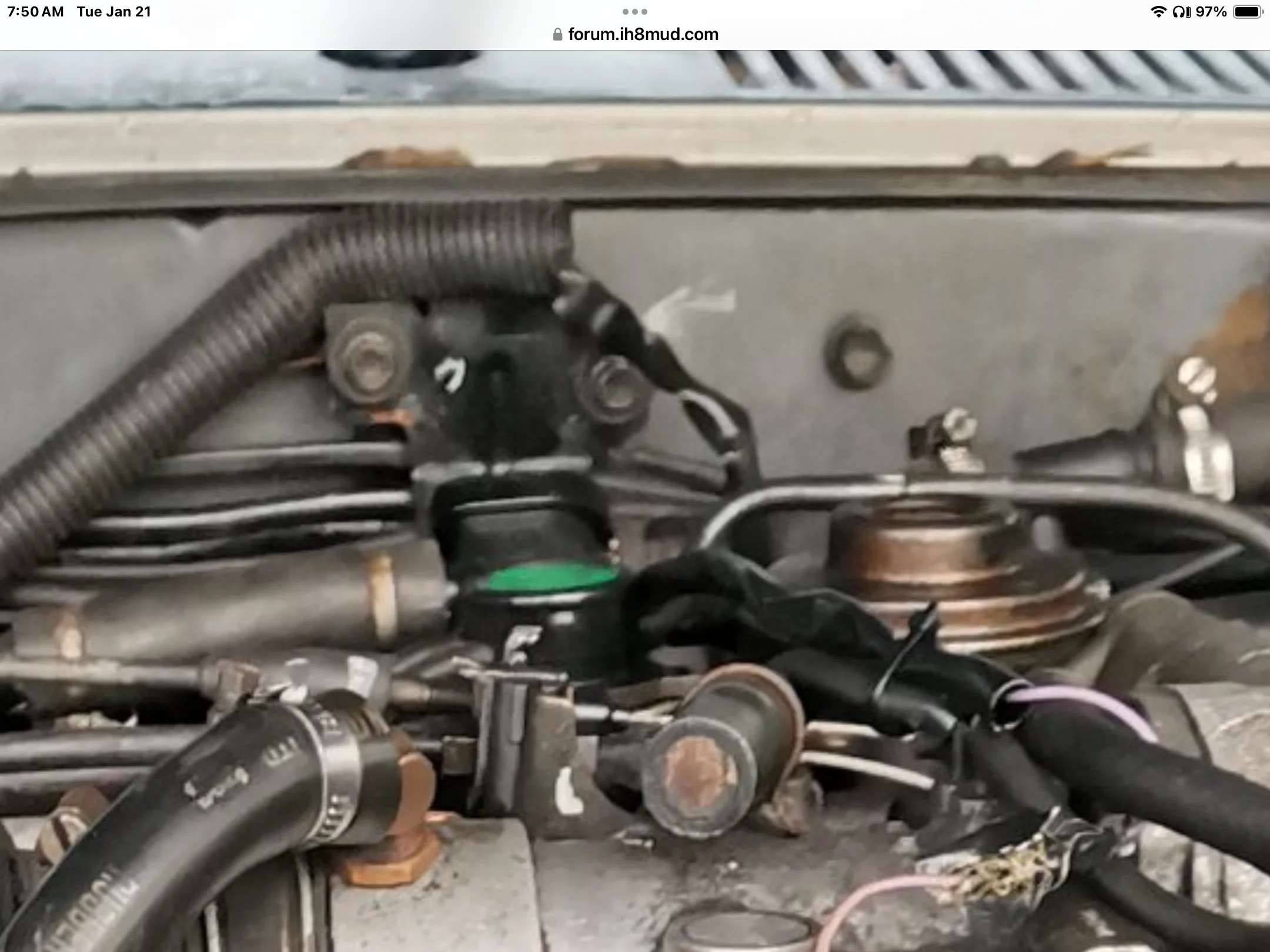

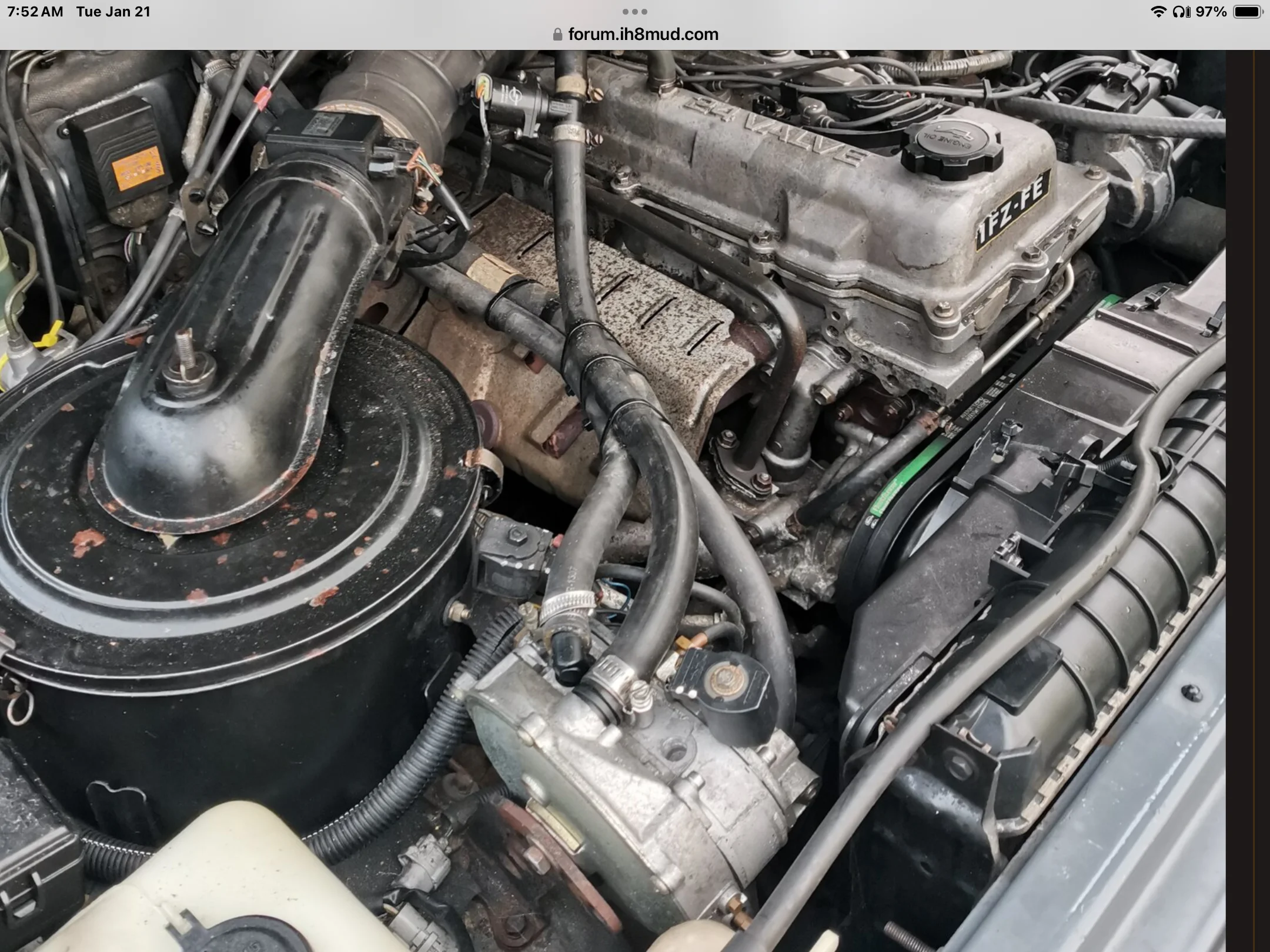

This doesn’t look great.
Not sure what is going on here either.
