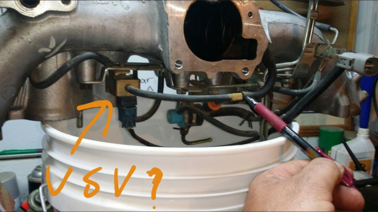

One option is to leave the old VSV in place and mount the new one outside the intake like this:
(the vacuum lines are run in series with the old VSV.)

that looks like a great idea... thanks!
also, what is the part actually called? i'm getting really confused here... looking at rock auto...
"VSV for EGR"
The Doorman knock-off is about $25 on Amazon, but has bad reviews. The $100 OEM part was money well spent IMO.

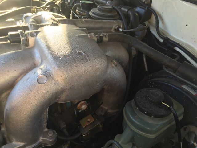

I don't know exactly how the VSV works but would lack of vacuum from a leaking vacuum hose cause the VSV fail to operate? See pic below...
Have you pulled your throttle body to see if the port from the EGR to TB is clogged? Mine was pretty bad.

Yes. The VSV may not malfunction, but if you don't have vacuum, what is it switching?... Vacuum leaks in the system can cause a code.

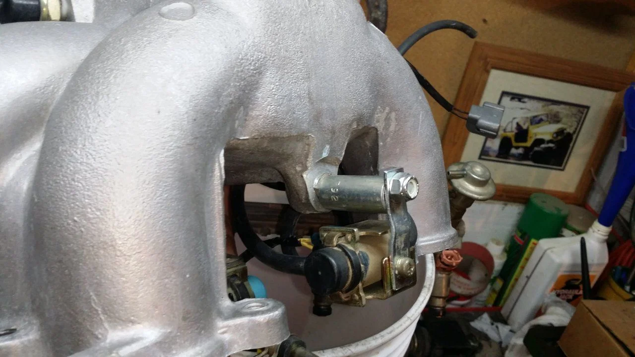

Thanks. I will be testing the VSV as per this thread very soon. I'm currently down with a HG replacment, but here is how I rerouted it for a quick change out like ElPolloBlanco.

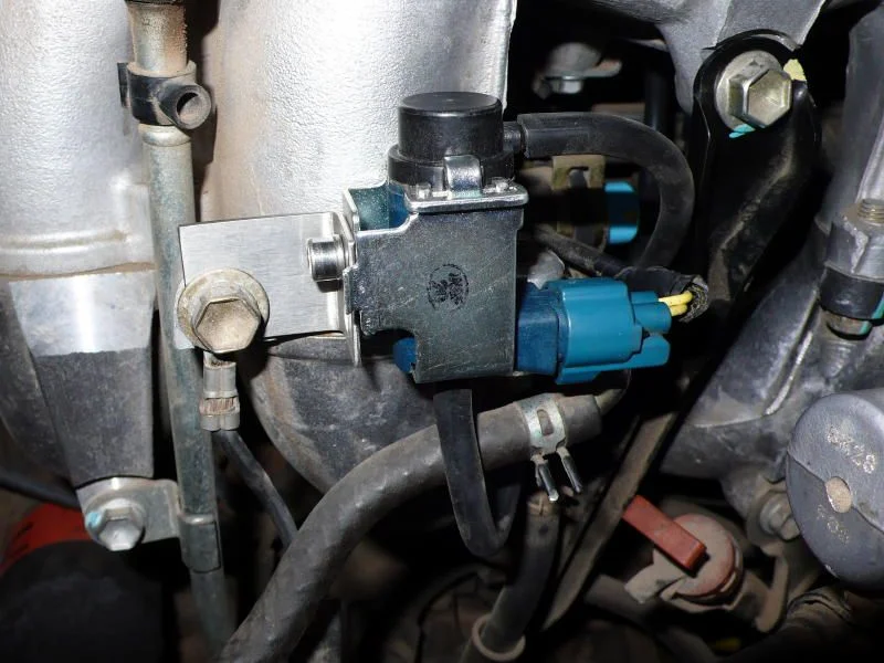

We just pulled the hoses and wiring off the VSV and mounted a new one outside of the manifold. Of course it didn't fix my PO401 code, but at least I didn't have to remove the manifold. :meh:

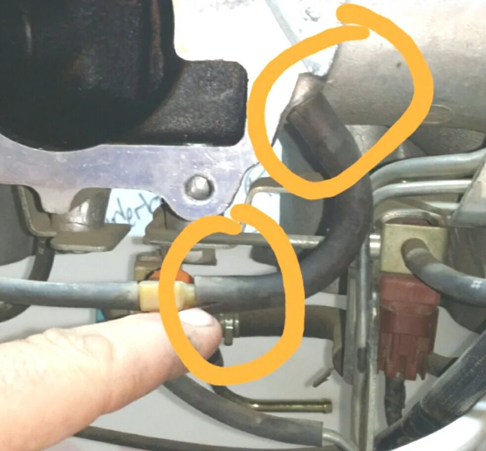

if you've replaced EVERYTHING, have you checked the vacuum passage through the intake? mine's clogged all up, i haven't rerouted yet
