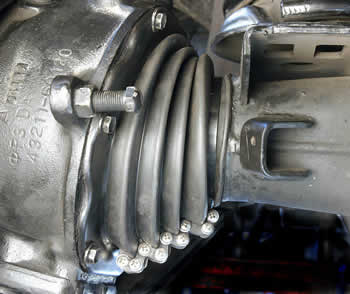

those are cool but they are for a 70 series. they will fit an 80 but they would not tell me if the abs ring would fit.
I don't like the boot. it might make sense in a mine but i would be worried about it creating pressure that causes grease to migrate into the axle.

I'd be interested to know... I also wonder about the strenght of a drilled birf versus a regular one, they could be cryo'd. Birfs rarely fail as result of torsional failure at the shaft cross section, but they might if they were drilled throughout the center (though they are drilled in the outer spline area). Not the first time this idea has hit the market, but I have never played with it much.

Agreed, but I doubt it is "tight" enough to hold any discernable amounts of pressure... I could be wrong having never seen them. They would get destroyed in a heartbeat on my rig, between rocks and the fact that my wiper plates clear my housing by .010" :D
I think the boot is cool. I think if nothing else, it buys your wipers time to live. As long as your inner seals stay cool, i think it's a good upgrade.

True, without the dirt/water the felt & rubber would last ALOT longer (without an inner axle seal failure). However, the felt/rubber is cheap (albeit a PITA to swap) and these boots are not. I have never been a fan of installing felt/rubber without removing the knuckle, but there are those that don't mind cutting a slice in the felt/rubber to install it on the truck...
