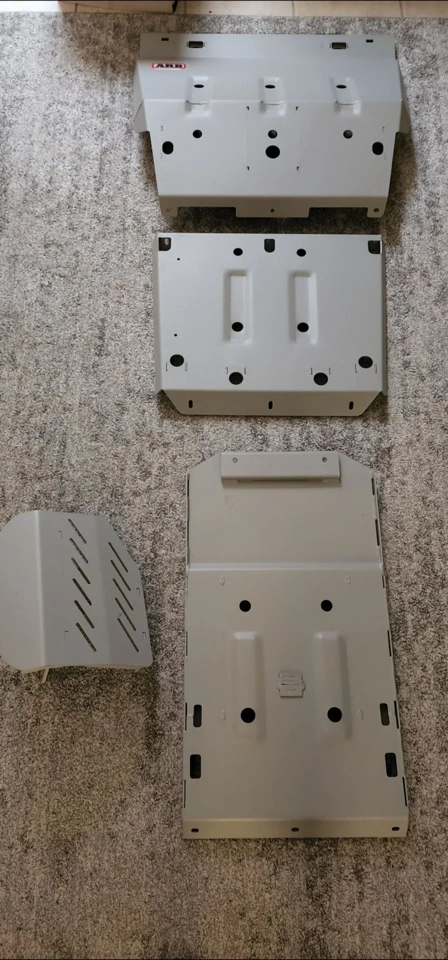

So I had bought arb skid plates a while back for my 16 lc200 and with the recent stealing I don't want that happening to my baby. From the pictures it doesn't look like it will cover or protect it.

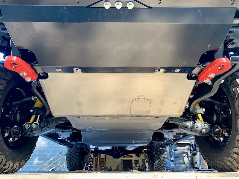

Here's a link to the BudBuilt option: Cat Guards
I have them, and they look like they will do the job...

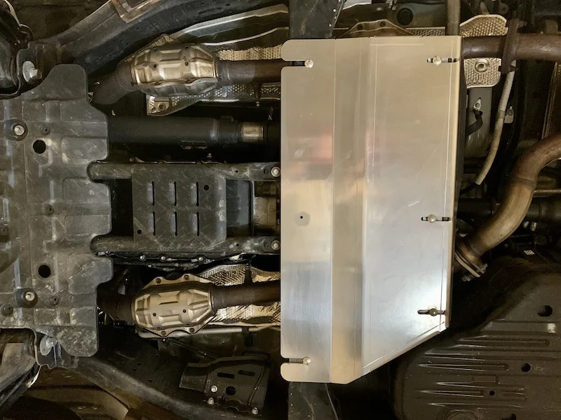

The LC200 has four cats, 2 in series each side.
On this picture from info provided above by DiffKraken two of them are not covered. Maybe Budbuilt has a further plate for that but the picture is not a good example of full cat coverage.
Look again... the Bud Built transmission skid goes in front of the Bud Built transfer case skid and together they cover all 4 cats.
edit: You'll have to use your imagination to imagine that both of the skids are on at the same time. The reason Bud Built shows each skid separately in these photos is because they sell them separately, but you put them on together, not just one at a time, and when they're on together, I think they will provide adequate coverage.

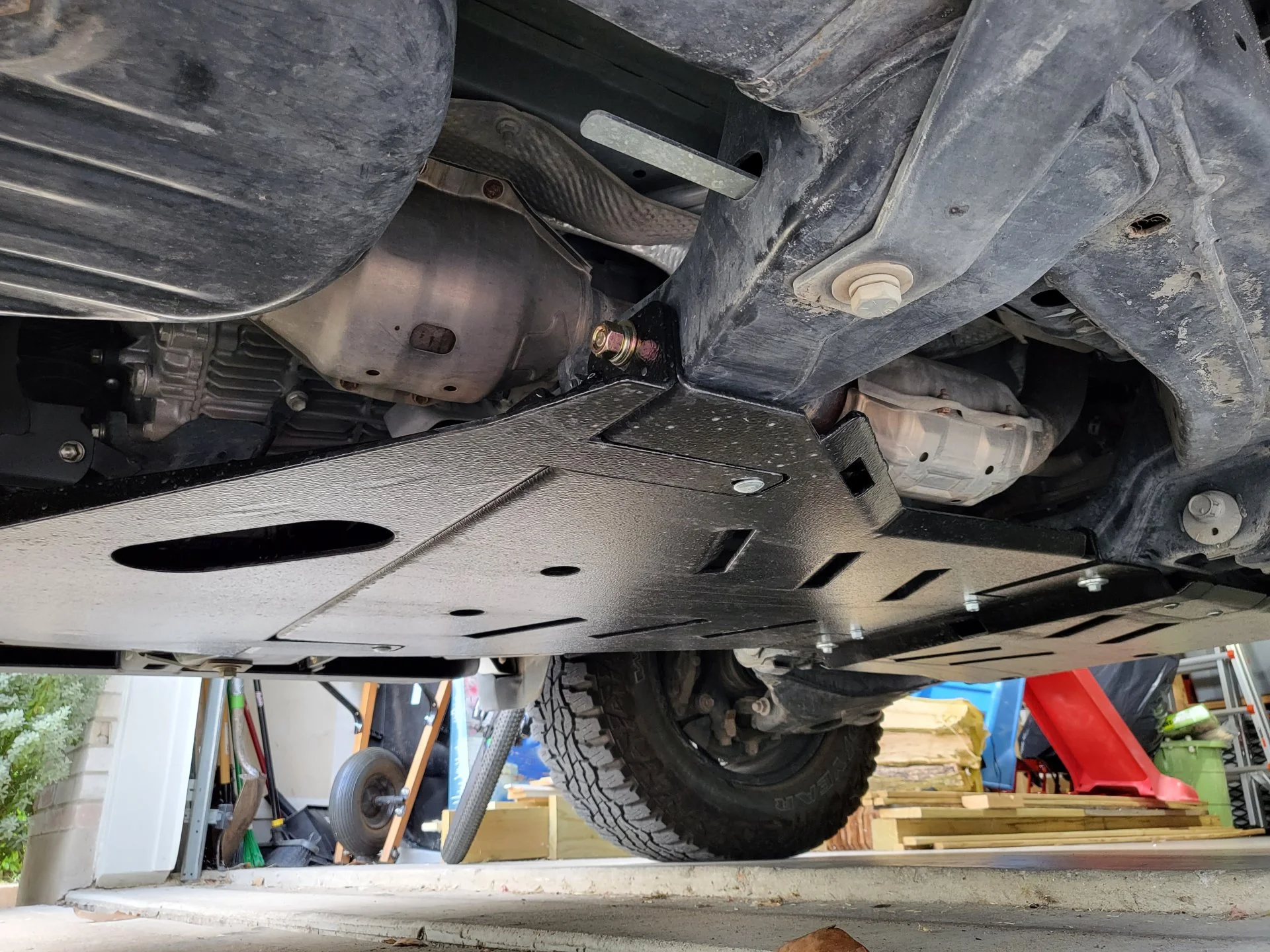

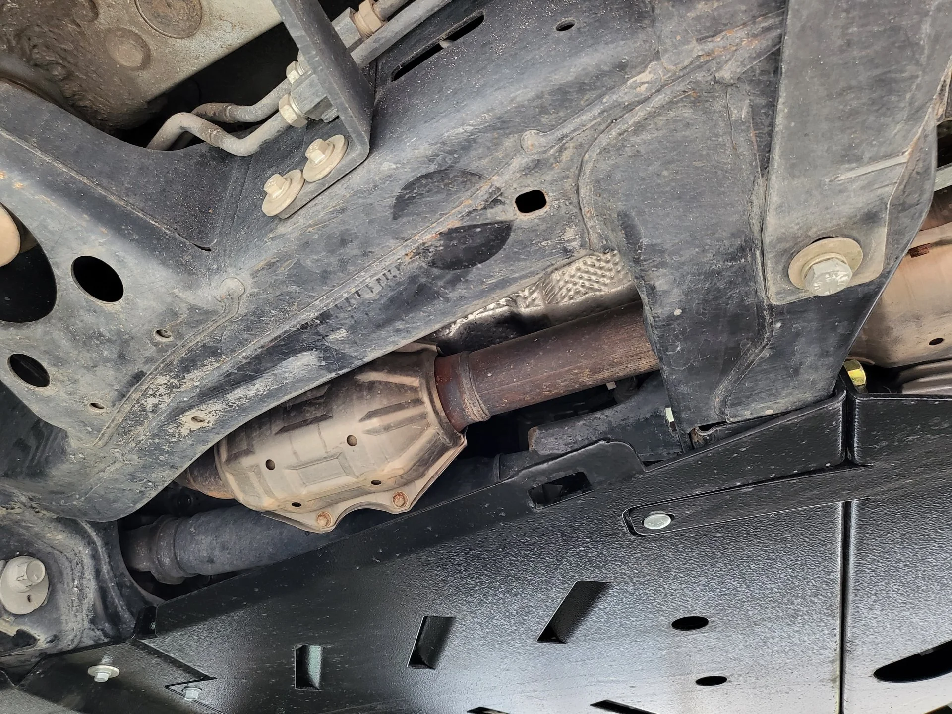

So they are still accessible with the Slee skid plates, damn. I was looking at these earlier, but it appears they don't provide "enough" coverage to keep bandits at bay.
In person it’s not quite as bad as it seems in that image. They would have trouble getting the sawzall up against the pipe for the front cut on drivers side and middle cut on passenger, and in general provide some level of deterrence.
But yes this shows why I was considering having a stainless plate cut and bent to bolt on to the edges of the Slee skid to close up the gap some.
Also at the time Slee was actually in stock and could get to me in time for a trip, and I personally like the louvers for cooling.
But purely in terms of cat protection budbuilt wins this one.

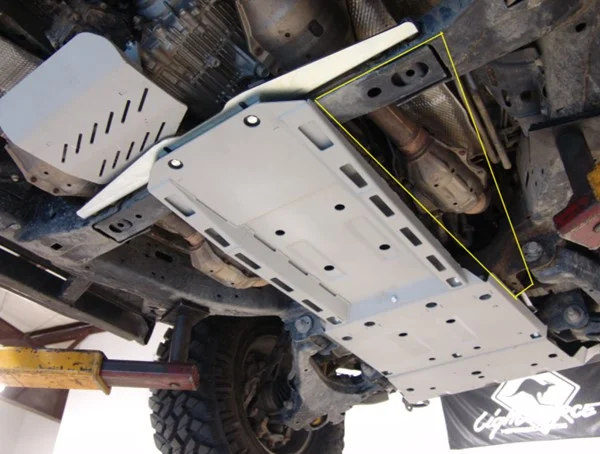

I already have ARB skid plates and don't want to have to buy a whole new set to protect the catalytic converters. I was thinking about having two additional triangular-shaped panels fabricated to fit per the attached photo.
There are already existing bolt holes on both ends.
Do you think this would work as a deterrent?
