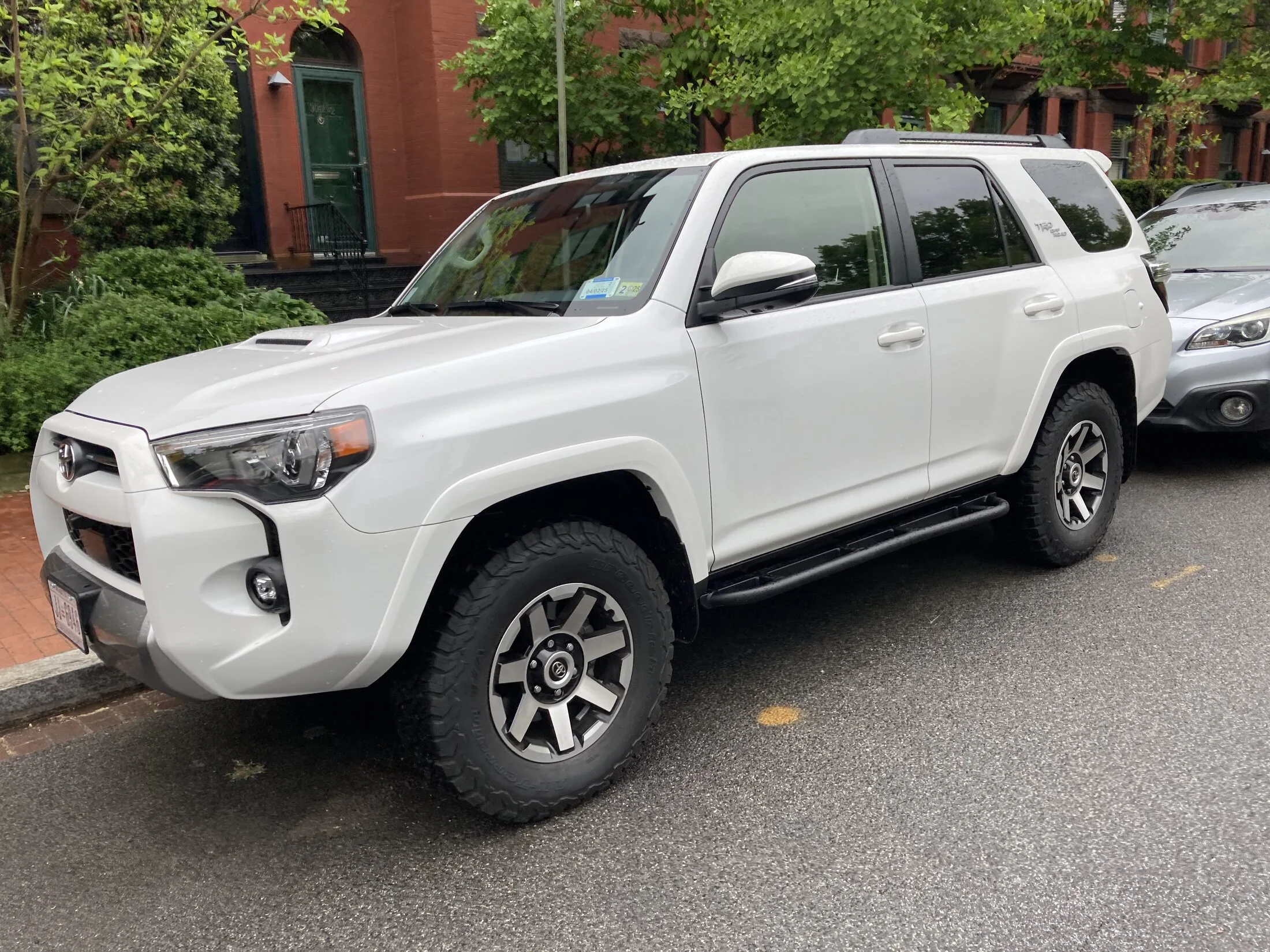

Well... here I am again. This is my second time purchasing a Super White (Paint Code #040 - for '24 they call it "Ice Cap") 5th Gen TRD Off Road Premium 4Runner with KDSS, my 5th Toyota truck purchase, my 4th white Toyota truck, my 7th Toyota, my 6th Tahara Plant produced Toyota, and my 16th vehicle purchase. I'm a big sucker for white Toyotas. My plan is to keep this one longer than the rest. Hopefully forever...
I think now is the time to snag a factory fresh 5th gen 4Runner. This 1GR-FE V6 with the 5 speed is bulletproof. As far as I know, nothing goes wrong with this drivetrain. Toyota has been making the 1GR-FE for 22 years at this point. Among other current Toyota offerings with older engine designs, I think this may be the most reliable powertrain available on any US market consumer level truck for sale today and for the foreseeable future. Additionally, the 5th gen is made at the Tahara plant in Japan where my 200 series Land Cruiser, 120 Prado/GX470 and '89 Pickup/Hilux rolled off the line. That's trail cred.
At this unique moment in time, these trucks are sitting on dealer lots looking for buyers. I was able to snag this truck at $4k under MSRP and under invoice at the beginning of the month.
The hype surrounding the upcoming 250 LC and GX550, the 6th gen 4Runner, and a possible mini LC, has people waiting on the sidelines for the new vehicles in this class. That's certainly understandable- but I feel like the 5th gen is similar to the 60 series when the 80 series was about to launch. Yeah- the 80 LC was without a doubt an improvement, but as time went on, the 60 series held it's own and was still a legend. Of course the 80 and the 60 had the same engine at the 80's launch, but, as we know, the next LC and the next 4Runner will have hybrid and/or turbo motors. Toyota does great with those technologies, but if you're a luddite like me, a 22 year old NA V6 sounds like the way to go. When else can you buy a brand new factory fresh 22 year old bulletproof Toyota legendary drivetrain- let alone with a factory rear locker?
And, while the 1GR-FE paired with the 5-speed auto is not a race car or a tow rig for heavy loads, it is more than powerful enough in my experience. The 1GR-FE has been offered in the following platforms, pretty impressive:
Applications with Dual VVT-i (calendar years):
I'm in love. Please meet Easter Bunny 2.0 and follow my thread for an OEM+ build, adventures, and mussings as we head into 250 LC, GX550 and 6th Gen 4Runner season. And by all means- please join the conversation. I'm always interested in what other mudders think on all this. 🐇 🤠

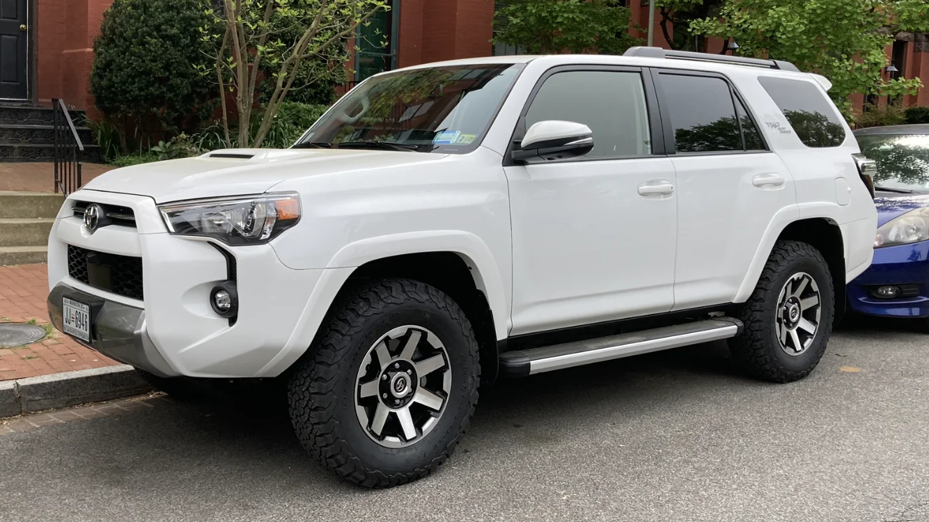

255/75r17 BFG KO2s C-Load

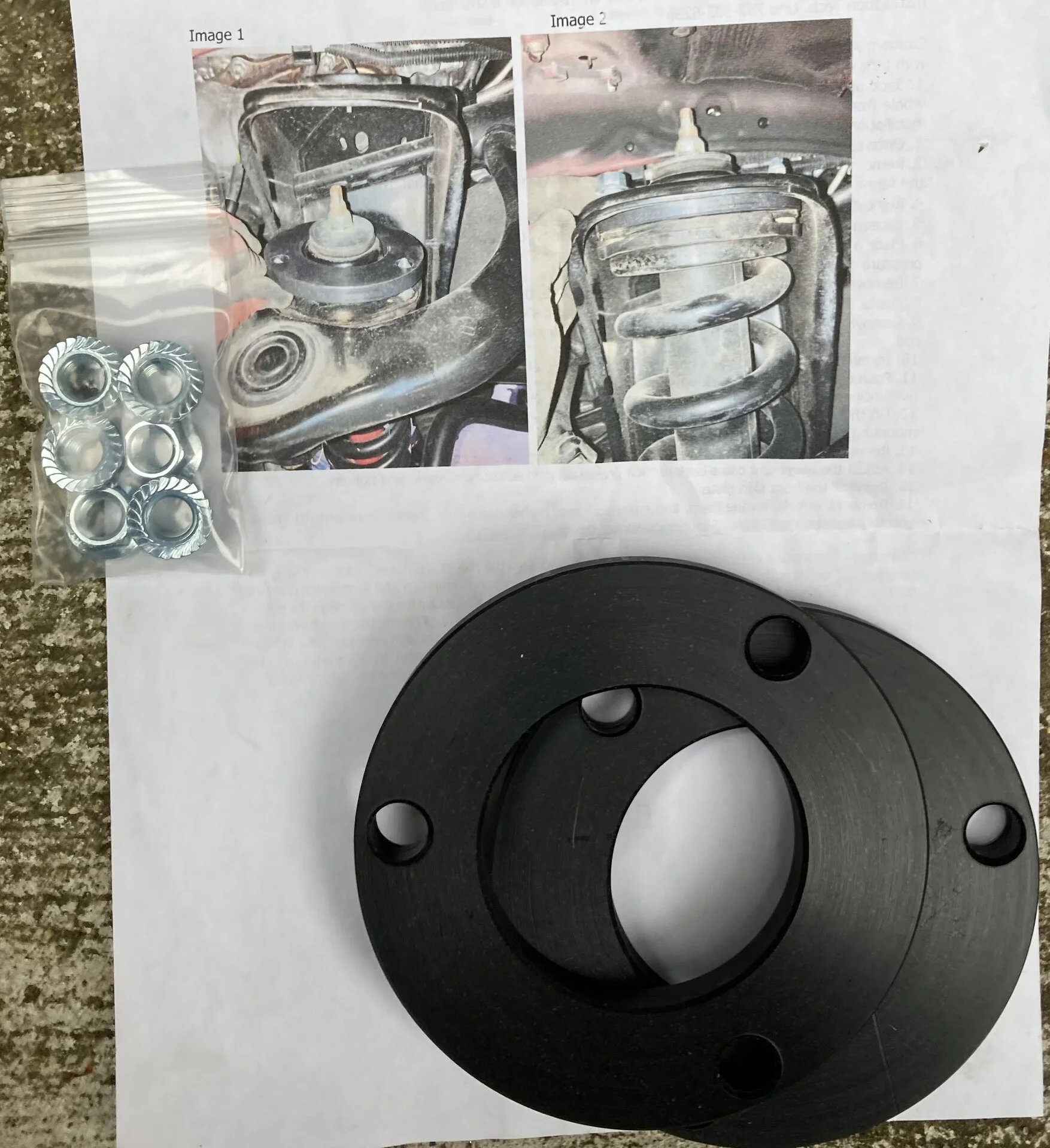

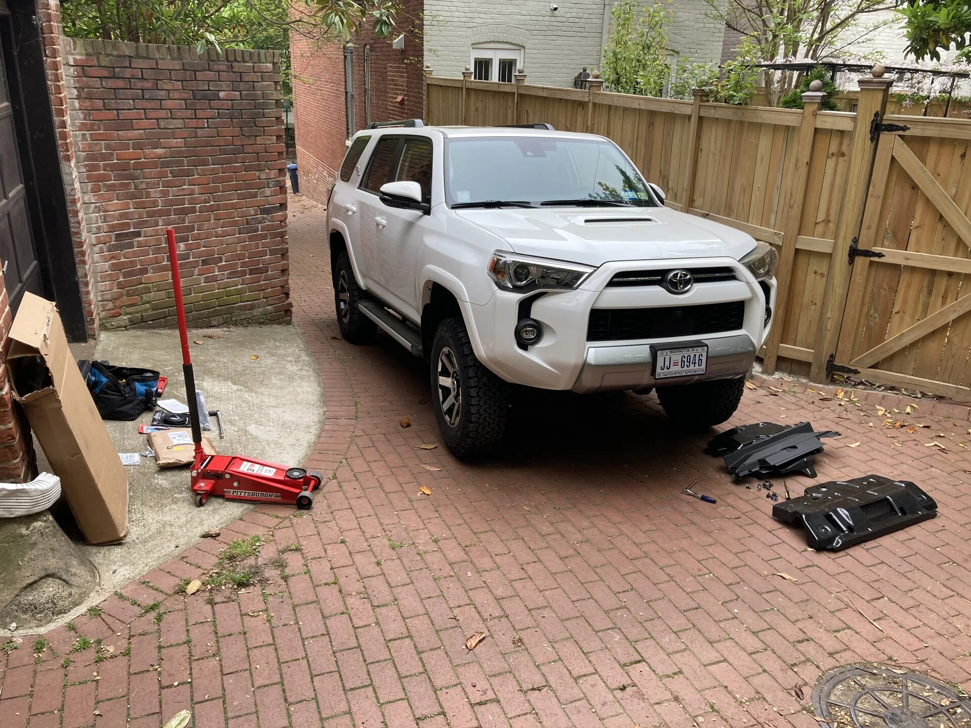

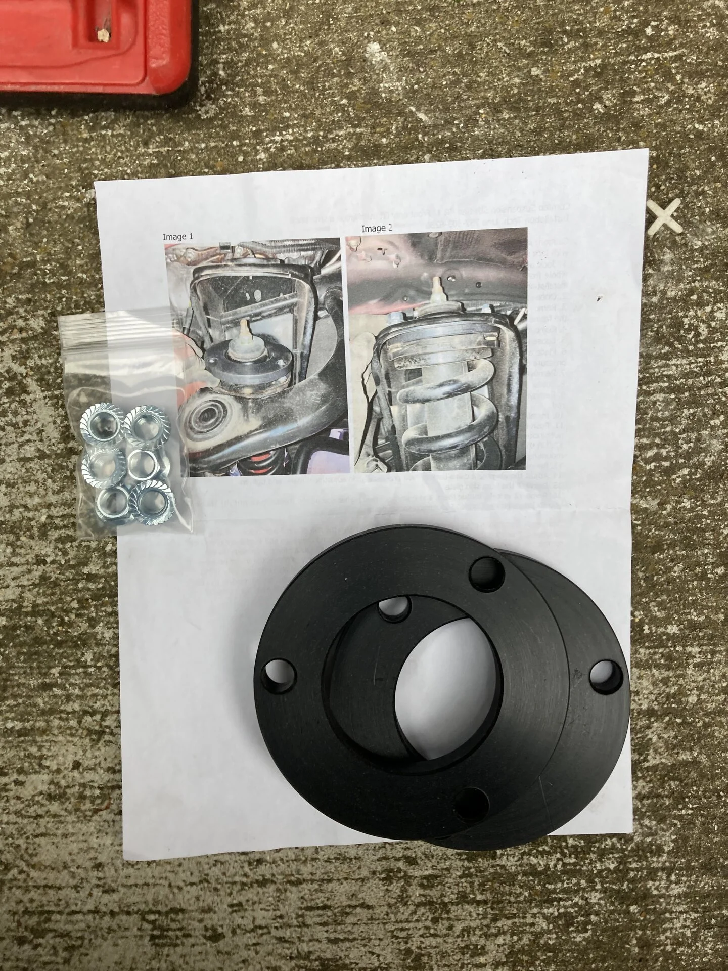

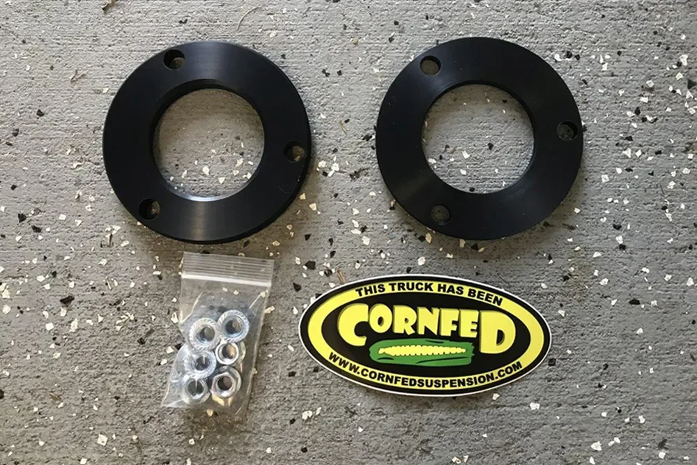

Next up is to get the 1/2" Cornfed spacers on and install the RCI skid and rock sliders. Had planned to do the spacers first and then tires, but the cross-threaded KDSS sway bar bracket bolts threw off my schedule and order of operations. All parts arrived over the last month- took 3 weeks for the rock sliders and 1 week for the skids and spacers to arrive. Not a bad wait at all. I'll put some time aside this month to complete the build.

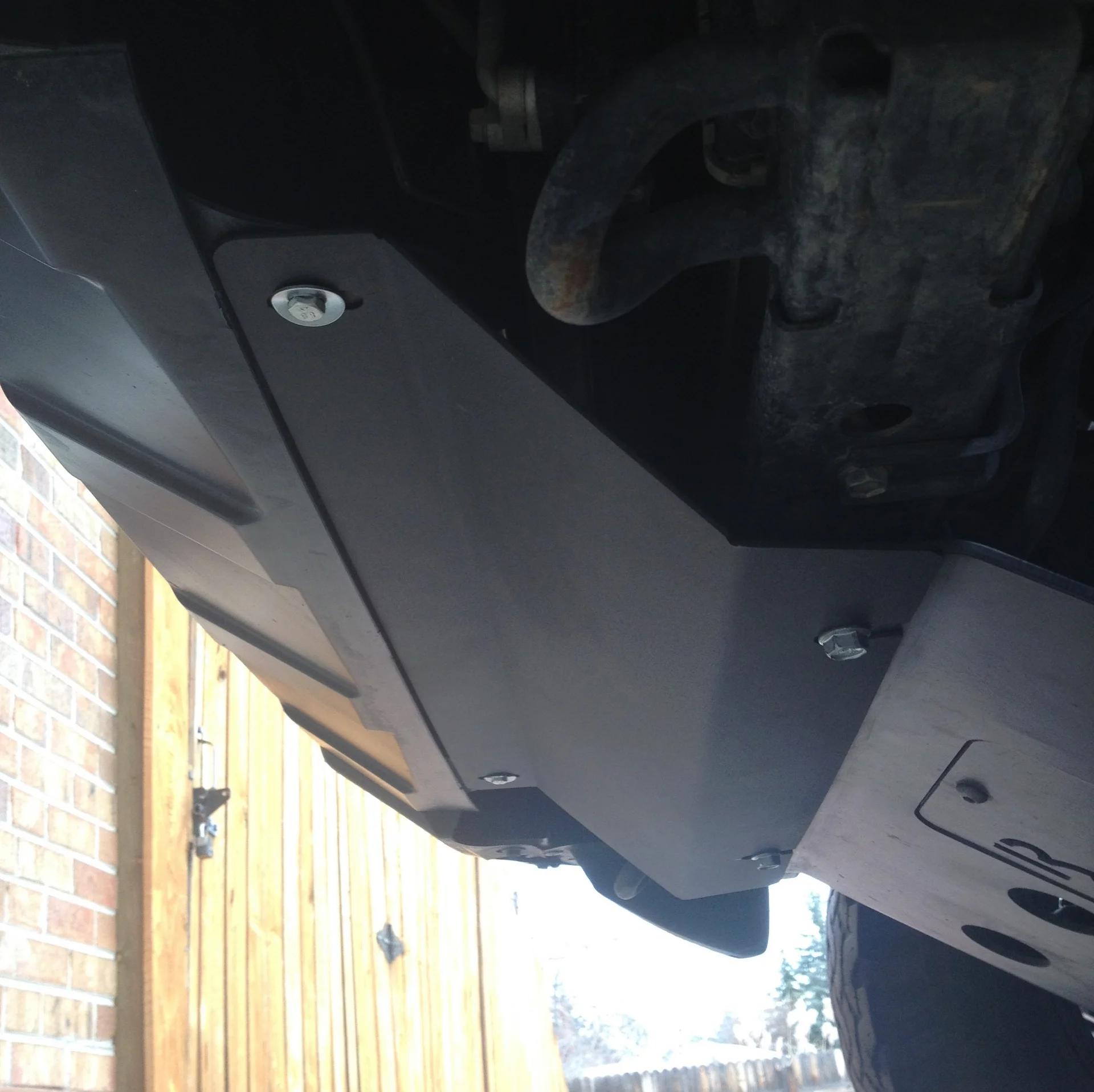

Installed the Cornfed 1/2" front spacers (yields a 1" lift), the RCI engine skid, and RCI filler plate on the new rig today. With the 255/75r17 (32") C Rated KO2s installed last week, this gives a decent 9.8" of clearance. The RCI rock sliders will go on sometime later this week and that will complete the build for this rig.
PS- KDSS sway bars are a PITA. But worth it for the extra articulation and on road handling.
My full tutorial of the 1/2" spacer install found here:

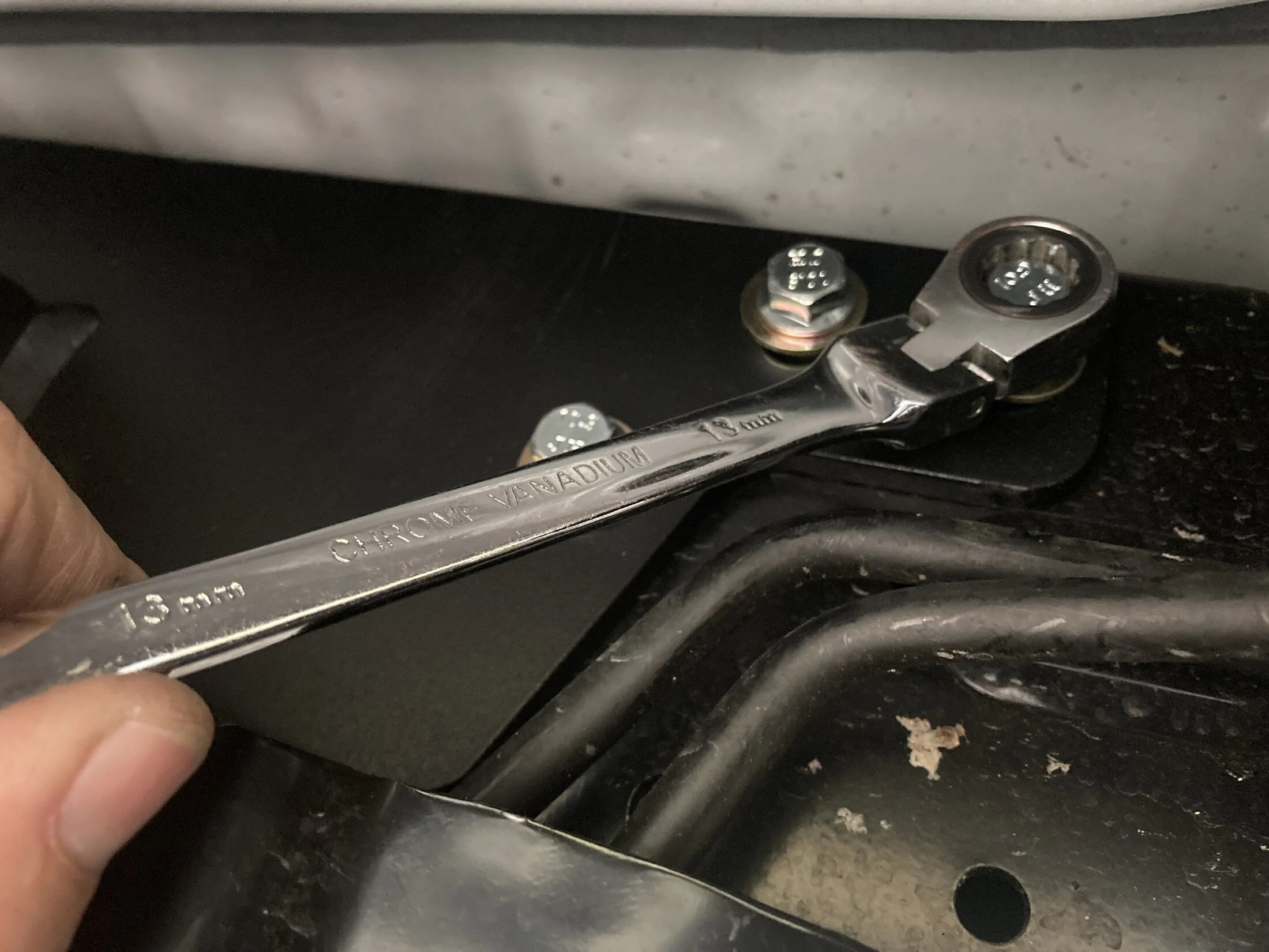

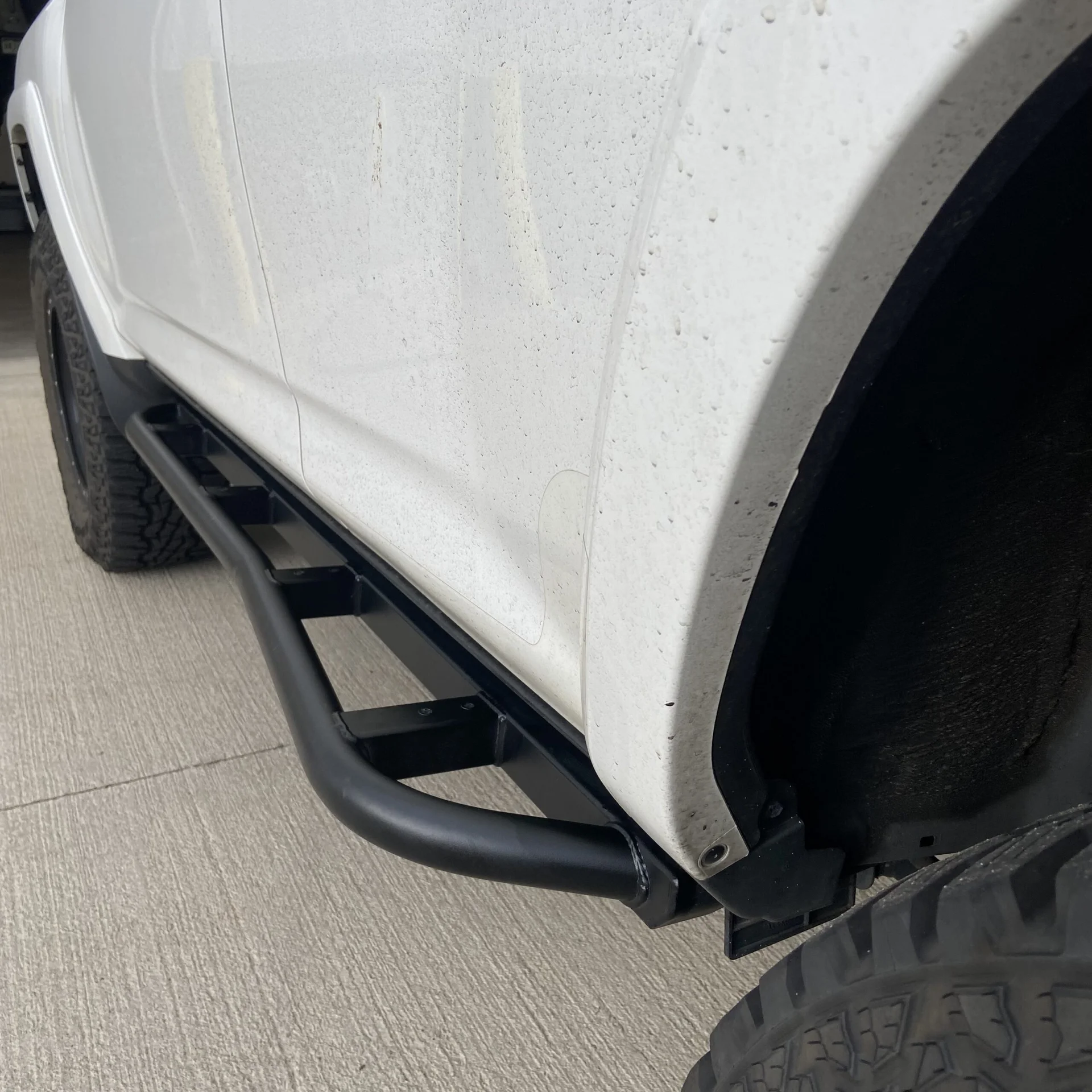

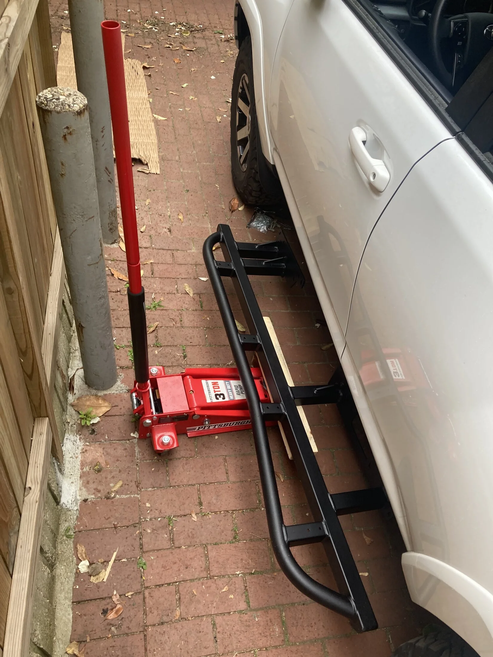

Got the RCI rock sliders installed today. It was not very difficult but took a few hours. Pulling back the hydraulic KDSS lines was the trickiest part. You have to disconnect the KDSS line brackets from the frame and use a flathead to hold them away from the frame to slide the slider plate up under the KDSS lines. Also, remember to find any plastic frame plugs that Toyota may have put on the frame rails- pop them out with a flathead before lining up the sliders to the frame. Two more tricks I learned from Bud Built's slider install video for the 200 LC on YouTube are: 1) balance the slider on a ~24" piece of 2x4 on top of a floor jack 2) make sure to have flex head ratcheting wrenches on hand in 12MM and 13MM- this will make the job much easier.
The sliders look great- and they're stout (2″ square main tube, 1.75″ DOM outer rails, 1/4″ gussets on all legs). These are the 5 degrees sliders. I plan on keeping them without a top plate, but also I ordered top plates in case my wife, mother, kids or dog end up needing a more solid surface. A nice thing about the RCI rock sliders is that the top plate can easily be installed or removed at anytime with a few bolts without removing the sliders from the truck. Luckily my 3 year old son tried them out without the top plate and had no trouble getting in and out of the backseat. Couldn't be happier with a slider and the price was great with the RCI tax season sale (15% off plus an extra 10% off). And with the RCI skid plate, I've got a nice matching set.
This concludes the build for Easter Bunny II. I'll post up some action shots when we hit the trails...

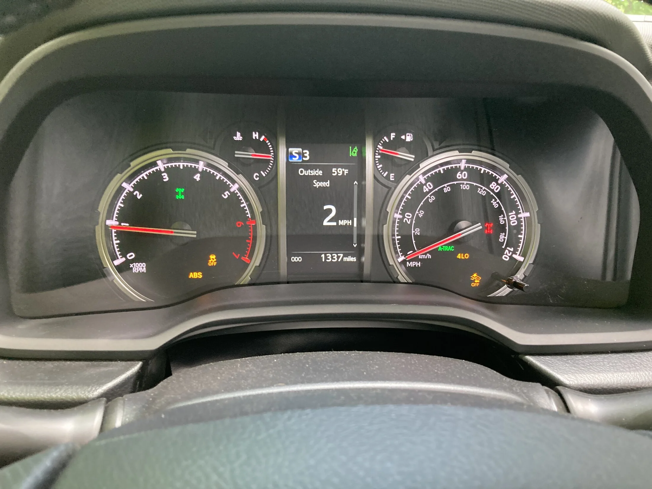

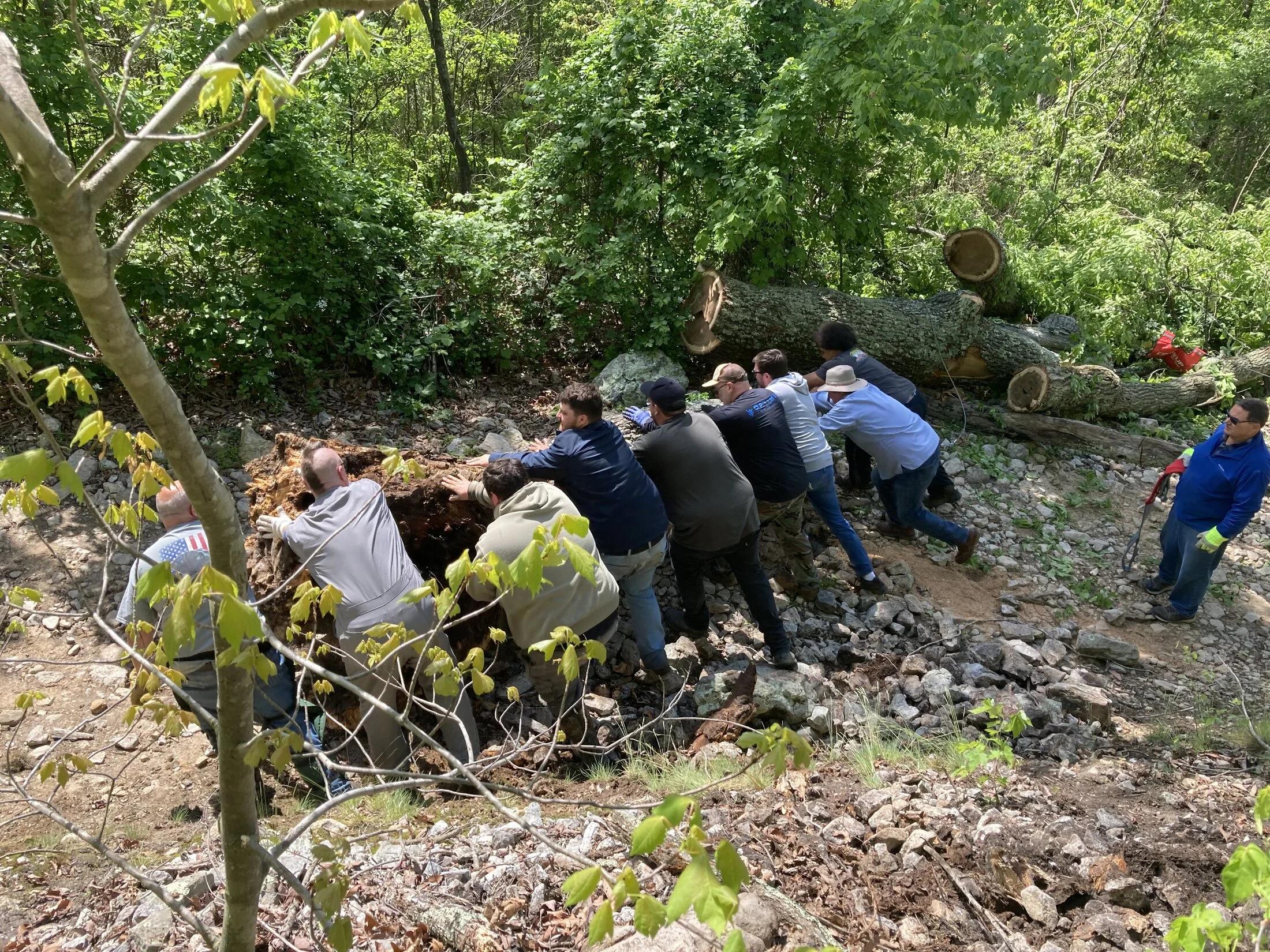

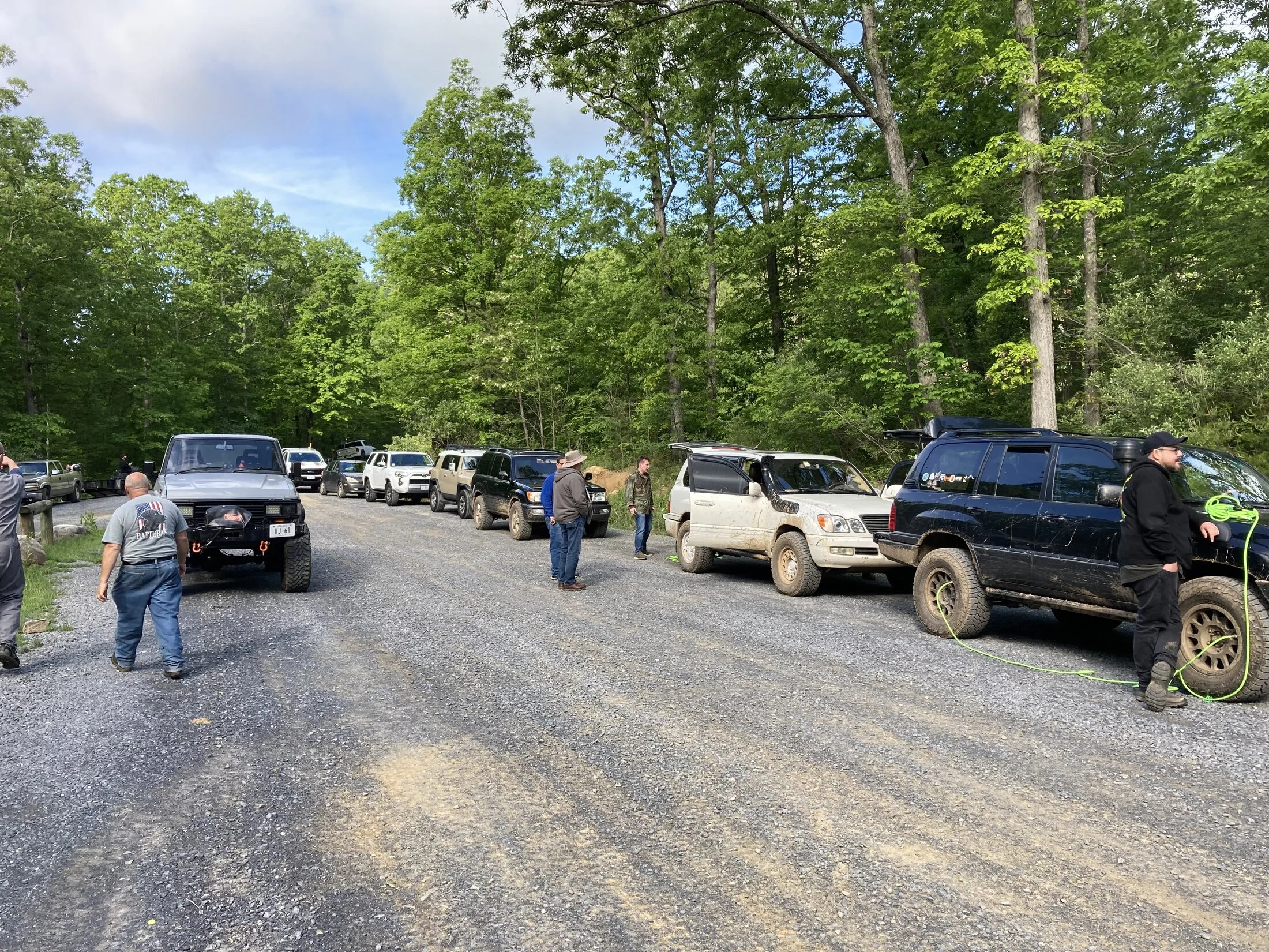

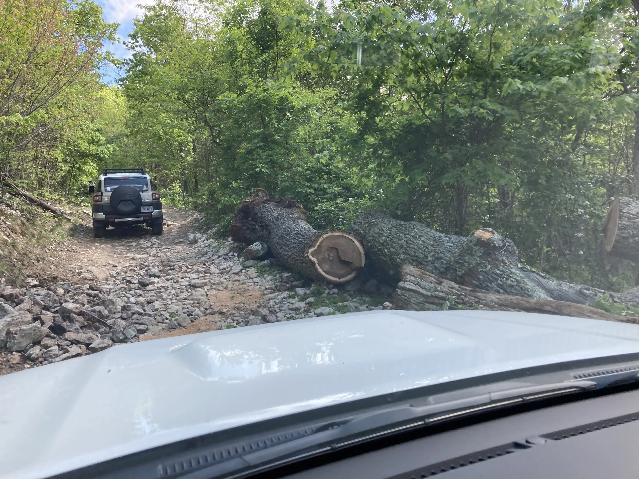

Hit 1,500 miles on the odometer in Virginia this weekend on the way back from a trail cleanup with the local TLCA chapter. Truck did well on the trails and the RCI engine skid earned its keep not once but twice.
Looking nice and stout parked outside my buddy's place this weekend...
