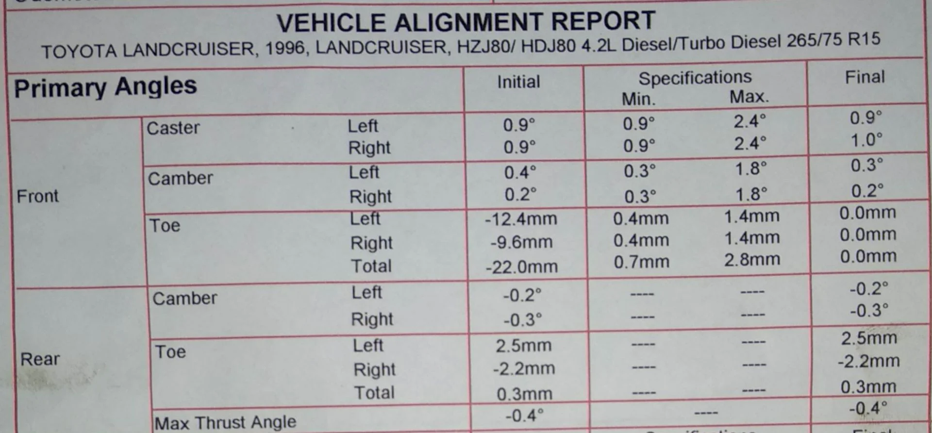

How much caster is everybody running? I'm just playing around with my adjustable caster plates to see how it changes the steering and handling at different settings. Any pros/cons of going less or more than factory specs? I had a go at driving with 0.9 degrees and steering was really nice and light but it no longer returns to center very well. Might give around 3 degrees a test drive too before setting it somewhere in the middle. Interesting to feel how it changes the driving style

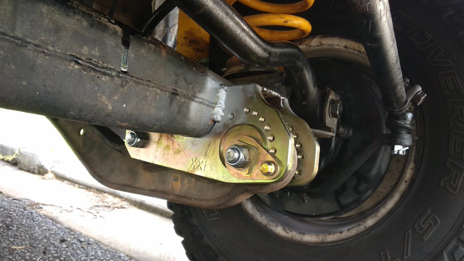

What kind of caster kit are you using that's adjustable? Most caster products are an "install it, and that's what you get." sort of product.
I'm using an old XXI caster plate kit, I don't think they make them anymore.

That is cool, I've never seen one of those! :cool:

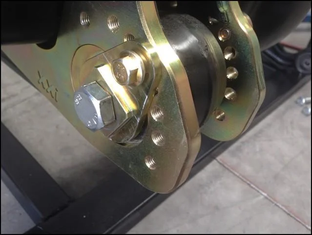

Ok so just tried a few positions but it's now in the highest position available, which I think I'll leave it at, and it feels great. Steering is much more direct albeit a tad bit heavier. I was at 1 degree in position 2 so I should be about 3.5 now in position 7 as the manual says it moves 0.5 degrees each position. Only thing I haven't tested yet is high speed turns and tracking, it's wet here today so might wait till it dries first.
KiwiDingo FYI mine is in hole 7, second last hole, and from hub center to flair 550-560mm
Mine only has 7 positions, that's weird?
Edit - never mind, there's another hole further around before position 1 but that's only there for installation and can't be used for caster correction, I think you were counting that one as well?
