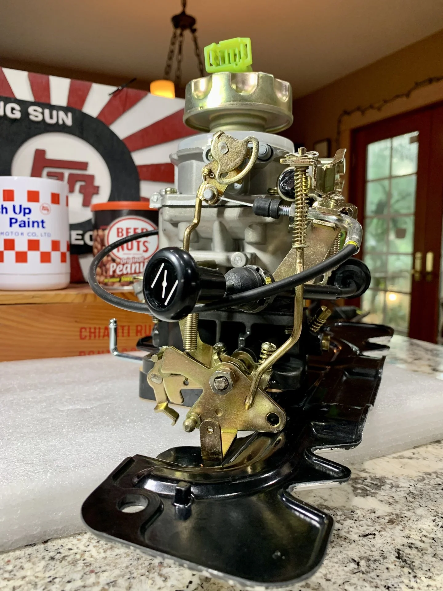

This one…. If you have no real smog requirements.

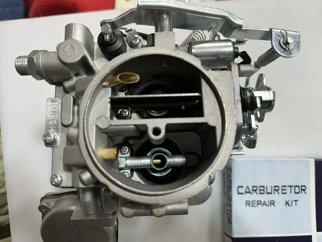

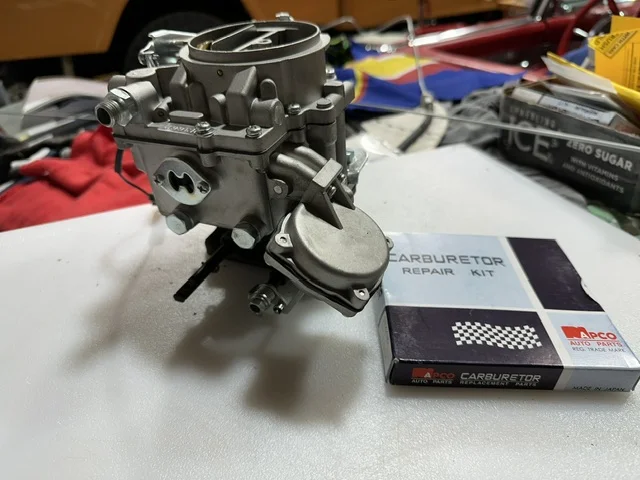

Had to try this…. Bought the $80 carb…installed it and the truck started and idled well. The transition from idle to anything else was a catastrophe. Tried several adjustments and it improved slightly. Pulled it off and put back the old carb after a rebuild and cleaning. Ran as if it was never removed.. going to dissect the Chinese carb and see where the oddities are.

From a visual standpoint, it looked great and sprayed fuel. I was surprised it idled well too. Pressing the accelerator was just sputtering, coughing and then stalled. it’s as if the accelerator pump had no fuel. I’ll post a few photos when I pull it apart. I actually bought two of the carb rebuild kits. Used one for the original carb already .

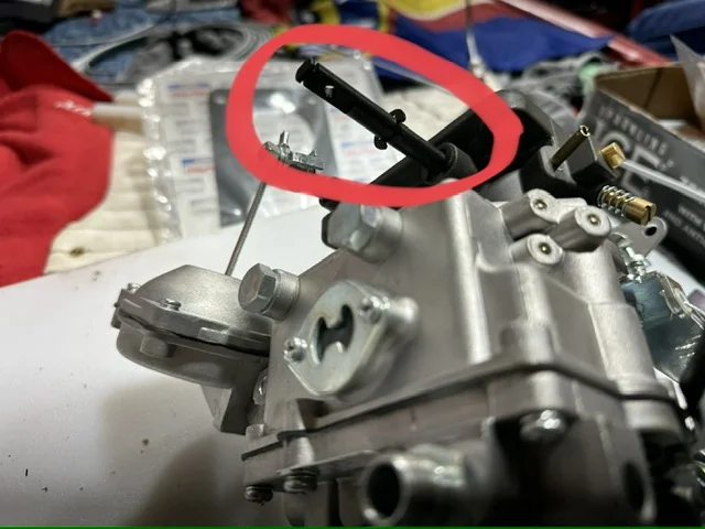

My dumb question of the day is: can someone tell me what is the purpose of the elongated butterfly shaft?
That shaft is for the ac kick up/ idle up. If you don’t have ac it’s unnecessary and on a 40, I cut it off or it interferes with the vacuum port in the carb spacer. 60 series port is a little different and works fine with it.
Cruise control, it gets stuck on the vacuum line off the carb insulator and holds the throttle open for a pretty steady 45 mph.
You'll probably want to make sure, if there's a clamp on that hose, to make sure the screw isn't on the top.
(or just cut it off)

I'm no carb expert, but it almost sounds like your main jet may be clogged. If it idles fine then your idle circuit is working as it should, but when you crack the throttle valve open by hand or by pushing on the accelerator pedal it pulls in alot more air which in turn needs more fuel to run.
If you start the engine and have it idling you should be able to look down the carb (no air filter housing installed) and hear it sucking away, but you shouldn't see any fuel. Then manually give it some throttle and watch and see if you get a stream of fuel coming from the main jet. If not, then that may be your issue. Run a fine wire thru the jet from the fuel bowl side, spray copious amounts of carb cleaner thru the it and then use compressed air to really blow any obstructions out. You can do all of that without even take the card off the manifold. Put the top back on and try again.

Actually, the main jet port is spraying fuel…possibly not enough so I am going to peek inside anyway. I will try your wire technique and re-install but some of the stories i have read about the assembly of this carb almost wants me to pull it apart and inspect the parts and pieces. I am going to cut that excess shaft off.
