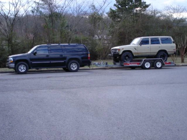

Here is what I do, until I can buy a trailer. This is the galvanized trailer....its not the older model " red metal trailer" this is not as good.

I use the ratchet straps made for car.. I think mine were from northern tool, but I know various others make all kind of styles, cost. What I use is 4 ratchet straps with 4 axle straps. The uhaul trailer has built in tire straps for the two front tires, but with 33 or larger tires you will not be able to use them. The uhaul trailer also has built in d rings on teh inside edge of the trailer for using your own straps, plus it has two bulit in safety chains. I "x" the straps front and back, One ratchet and one axle strap per each side, then front and rear. I'll post up a pic a little later of the straps.
